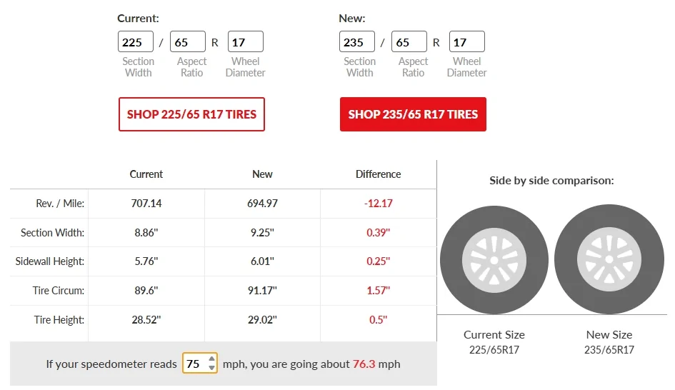

According to the math moving from P225 to P235s, the difference at 75 MPH would be an actual of 76.3 MPH.
It would not effectively result in a full 2MPH over until a 115 MPH speed (old P225 tires) with an actual 117 MPH with new P235 tires.
Showing 60 MPH on the speedometer with new P235 would actually only be 61.05 MPH.
Maybe not worth the FORSCAN effort to change.
https://www.discounttire.com/learn/tire-size-calculator?utm_source=bing&utm_medium=cpc&ef_id=d87478786d4810df6cd5115775c15d64:G:s&s_kwcid=AL!9488!10!77309561777380!!!!77309617160387!!376247710!1236950777141675&utm_source=bing&utm_medium=cpc&utm_campaign=DT|B|NB-Tires|New|Phrase&utm_content=1236950777141675&utm_term=tire size comparison chart&utm_glid=&kpid=bi_cmp-376247710_adg-1236950777141675_ad-77309561777380_kwd-77309617160387:loc-71297_dev-c_ext-_prd-_sig-d87478786d4810df6cd5115775c15d64

Interesting so the .6" difference is only about a 1/2 mph at 30. My concern is what this does to mpg calculations and the computer. For instance the BCM knows that 225/65 are 2207ish mm circumference, while putting the 235 moves that to 2232mm so about an inch more per revolution. How does that impact the various calculations data points and calculations throughout the system? I see that it is minimal amount, but wouldn't there be a cumulative effect at some point (actual odometer mileage etc.).
