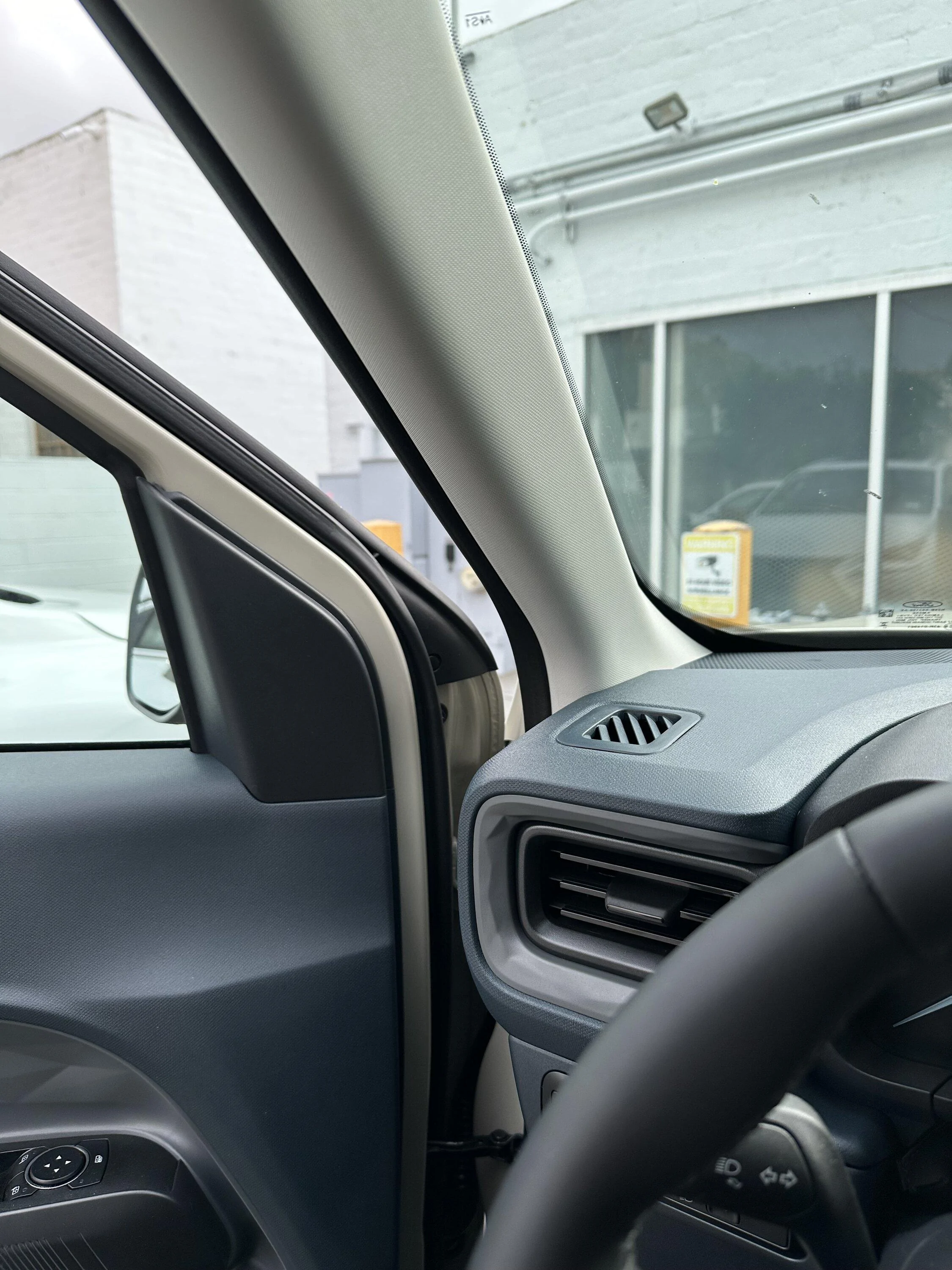

I have a 24 Mav, trying to source replacement door sails in case audio project goes wrong or wanting to revert back to stock. Can anyone help me find part numbers for drivers side and passengers side door sails? (The black triangular trim pieces)

It is fused to the rest of the door plastic.

Hm that’s a bummer. Any ideas on part # for the driver/passenger a pillar trim then?

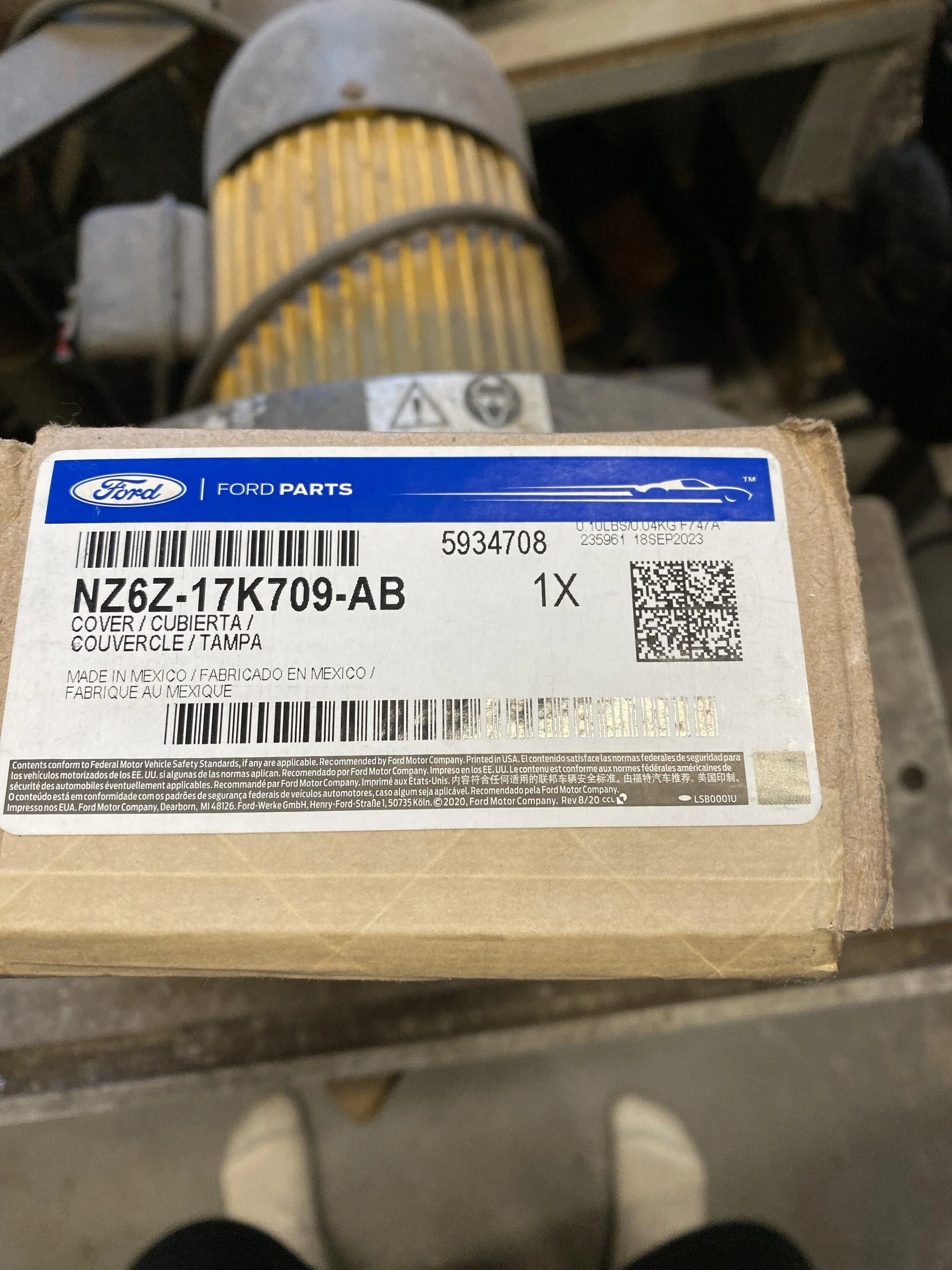

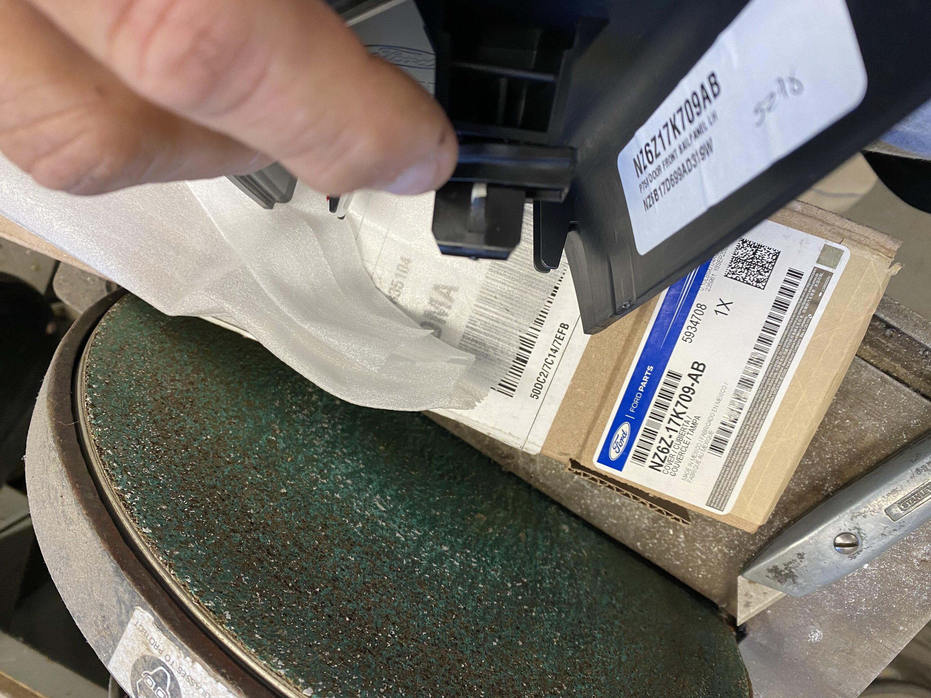

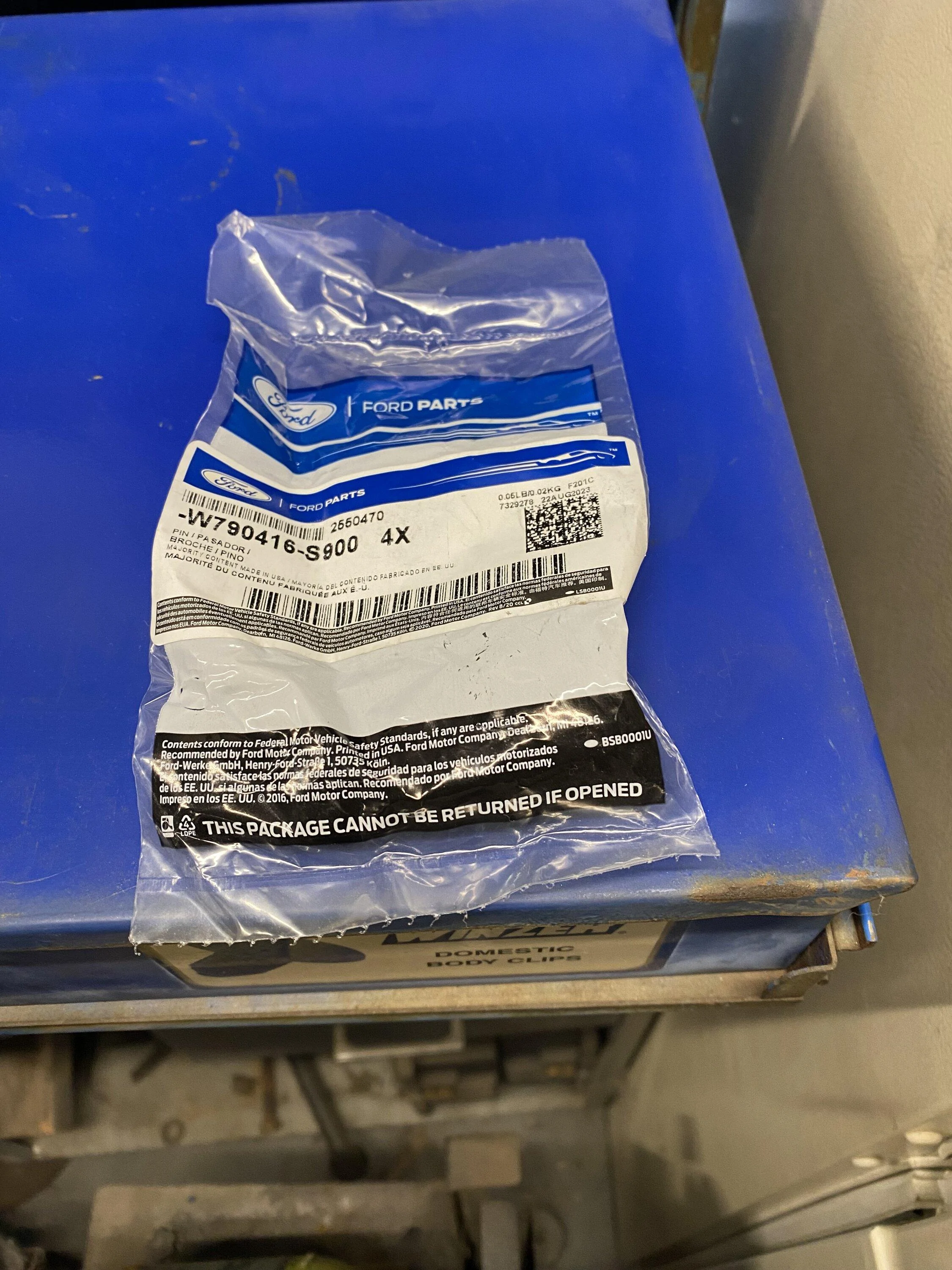

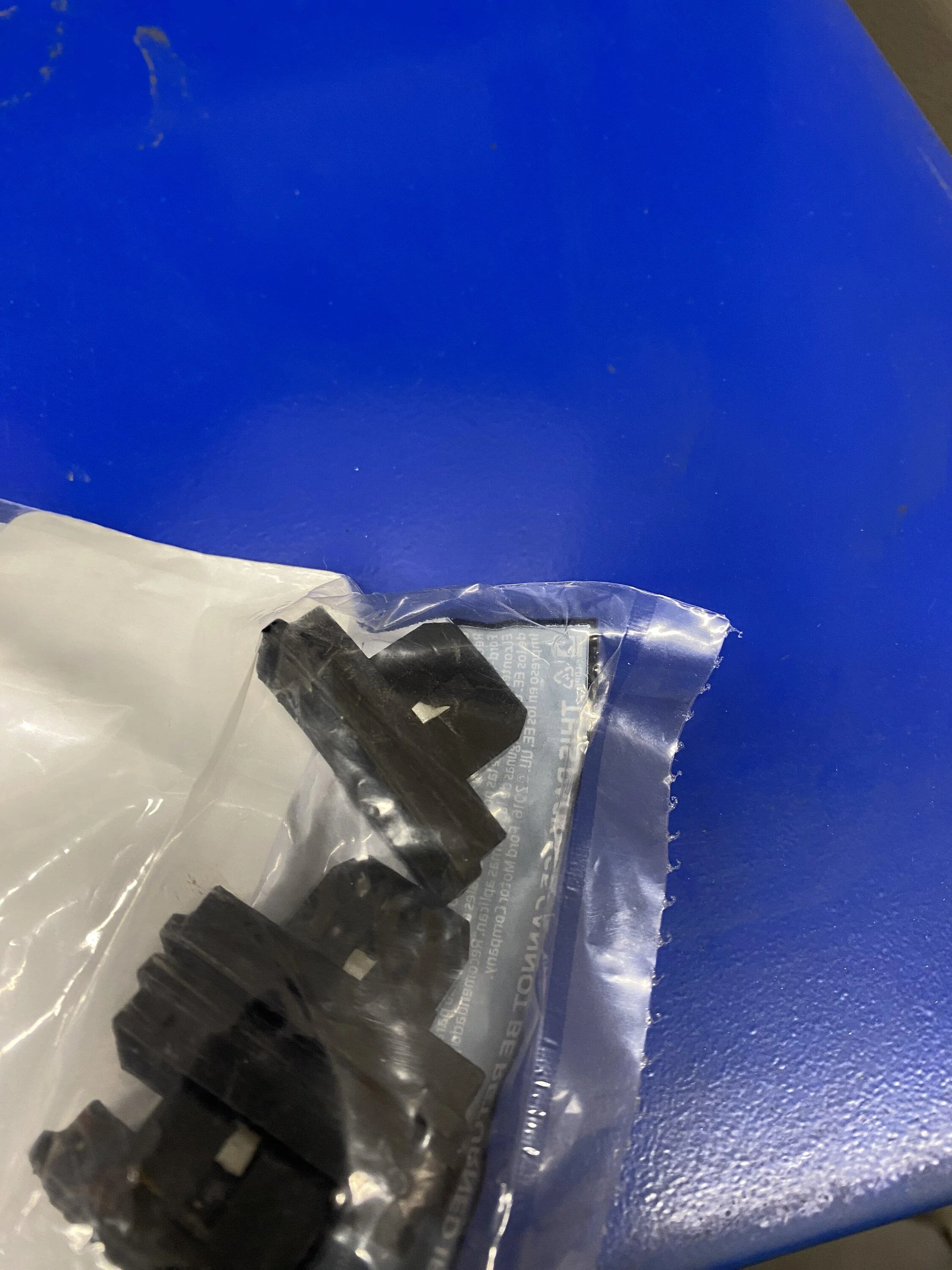

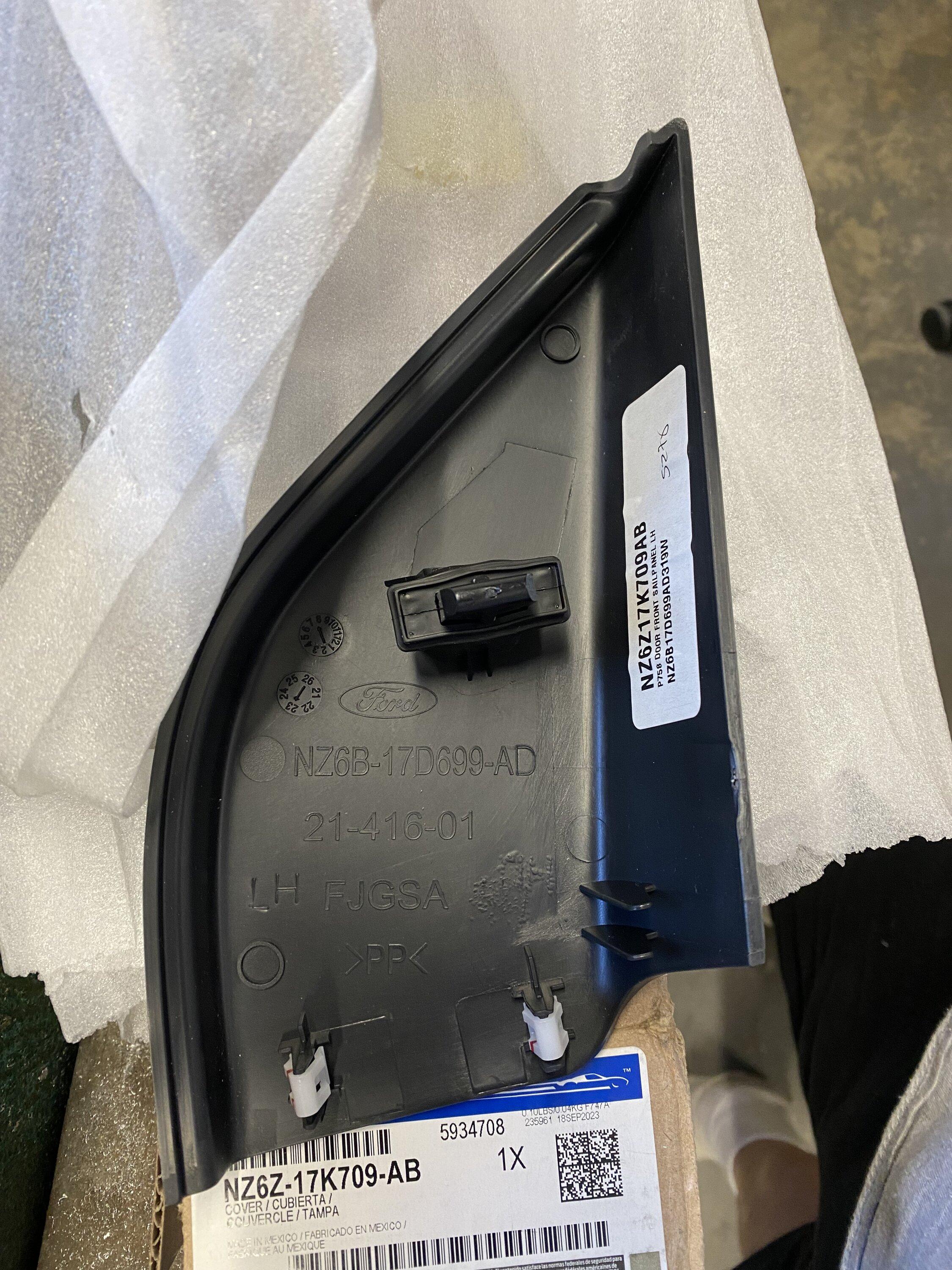

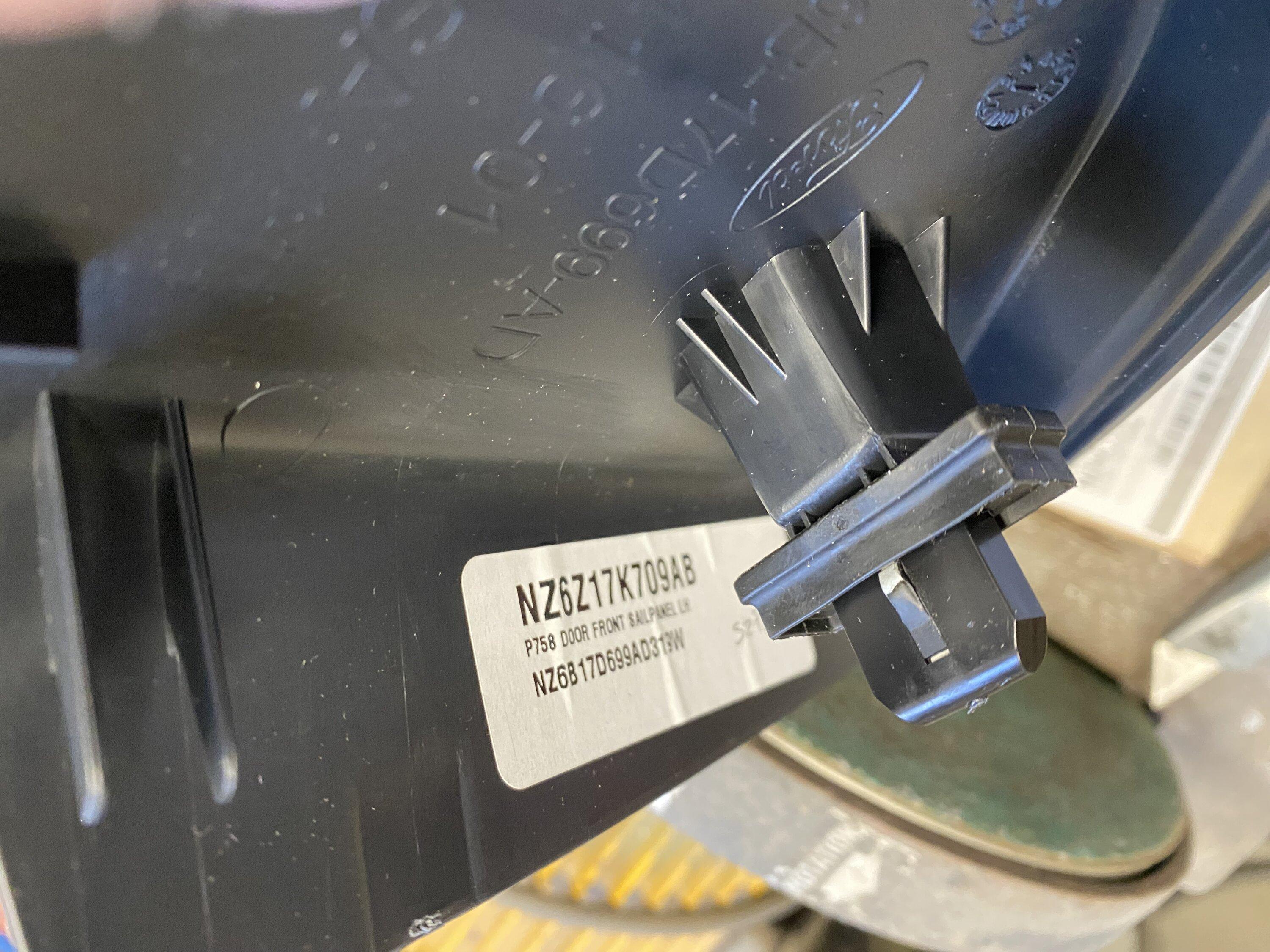

Have one new in box , will post a pic . Be careful as clip pulls out from plastic and stays in door then you have to buy replacement at about 25$ , clip won’t stay on plastic again once pulled off wrong.
it is not fused with lower door panel , just use a good trim removal tool and get behind area I point to in next post.

Here
Ford Maverick Help identify part# door sails IMG_3119
Ford Maverick Help identify part# door sails IMG_3121
Ford Maverick Help identify part# door sails IMG_3123
Ford Maverick Help identify part# door sails IMG_3122
Ford Maverick Help identify part# door sails IMG_3124
Ford Maverick Help identify part# door sails IMG_3125
This is drivers side upper panel , part number for passenger similar .
Just use good tool to pull center rubber/ metal clip off with cover at same time or you will need to rebuy clips and/ or cover.otherwise you should be reusable !
Good luck

Pull straight outward with tool help in center

lol I went off the word of the other guy and assumed they were correct so I've already ordered A pillars instead for my project. Should be picking them up this week and will verify the part #'s for those for future reference.. appreciate you clarifying that they are indeed removable. Didn't make much sense to me that they would be fused.

Funny my driver side one did the exact thing explained in this thread. Now I need new clips and/or new sails. I was exploring for tweeter placement. I realized after the fact that with the warm temp outside and not using a trim tool why it happened. The plastics are very soft to begin with and in warmer weather the plastics become soft butter.
