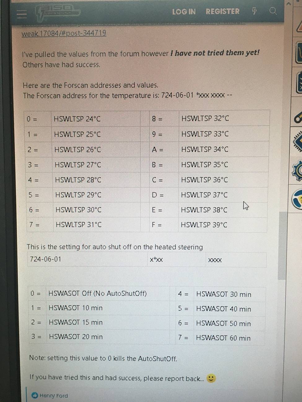

Hey guys. I've searched the forums and can find several posts on this but no solutions. My heated steering wheel times out after about 10 minutes. Switch light stays on but wheel cools down. The only way to get it to heat up again is to shut the truck off for a minute and restart. I've read on other forums that the timeout can be disabled in Forscan but no instructions or valuable info. I haven't had my Maverick long and I don't have Forscan yet. Waiting on the cable from Scamazon. Has anyone dealt with this on here?

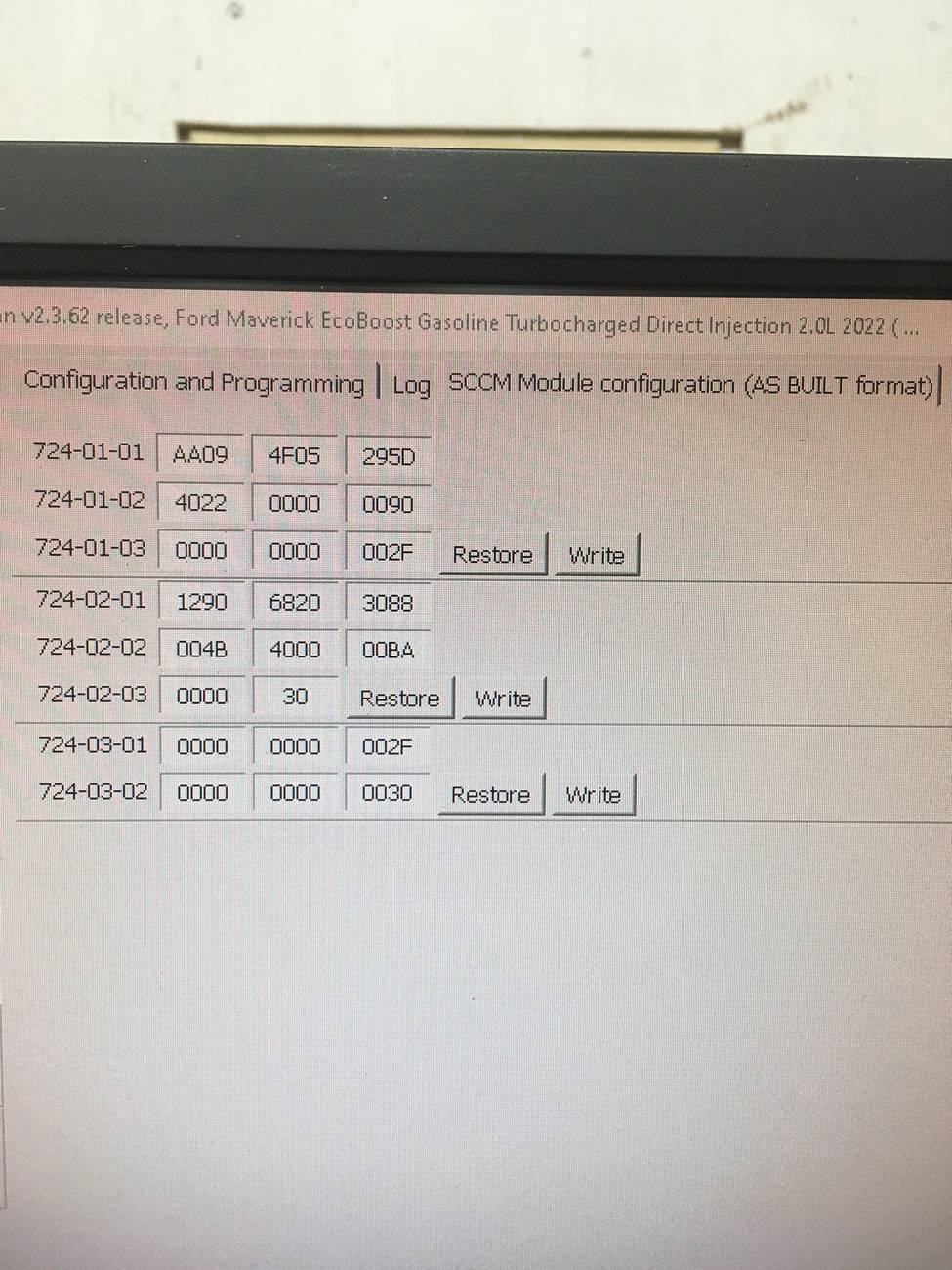

Here is what I found. When comparing the lightning to the Maverick, the Maverick doesn’t have the save as built parameters as the lightning. It seems that they are/possibly the same line that the temperature setting is, but I am not going to experiment with different settings to find out.
Thank you!
this is the answer.
I don't know what mine defaults to, but it's enough for me. however, my wife did mention last year that she didn't want it to turn off automatically, so I'll have to get out my laptop and obd2 cable and get that done. (y)

Anyone figure out the timing parameters?
