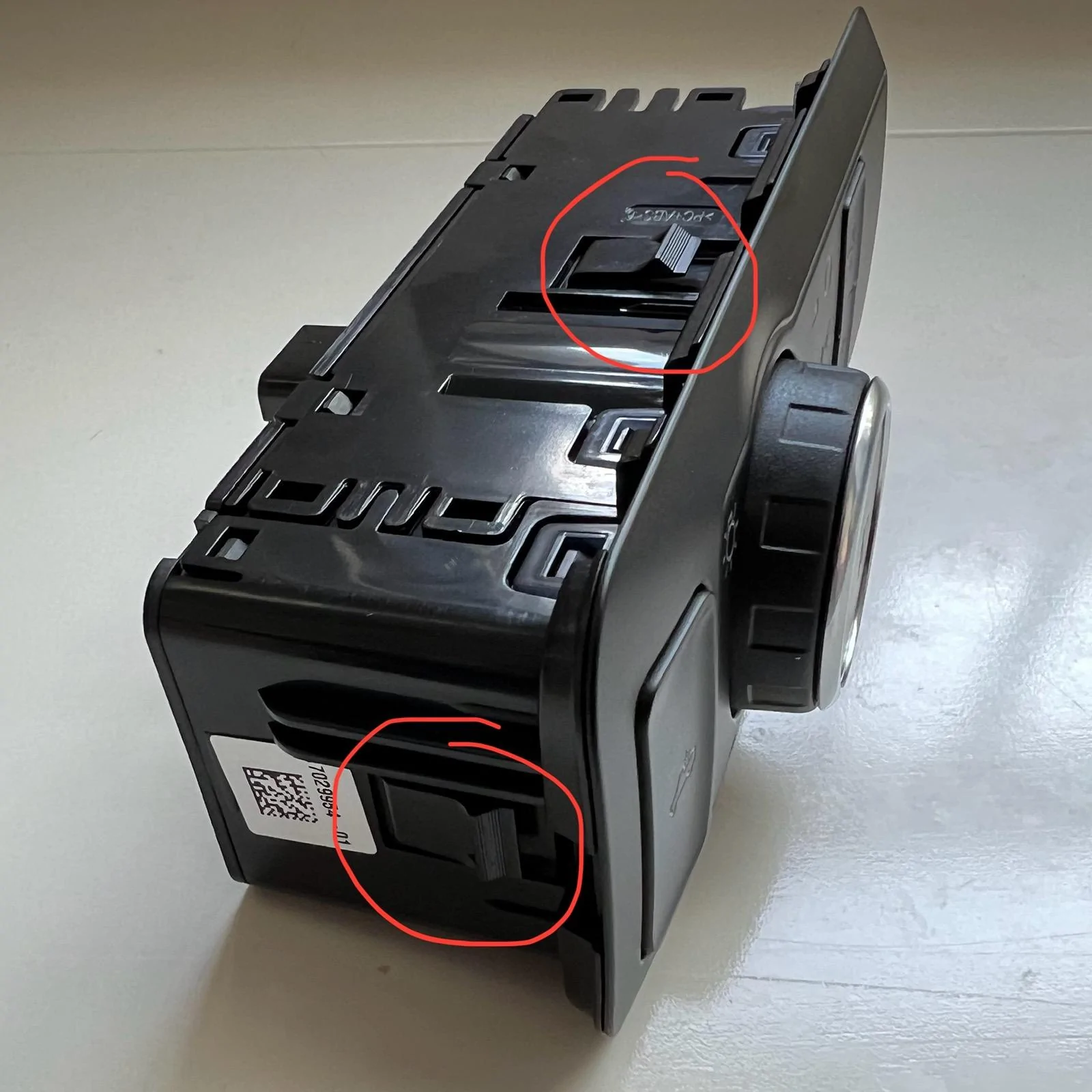

I haven’t done it yet, but I have my new F-150 switch ready. Here is a pic. There is a tab (circled) on all four sides. I am guessing a trim tool (along with tape on the dash panel) is the way to get the current switch out…
Ford Maverick headlight cluster removal / DD fog light install IMG_4762
