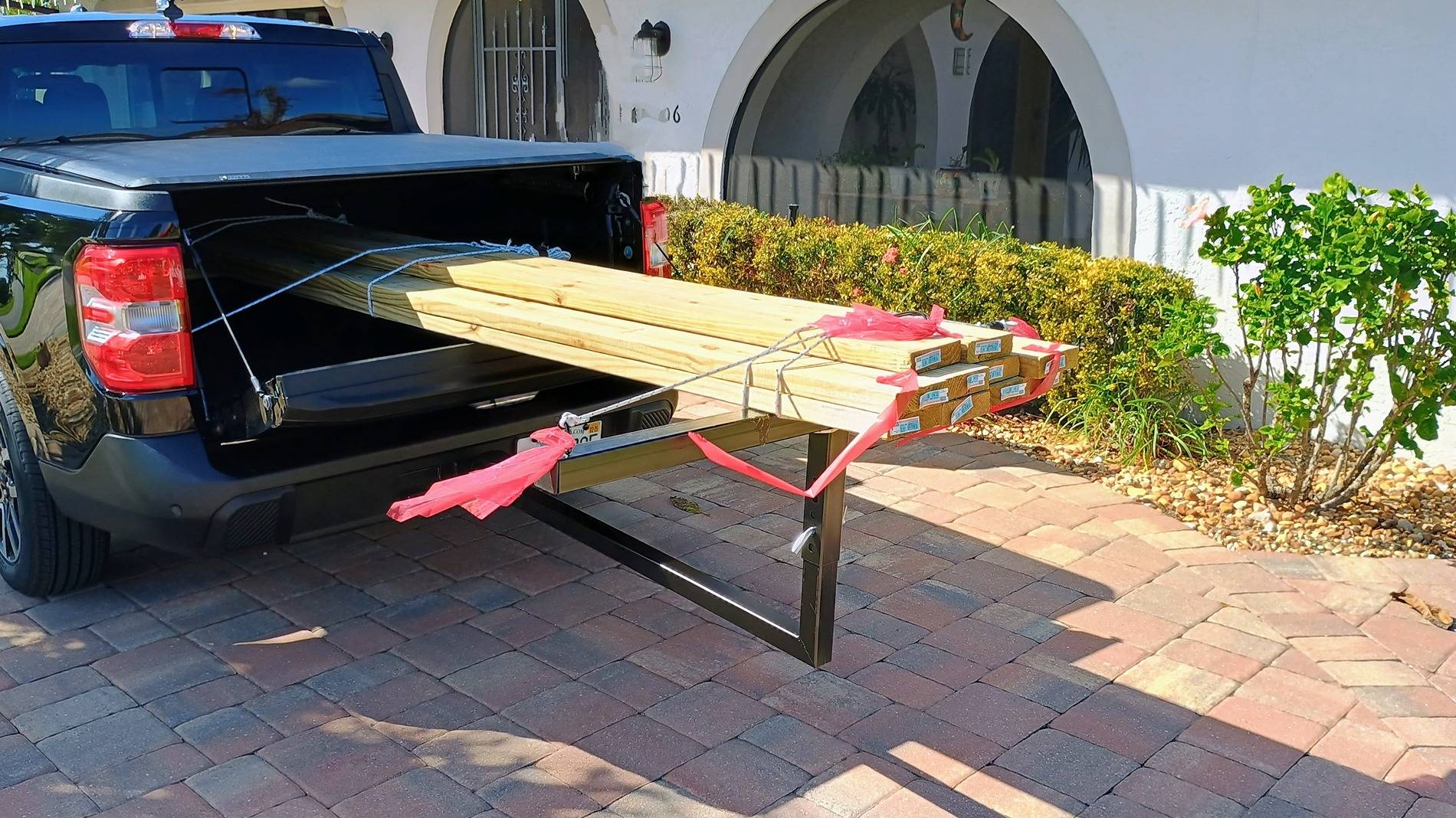

I have to truck some 10' long aluminum fascia pieces about 70 miles. I have a long enough support for underneath the pieces plus a hitch extender. Is it better to carry this load flat or should I move the tailgate to 45° ?
How I did it with 10 pieces of 10 ft. long 2x6 lumber and a Harbor Freight hitch extender. I use 1/4" rope and trucker's hitch for strapping down loads. The extender was positioned just high enough that the 2x10s were kissing the tailgate, but not pressing down on it. I had the front end of the boards resting on a horizontal 2x6 laying flat in the slots Ford made for this purpose. I like a little elevation of the load from the tie-downs when cinching things tight. Nice and snug.
