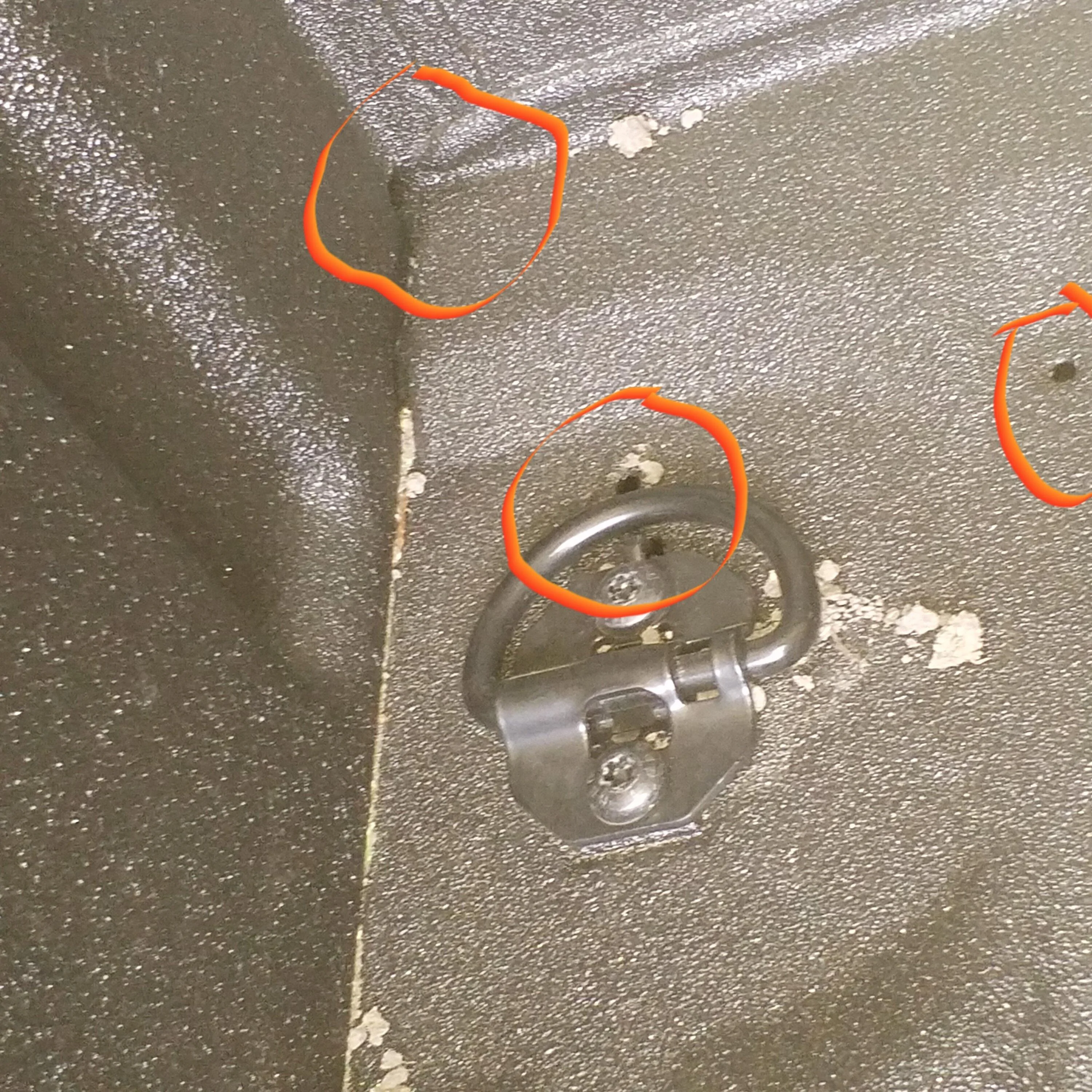

Does anyone have any schematics, pictures or advise as to where I can drill through the DIBL and run my covers drain tubes… I am simply trusting to avoid removing everything to find the drain holes, I’m pretty confident I can cut gently with a hole saw through only the liner if I had some clearer idea where the drain holes are.

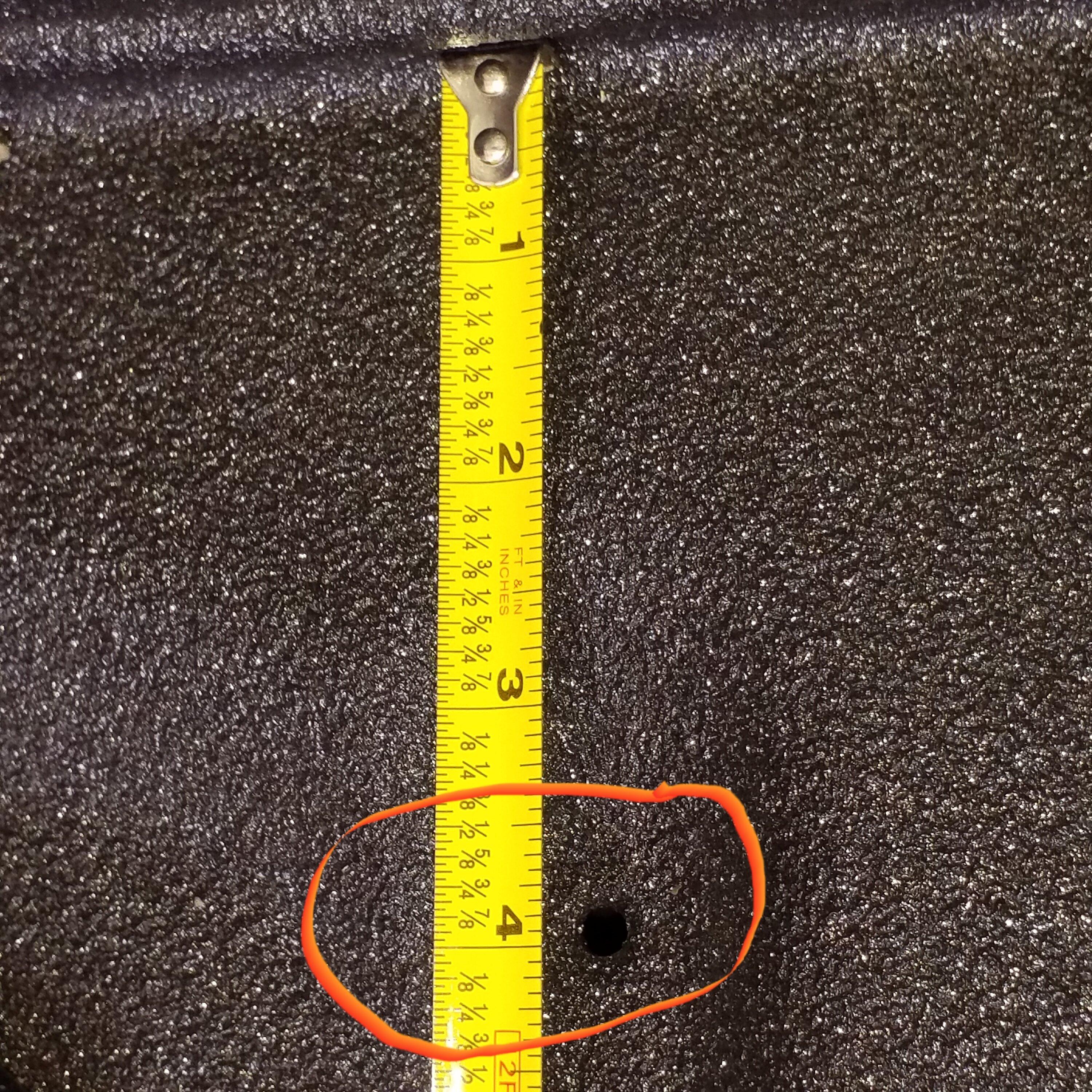

Here are a couple of pictures of my SIBL.
Larger hole in the cornrer, small holes 4" from cab/bed wall.

Thanks a lot! I think I’m going to try for the front corner ones.
