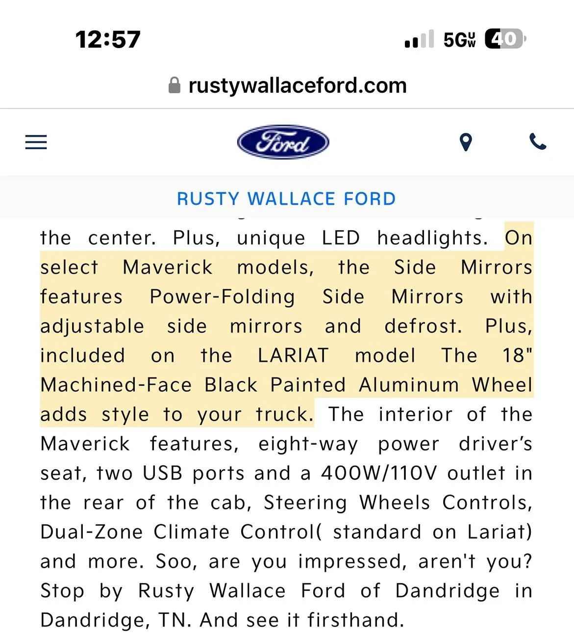

I would be interested in this answer too. My son lives in a home in a downtown area where the garage doors are extremely narrow. There are many cars, live the Maverick, that won't get in the garage without folding the mirrors.
i dont know if this was a typo but I saw this. On the other hand I cant find anyone selling them.
