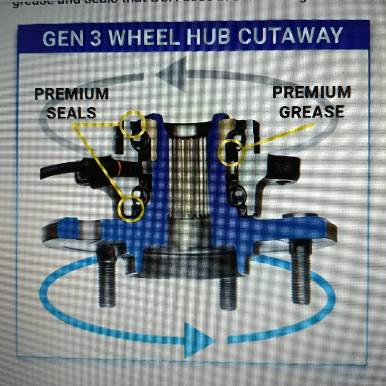

In the F Series the hubs are sealed but only on the outsides! Except there is a gap between the two bearings where the "tone" ring is located. Grease pumped into the hubs thru the ABS Sensor hole will reach the bearings.
Ford Maverick Grease Wheel Hubs??? 20240812_145409

I am guessing Greasing Hubs thru ABS Sensor hole isn't possible. The Hubs on my Fusion do not not have a Sensor hole as the "Tone Ring" and ABS Sensor are external to the Wheel Hub.
