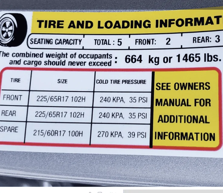

When you go to buy the full size tire, please review the comments on this site as the "full size tire" is NOT the same as the tires that come on the Maverick you order. It is smaller, and there is question whether a "regular" full size tire would be able to fit in the space allotted under the truck. Just a word of caution for you to check this out. Good luck!

Not really sure about all of this, and maybe you should search this site for more accurate information. But, my understanding is the Ecoboost Maverick comes with a "doughnut" type spare. What we thought was an actual 5th tire and wheel is not the same as the other four wheels and tires.
I believe it is in between the two sizes and allows you to drive farther and at a higher rate of speed than what a doughnut would allow. Some people have commented that they were expecting to be able to use the "full size spare tire" in their normal rotation of tires, but obviously, one can't. Please research before buying anything to make sure it will fit underneath the truck. There may even be comments on that as well.

You should go to the Search area on this forum and type in Full Size Spare is smaller than other factory tires and go through the pages. You'll get the answers you are looking for.

My Lariat with Lux came with a donut, despite the initial order guide saying I would get a full-size spare. Then they dropped that from the order guide. Then I found out the full-size spare is not actually a full-size spare.
Just needless B.S. so they could save a few bucks.
Here's the spare wheel I'm using with a 245/65R17 tire.
https://www.discounttire.com/buy-wheels/unique-83/p/56178
To be clear, this is a 17" wheel to match the size of the FX4 wheel.
