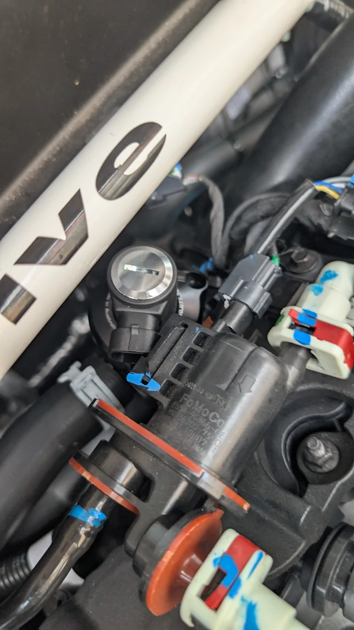

EDIT:
It fits fine, I did not know the top rotated by design. I'm use to PC's and trying to rotate things isn't on my "let me try that first" ideas. Panda was a huge help when it dawned on me to try.
Well got the DV+ from Panda saying it was 2022+ fitment, yeah doesn't fit. Didn't know it sat backwards compared to stock and it faces into what i'm guessing is some sort of air sensor. Going to reach out to Panda hoping for the best.
Ford Maverick GFB DV+ on the 2025 PXL_20250817_210650767

I think there are still a lot of people/companies that aren't aware of how big of a change the 2025 2.0L EB really has undergone. Its an all new engine, I'm skeptical of any [engine] parts 'made for the 22-24' 2.0L EB models..

I take it only bolts in 1 way its not a clock able part. Could u been that bracket forward some to make room

yeah, its an offset mount so it only goes in one way sadly
i figured as much , could the valve bracket be cut or heated and reformed ? im pretty sure its plastic

The damn top twists it seems, I didnt think about doing it because I thought it was solid. It should fit now.

hopefully cause I'm about to order one myself and I'm glad to see you have the strut brace and it doesn't interfere

I was thinking about getting one of these, have you driven it yet and noticed any differences?

No interference at all. Evening unscrewing it was simple. Just was careful not to scratch it was all.
did the head swivel on the blow off valve
, did that fix the issue ?
yep, it twists. i didn not see anywhere on the product page that it does that. But i did not look at the install manual (which i still havent lol) but it probably says there

yep the MAN way , who needs instructions
