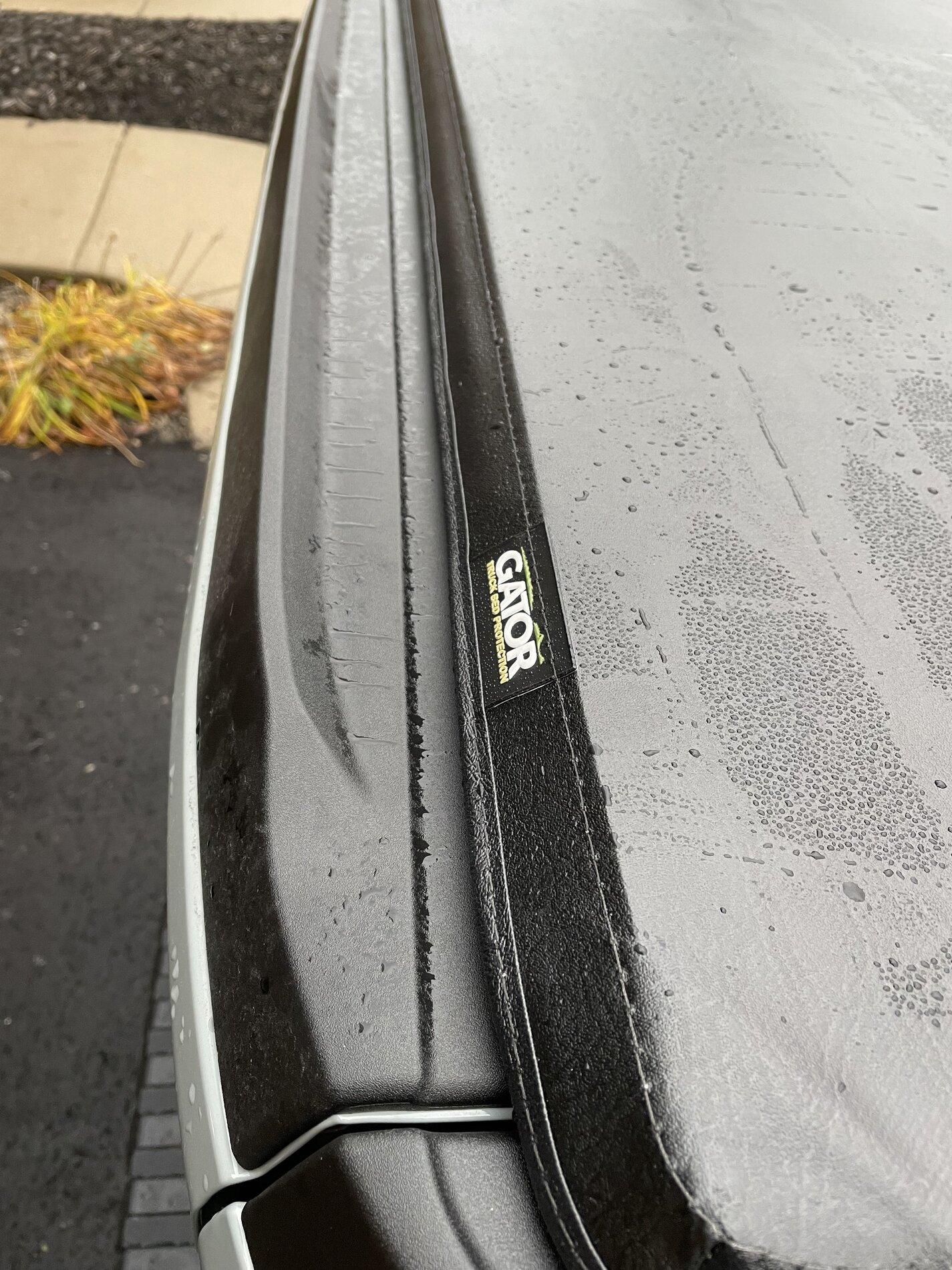

15min after the Fedex van left...

I think so too, it does look great and one can install or remove it in less than 10min, without even getting into the bed.
There are a few negatives tho,
1. There are gaps in the seal, I wouldn't buy this for complete weather protection
2. Did not come with additional seal as advertised on Gator website
3. The metal clamps have sharp edges and corners, can scratch the plastic rail cover
All that said, this is perfect for my needs and I really hope no one will take a knife to it thinking I got valuables under my inexpensive cover in my inexpensive truck. lol

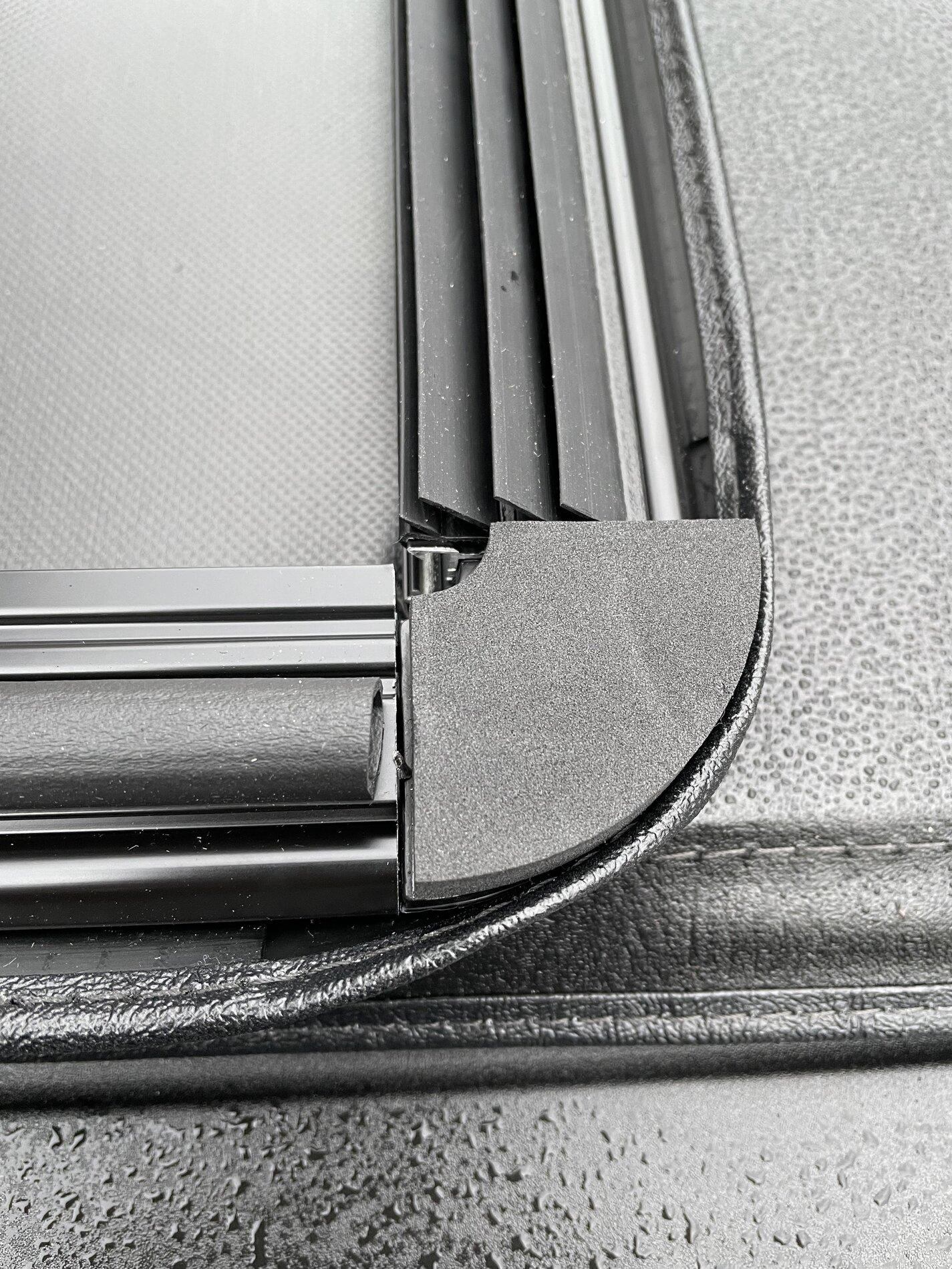

Gap where the edge seal meets (or in this case doesn't meet) the corner seal
Ford Maverick Gator SFX Tri-fold IMG_9285

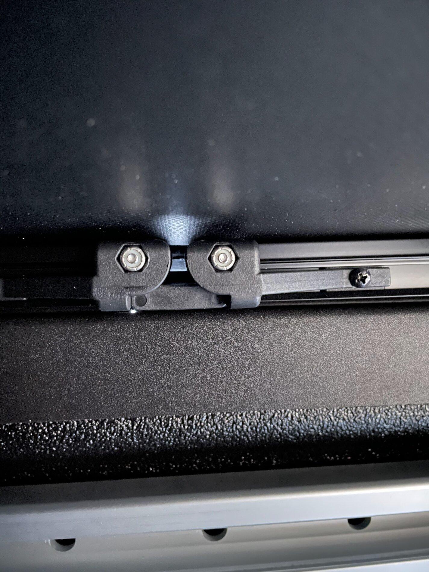

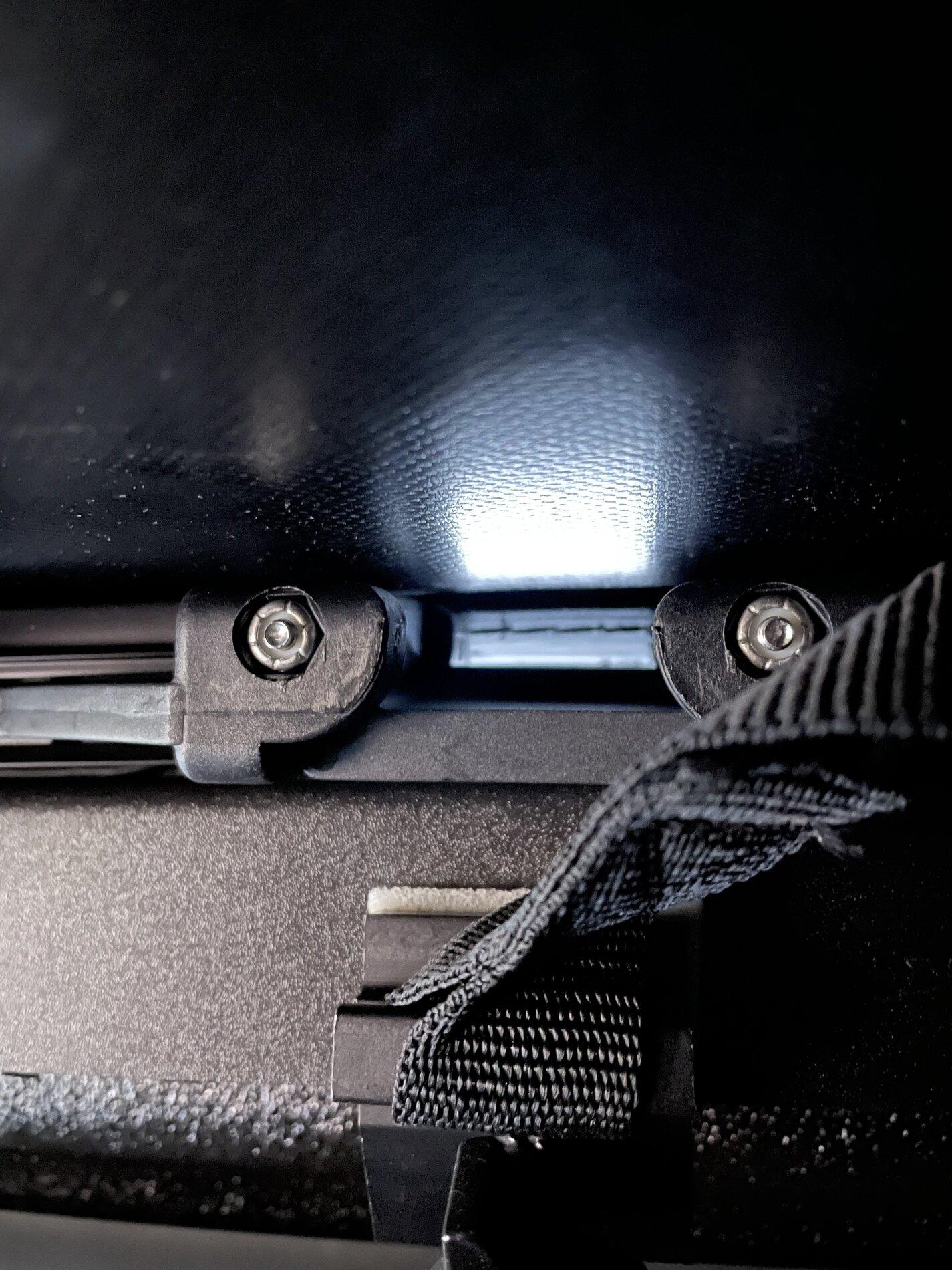

Gap at the hinges
Ford Maverick Gator SFX Tri-fold IMG_9286

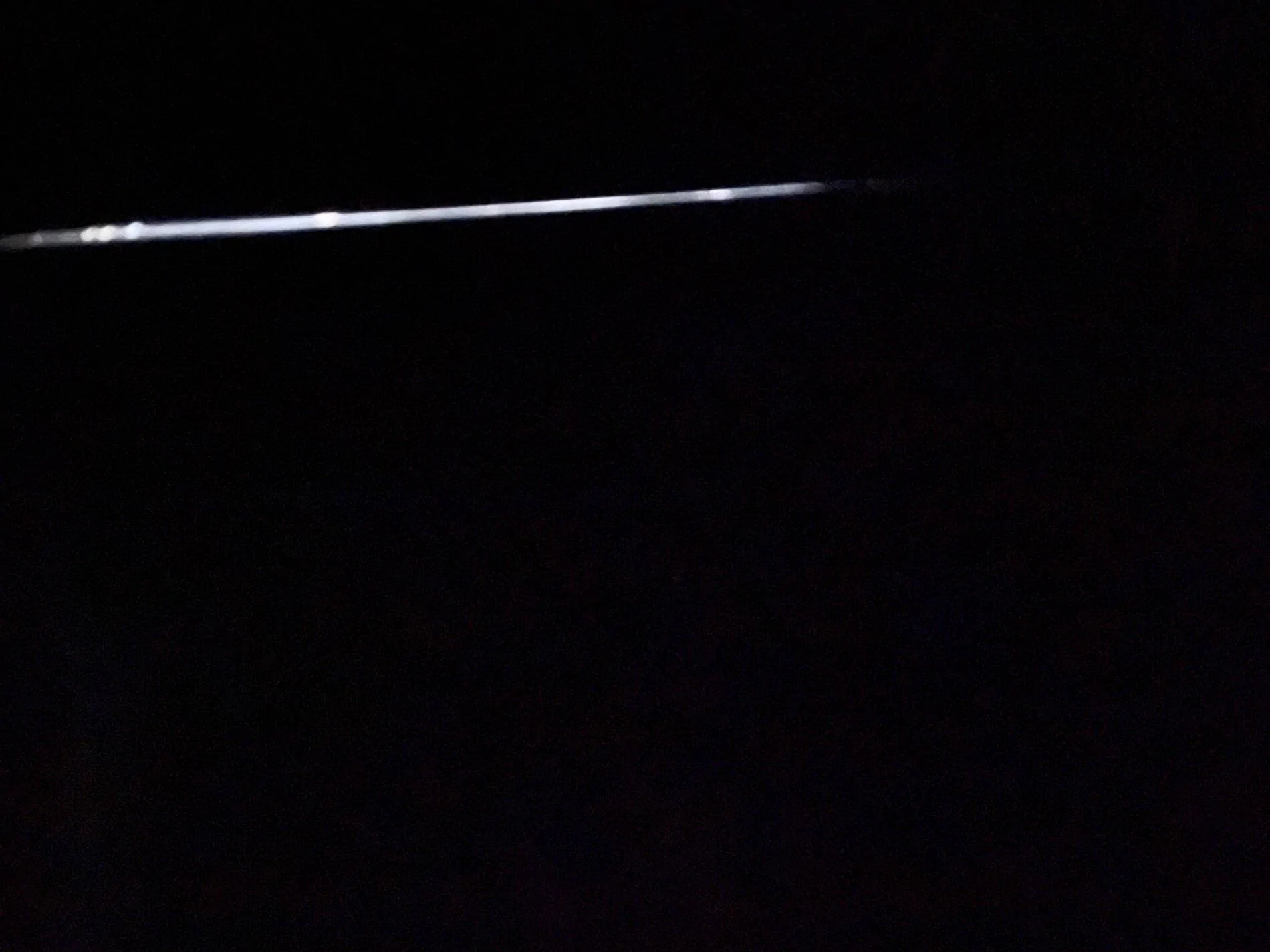

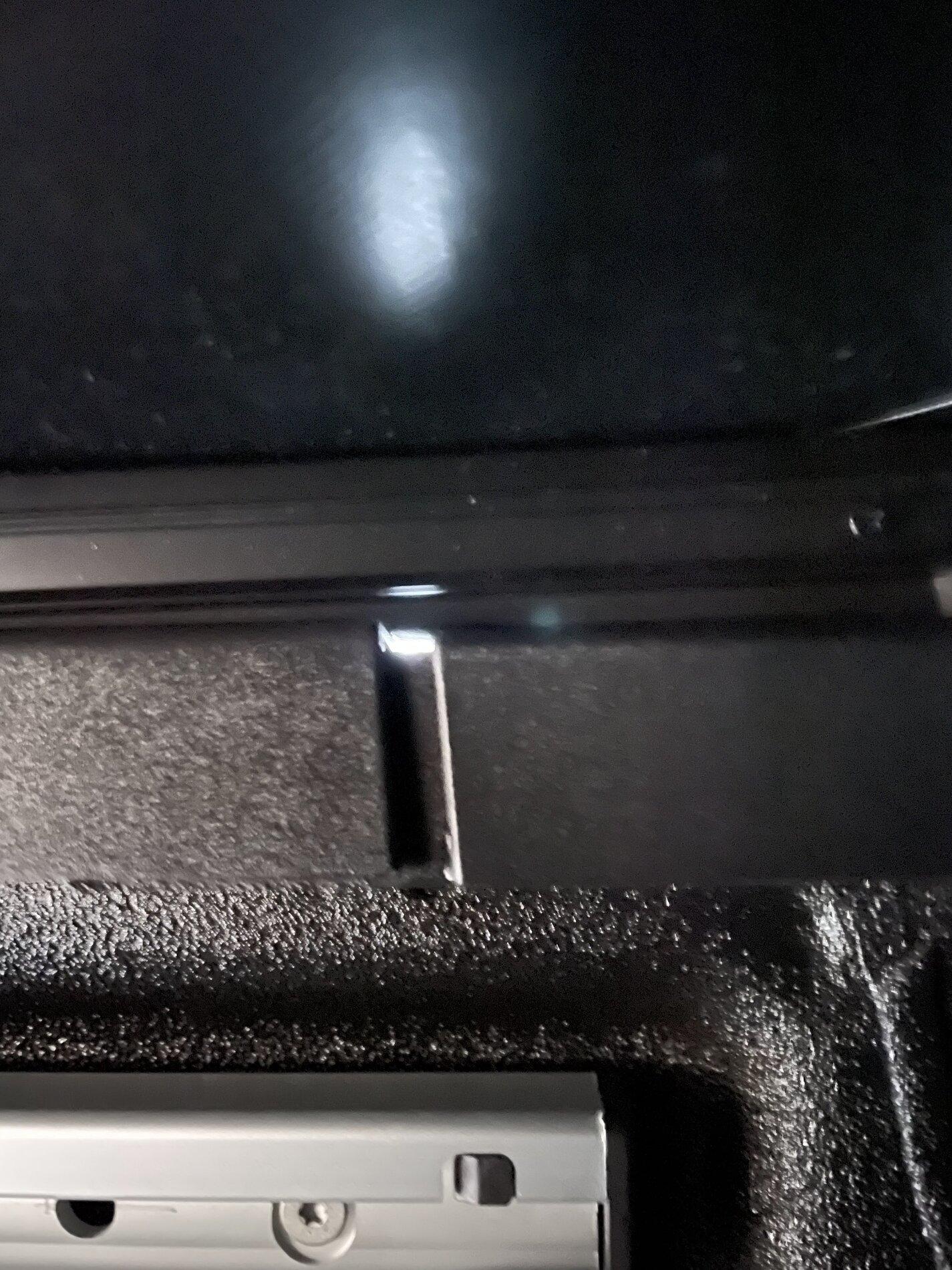

Gap in the truck plastic cover pieces on the sides
Ford Maverick Gator SFX Tri-fold IMG_9287
If light leaks, water might leak...

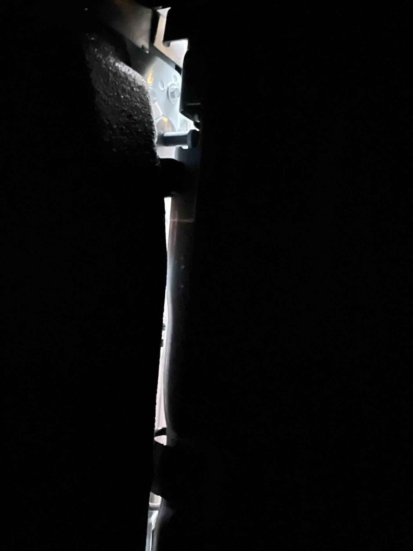

Gap between the plastic covers
Ford Maverick Gator SFX Tri-fold IMG_9290

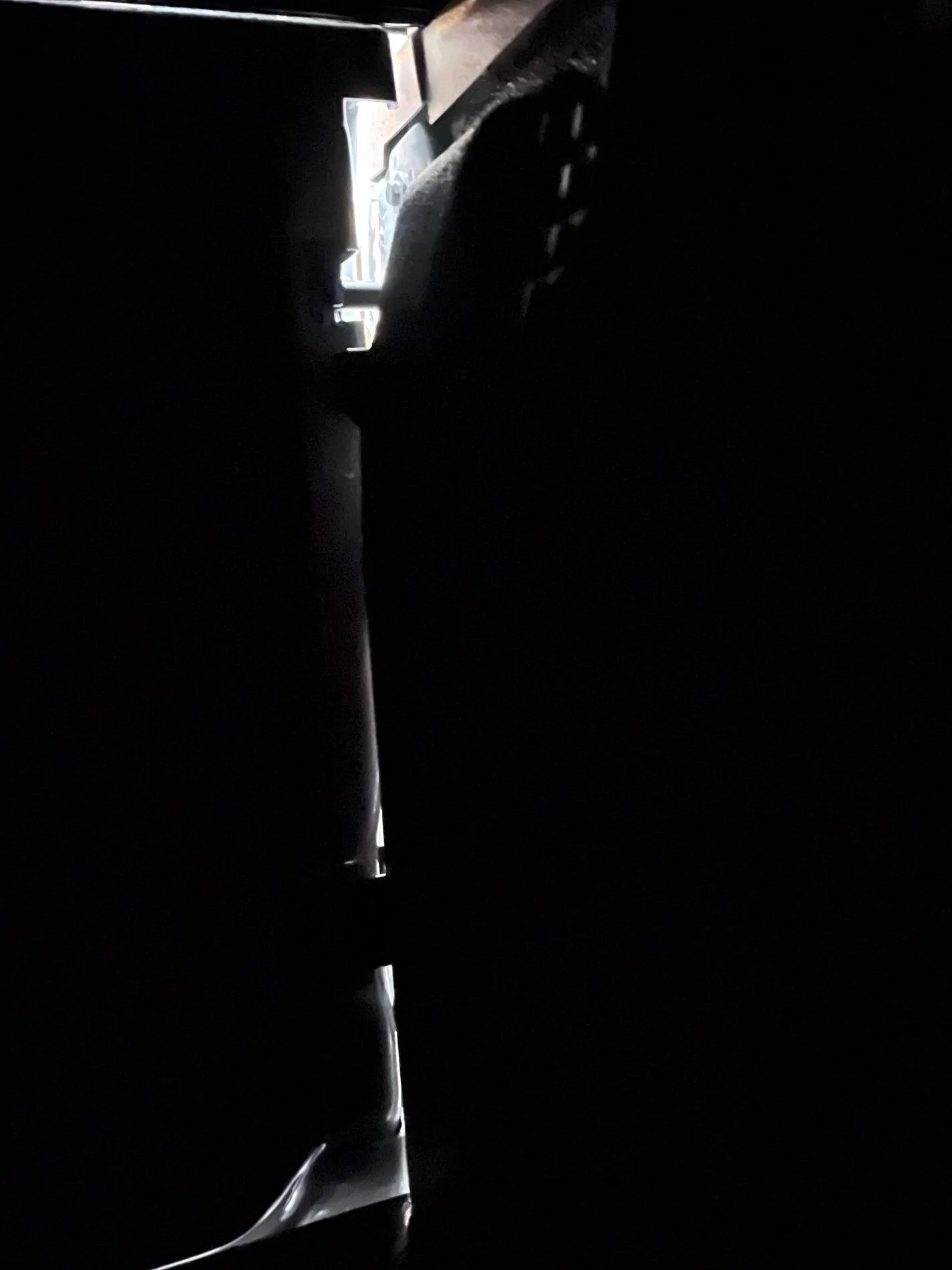

Second fold
Ford Maverick Gator SFX Tri-fold IMG_9291

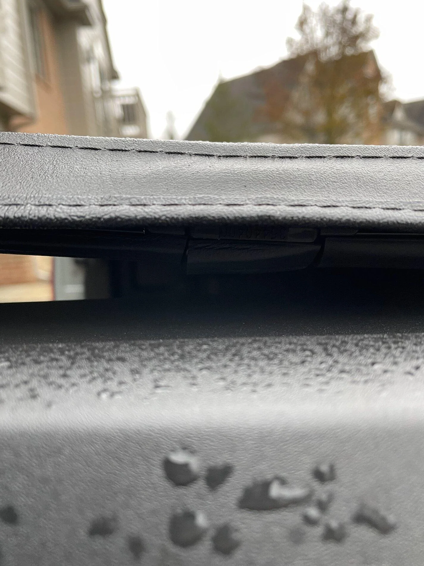

First fold
Ford Maverick Gator SFX Tri-fold IMG_9293

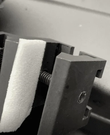

Scratches on the plastic cover from the Al clamp
Ford Maverick Gator SFX Tri-fold IMG_9288
I put some foam tape on the side that is against the plastic
Ford Maverick Gator SFX Tri-fold FoamTa
I want to know your ideas on how to get rid of those scratches. They are on the surface and not deep.
