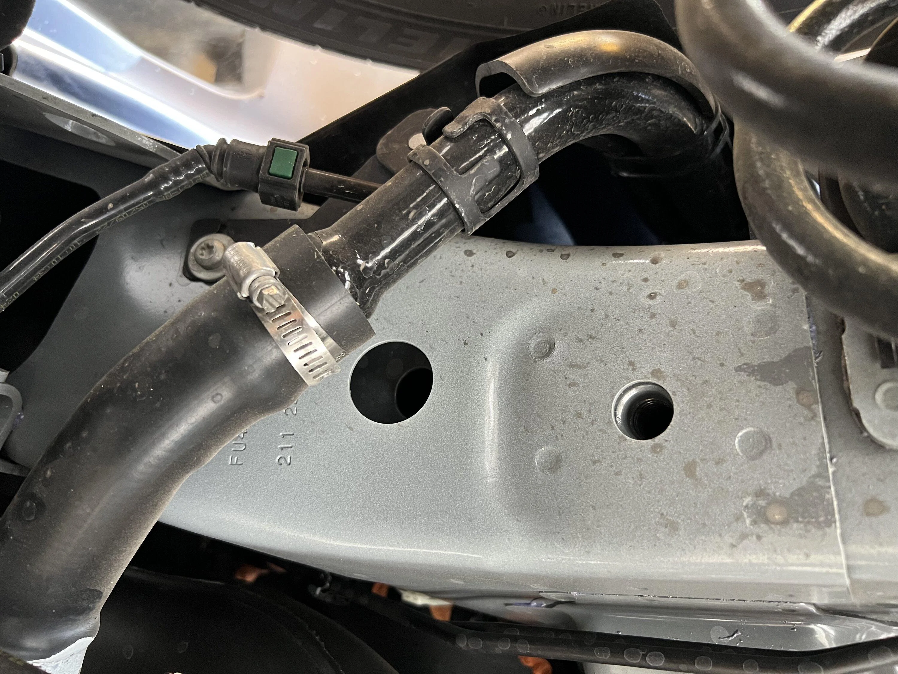

I have a hybrid but just had a fuel leak fixed. I never saw fuel on the garage floor but looked under the truck and saw a small weeping leak from the fuel line to the fuel tank. The part looked like the picture attached. The fuel leaked onto a truck part and that’s why I didn’t see a puddle. The part was back ordered but was eventually replaced and I haven’t had the problem again. This was on a 2024 Lariat.

Thanks for the post, Chippermark. I will check that out. The smell seems to be strongest around the catch can, but it is hard to tell. Time to crawl under and follow the line back.
