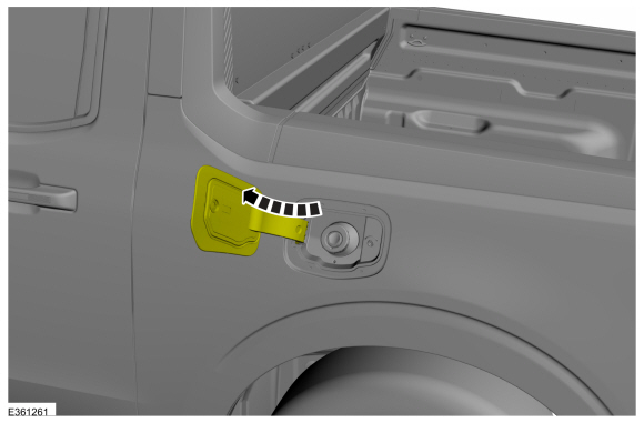

I was looking for the easiest painted piece to take off my MAV so I can color match the paint. I figured the gas door would be the piece, but couldn't figure out how to release it yesterday. I don't see any screws holding the door to the hinge, and the hinge looks plastic and there is no apparent way to unbolt the whole hinge from the truck. I figure someone here has taken off their gas door. Thanks in advance!

  1. Open the fuel filler door.
Ford Maverick Gas Door Removal - How does it come off? {filename}

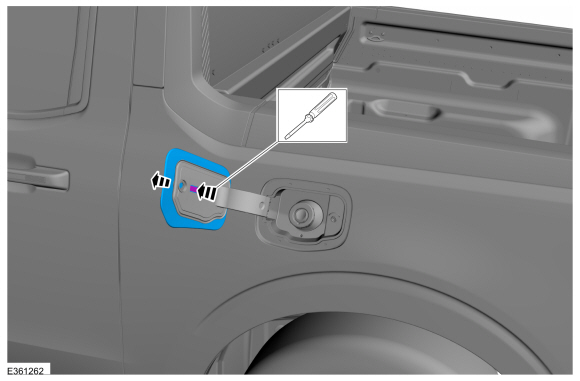

  1. Release the retaining tab and slide the fuel filler door from the fuel filler door hinge.
    Use the General Equipment: Flat Headed Screw Driver
Installation
  1. To install, reverse the removal procedure.

Peel the sticker off you'll see the clip pull back on it and the door will pull forward
