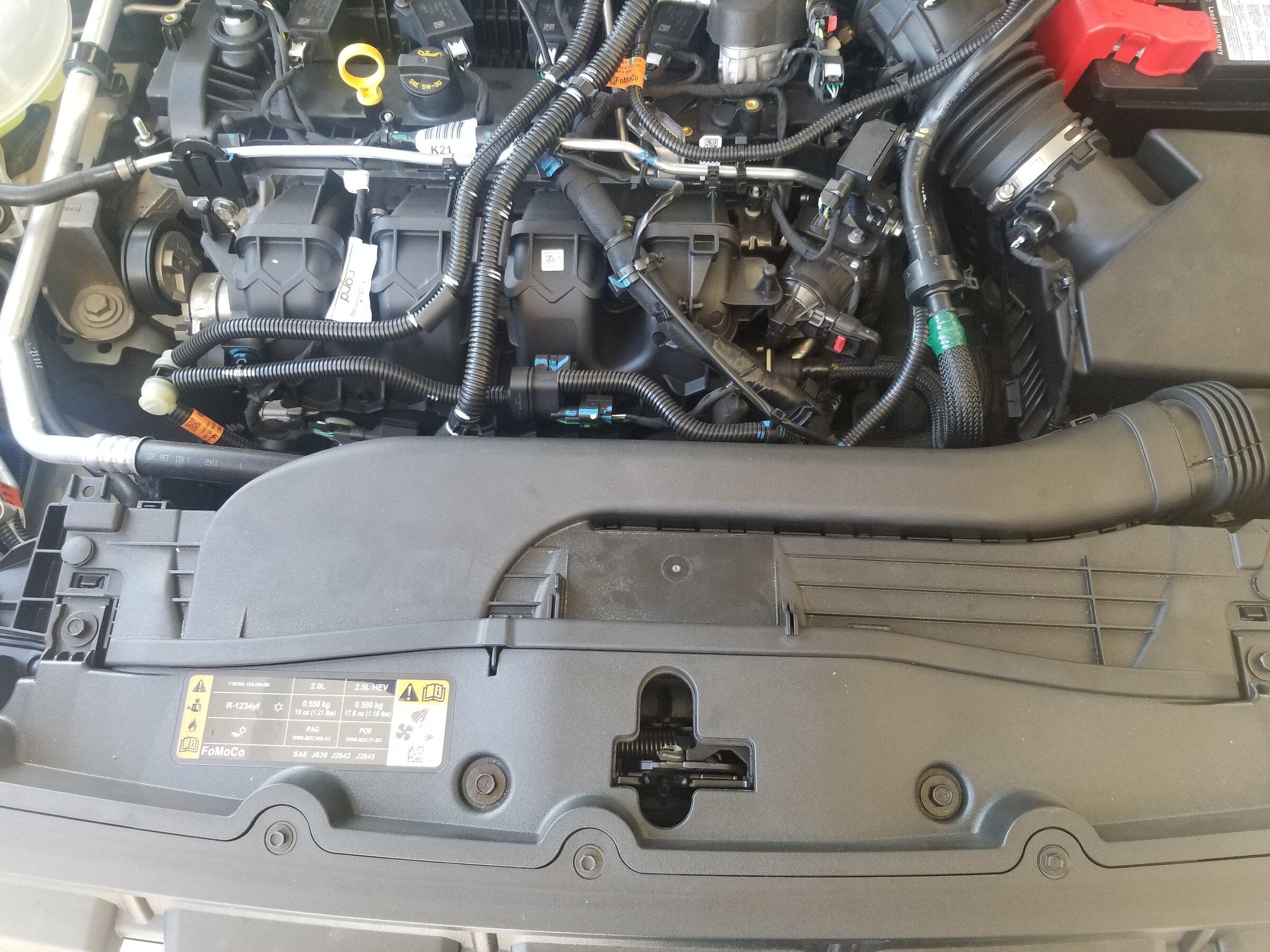

the tube from the air inlet above the radiator to the air filter looks tiny.
It’s shaped like that so the inbound air is squeezed for higher pressure and that means more velocity and that means more air.
Don’t try and beat the FoMoCo R&D they got deep pockets to research every detail.
