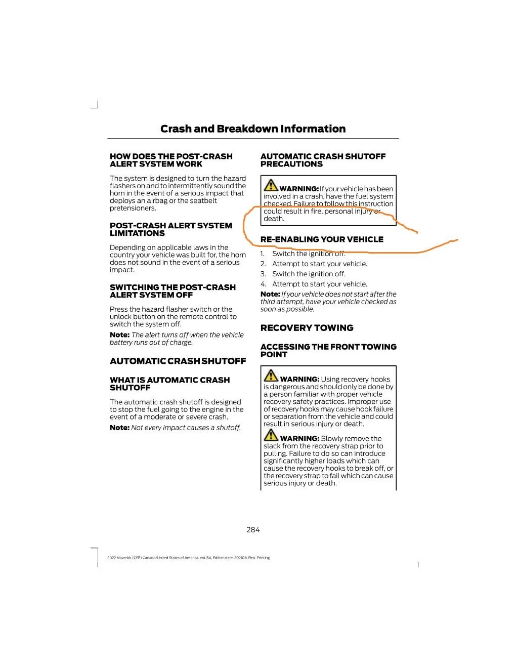

Does the new maverick have a fuel pump inertia switch and where is it located?

It almost certainly has one. The manual doesn't list it's location - Probably because its not part of usual maintenance and possibly because it seems people like to bypass it.

Ford Maverick Fuel pump inertia switch? om_1

I googled this question and found this. In the 2024 manual directions are the same but on page 287. Small point I know, but the manual kinda sucks on finding info.
