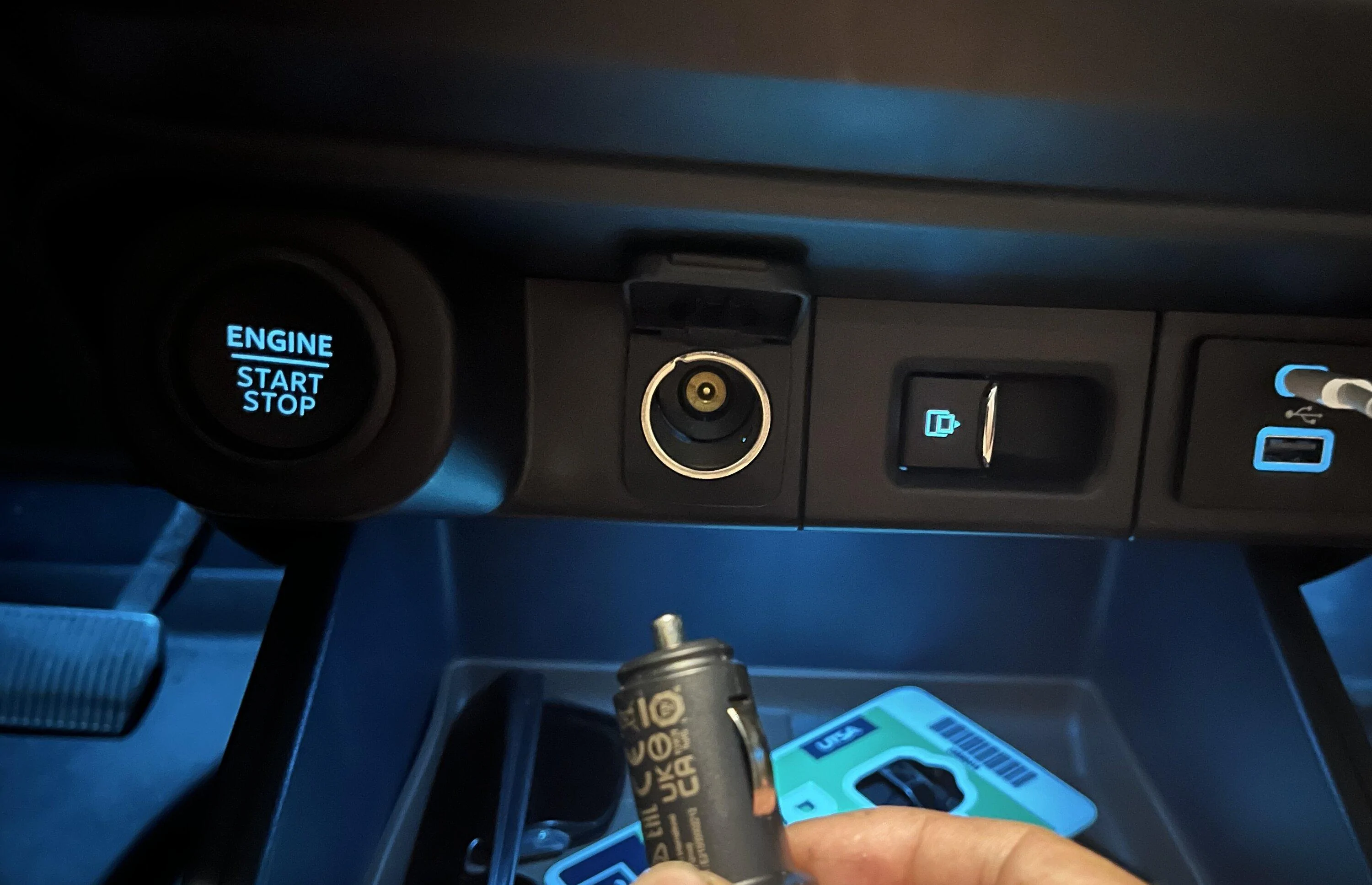

Cant tell if thats a joke I'm literally using the 12v cigartte lighter input thats on the dash to power the dash cam. I haven't touch any of the electronics especially ones that would cause the AAC system to fail.

Ok you are using the dash cigarette style PowerPoint and not the optional actual heavier cigarette lighter socket that came with an ashtray for $70. 😊

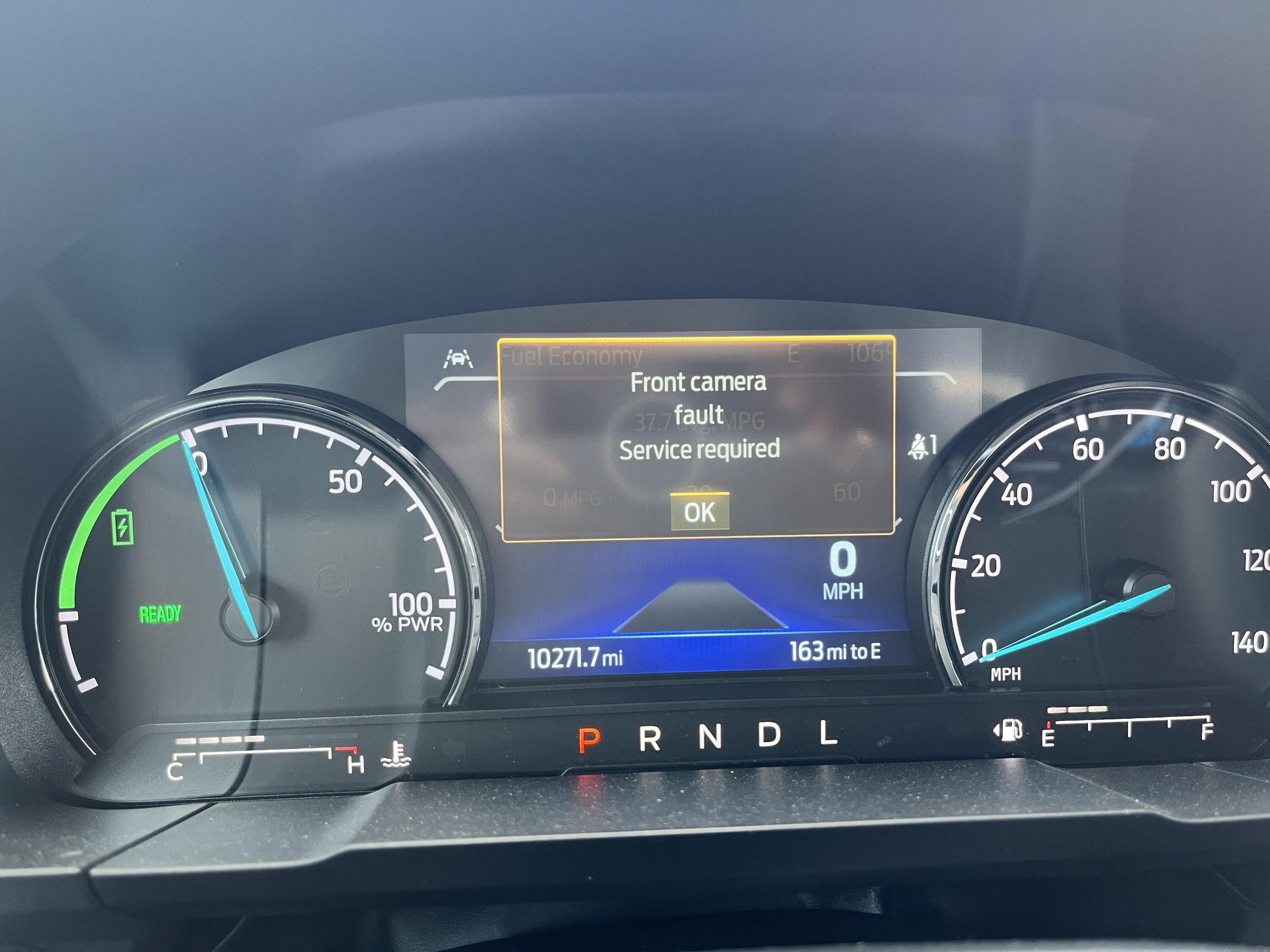

I was cursing down the high way on a nice summer day, was on the road for about 30 minutes when I get a warning on the dash "Front Camera Fault. Service Required"

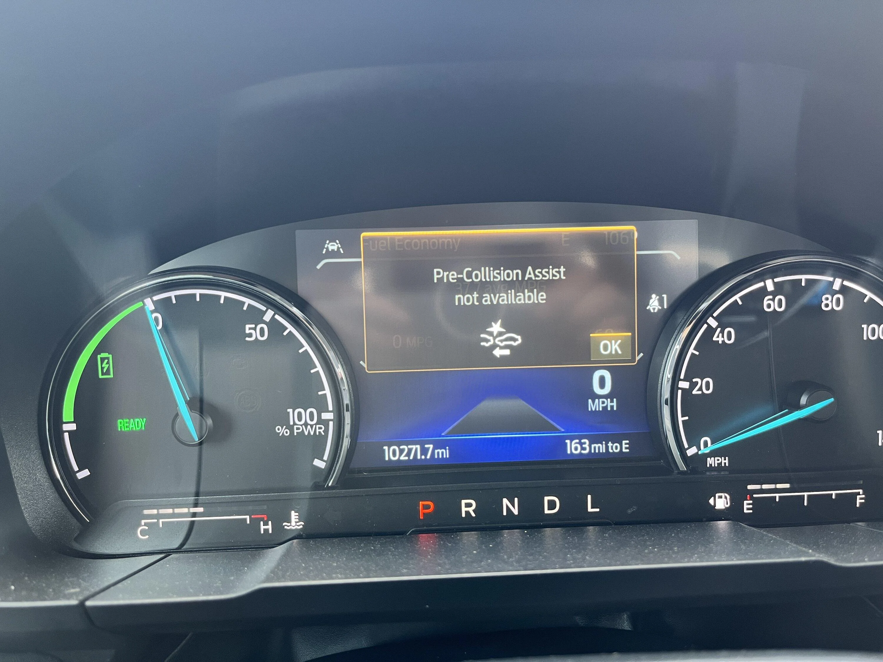

Now adaptive cruise and front collision warnings don't work and the worst part is the warning pop up every 5-10 minutes when I am leisurely driving. I've heard the horror stories about issues and I still am waiting to get parts for the recalls I need to get done for the car but now this!
Has anyone run into this before?
I have seen someone on the forum with warnings saying there are obstructions to the camera or sensor but my message is different, it clearly says camera fault.
Not a joke, they are referring to the optional package that changes the adapter to a higher power one that enables using a cigarette lighter. Shouldn't matter though because the voltage regulator should only supply the power you need, no more. But the pic shows you have the standard adapter.

Was this ever resolved. I have the same message Cleaned camera etc Plus my auto brights don't work

I only get the front camera message and I can clear it but the auto brights wont work? I've tried everything but reluctant to take it to the dealer because they seem to be guessing as much as me
