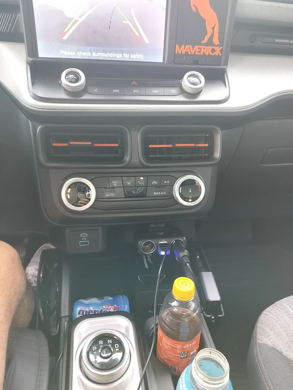

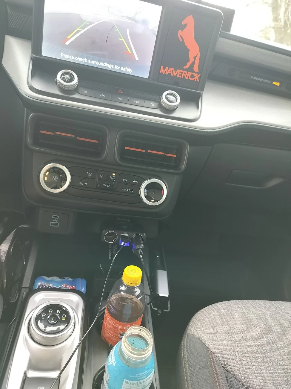

Hello all, this may have been mentioned before but I feel I need to post for some help/ opinions. I have a 2023 XLT. I did buy the truck used from my local dealer but got a good deal. After I had it awhile I did see the issue with the Back up Camera issue and took it in and they recalibrated it, that was maybe a year ago? Anyway now it has happened 3- 4 times that when I back up my review camera comes on then when I put it in drive and take off the camera is frozen on the picture it saw when I was backing up and it stays on until I get home and shut it off for awhile AND at the same time I cannot turn the volume up or down and cannot turn the radio off? That whole area is just like stuck? The climate control panel works fine. I even took pictures and a video of the problem to show them. I did take it to the dealership today and they had it about 6 hours and said " WE CANNOT REPLACATE THE ISSUE AND THERE ARE NO CODES OR ANYTHING TO GO BY SO THERE IS NOTHING WE CAN DO"? Anyone had the same problem? Anybody have any suggestions or input on this issue? It doesn't do it all the time and I never know when it is going to do it again so I understand it is a little difficult to diagnose something that happens when it wants to. Thanks for any advice. Here
Ford Maverick Freezing Display Screen IMG20251227125036
Ford Maverick Freezing Display Screen IMG20251227125510
is a picture I took of it and I had already driven about 6 miles and it was still frozen.
Ford Maverick Freezing Display Screen IMG20251227125055

Sounds like the typical locking up of the audio system. My truck has done this a handful of times. While driving, you can reboot the system by pressing and holding the power and seek-forward buttons at the same time. Hold until the screen goes black, takes about 5 seconds.
