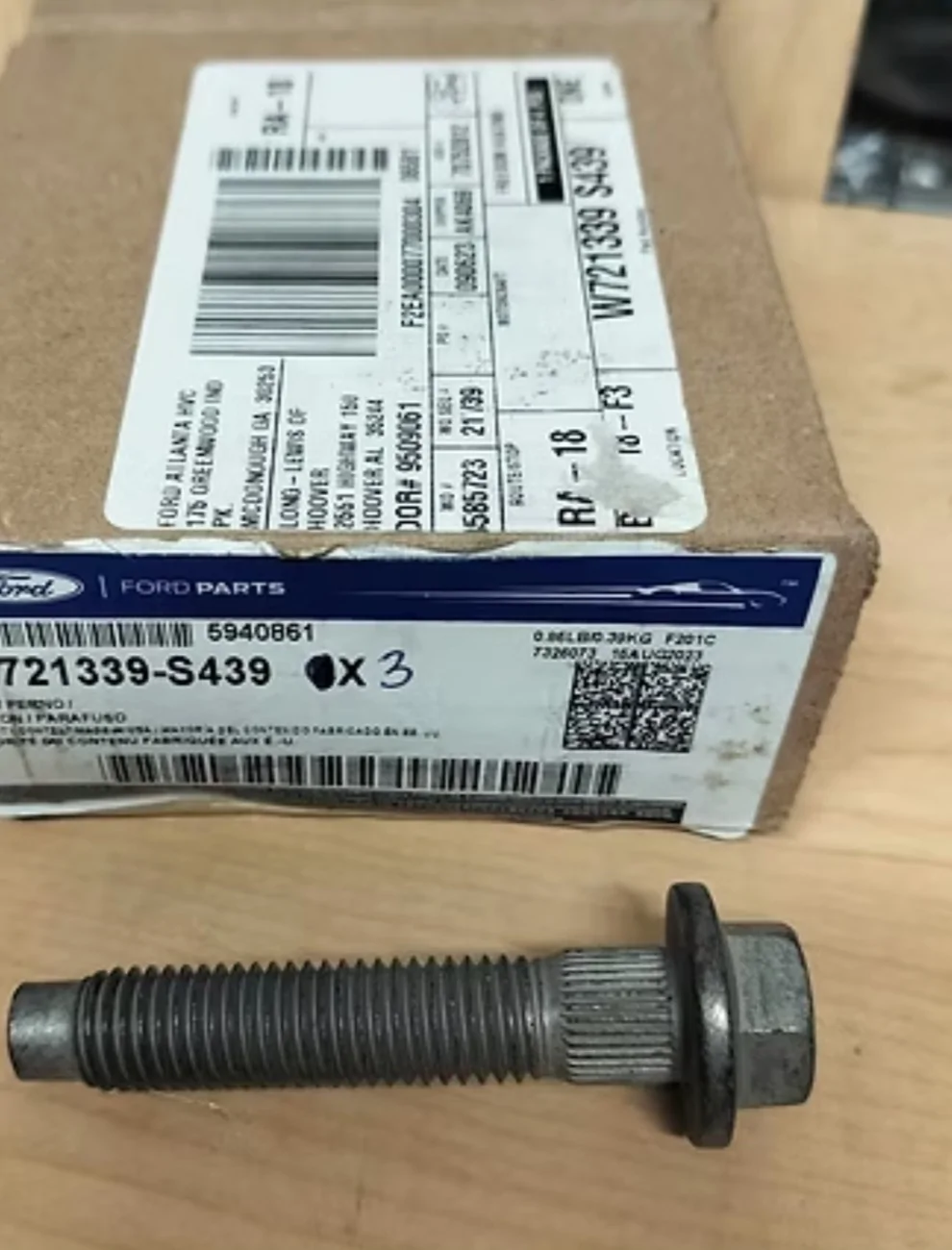

Are you guys replacing all four bolts in the front or just two?
Cleatus Member Joined Oct 10, 2025 Threads 5 Messages 15 Reaction score 12 Location Nova Scotia Canada Vehicle(s) 2022 Maverick xl Engine 2.0L EcoBoost Apr 27, 2026 Thread starter #1 Are you guys replacing all four bolts in the front or just two? Sponsored
Maverick_Dave Well-known member Joined Aug 27, 2025 Threads 4 Messages 252 Reaction score 598 Location KS Vehicle(s) 2025 XLT Mav. 2000 Explorer. 1986 Camry Engine 2.5L Hybrid Apr 27, 2026 #2 Top 2 only
F100Lobo Well-known member First Name Steve Joined Sep 2, 2025 Threads 6 Messages 136 Reaction score 334 Location Montreal Vehicle(s) 1977 F100, 2013 Focus, 2025 Maverick Lobo Engine 2.0L EcoBoost Apr 28, 2026 #3 The shank of the stock bolts are splined. The splines bite into the knuckle. They have to be hammered to remove them. Be sure to leave them a little loose so as not to pinch the strut when adjusting the upper camber bolts. Sponsored
