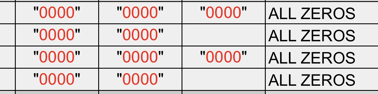

Now what gets changed when this is posted? This change relates to these numbers but is it something that is seen only when in forscan?
Ford Maverick Forscan question 1779027713337-1g
