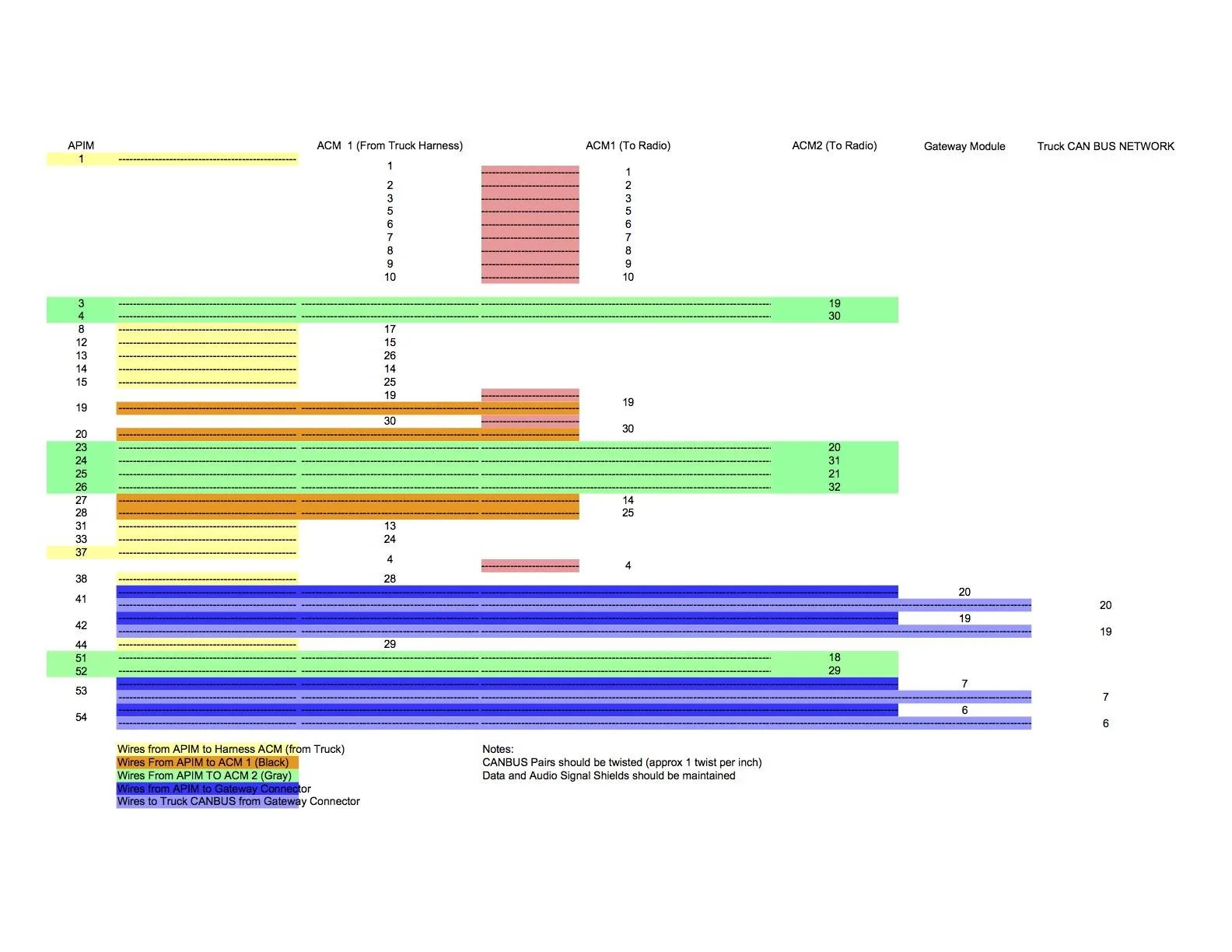

Hopefully someone with a 3D will make🤞 Capermike sent me this: I found it very easy to understand making the harness.
also shop around there are other components
Ford Maverick Fordsync4 Buyers remorse - DIY Coming Soon for Sync 4 conversion IMG_4248
cheaper than first listed.

Is your harness going to be compatible with installing sync 3 as well. I’m concerned jumping to 4 as those who have done it had issues communicating with the TCU and Fordpass.

Just confused on making harness. Some said they go right off acm connector, others say you gotta splice into the GWM… was hoping there’d be a p&p kit at this point.
