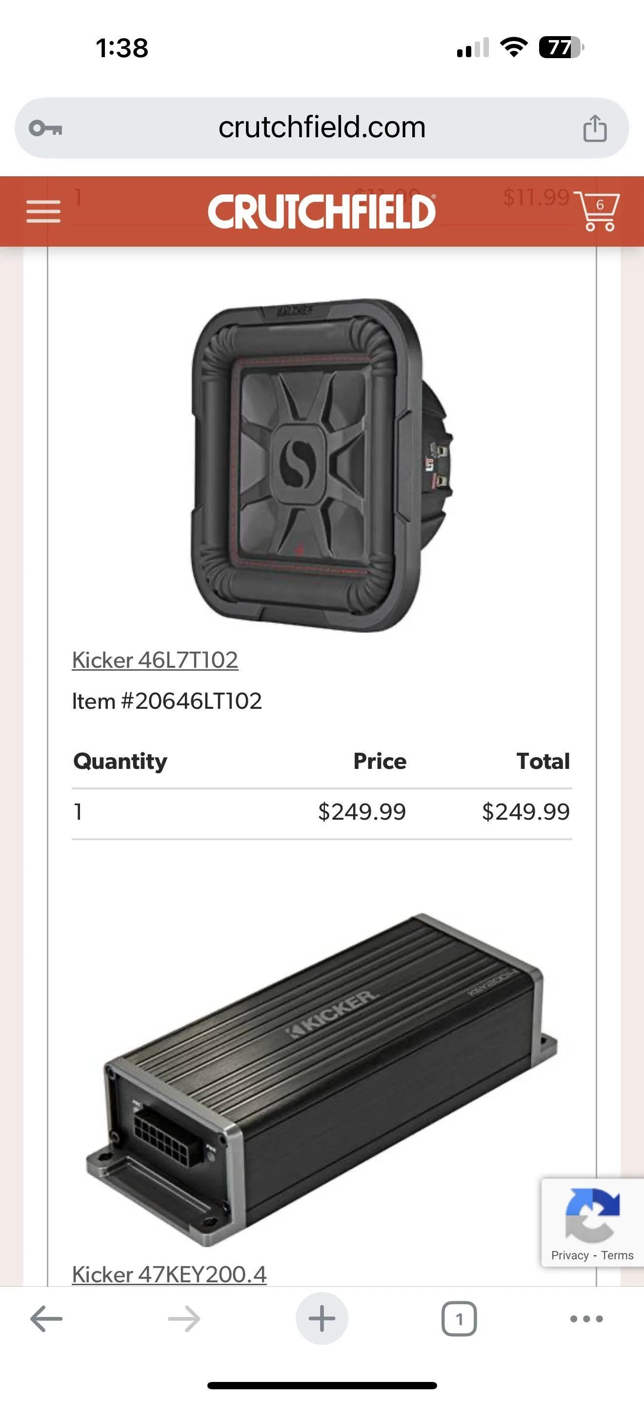

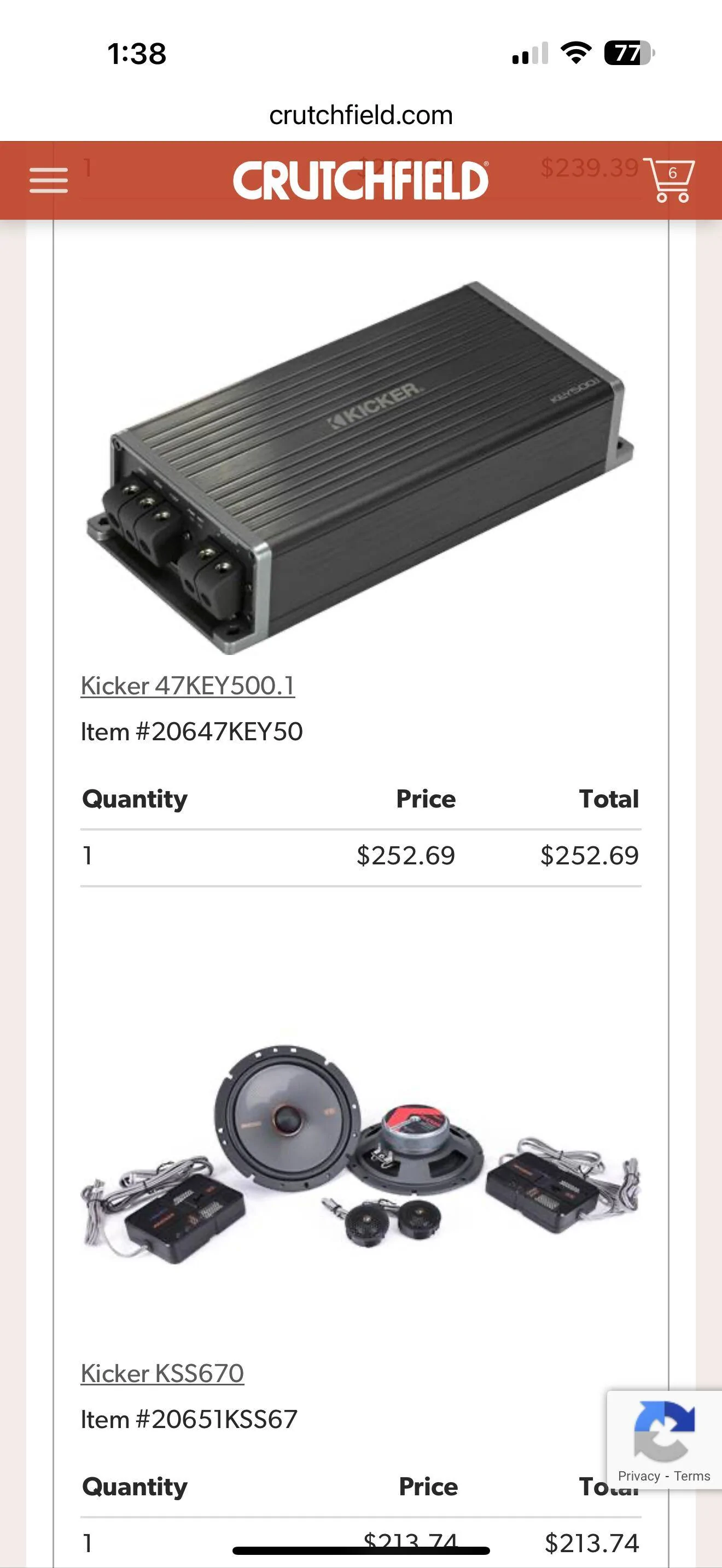

I just ordered all the gear to replace the B&O in my 2025. I went Lariat just for the “premium” stereo but it is just not like any other B&O I’ve heard. The only component that isn’t going to be Kicker is the PAC AmpPro. I’m doing bi-amp on the KS components, removing power from the rear and dash and running the single thin Solobaric 10” for now. I’ll reassess and modify as I feel necessary after. Most rear speaker are pretty useless with as little as a 500 watt sub.
I’ll be doing a thorough update during the install.

Sweet. I have the same 200W amp and door speakers but I am doing the 4” speakers in the back as well, and no sub.
I’ll be following, but if you bi-amp the fronts, you’re doing the crossover wiring a little different than me. Good luck!

I agree that with no sub powering the rear is absolutely necessary!
For bi-amping components, the crossovers get left out. The KEY does all of their work instead. I’ve never used one before but I’m pretty stoked to.

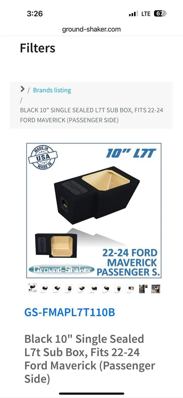

What box are you running?

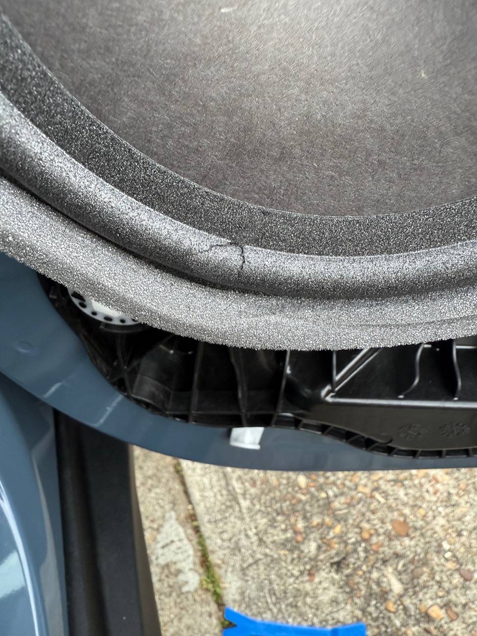

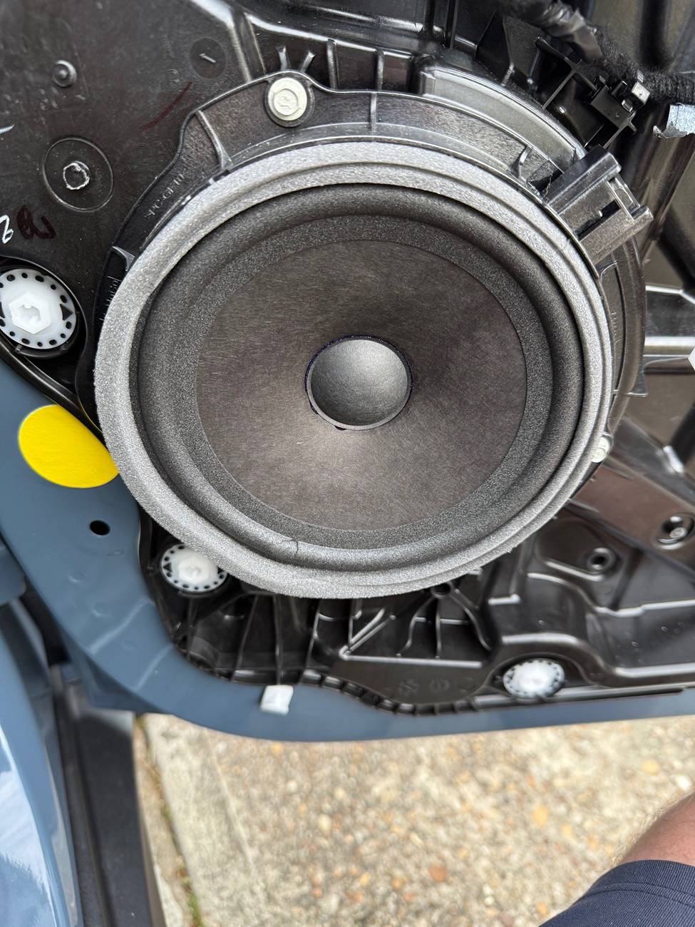

I agree that the B&O system sucks I replaced the door speakers and installed a sub and amp. Wait to you see how cheap the door speakers are made
Dude for real! I received a lot of the gear at about 6 last night. I decided to knock out the doors because I had plenty of daylight. One of the cheap door speakers is torn!! From the factory!
