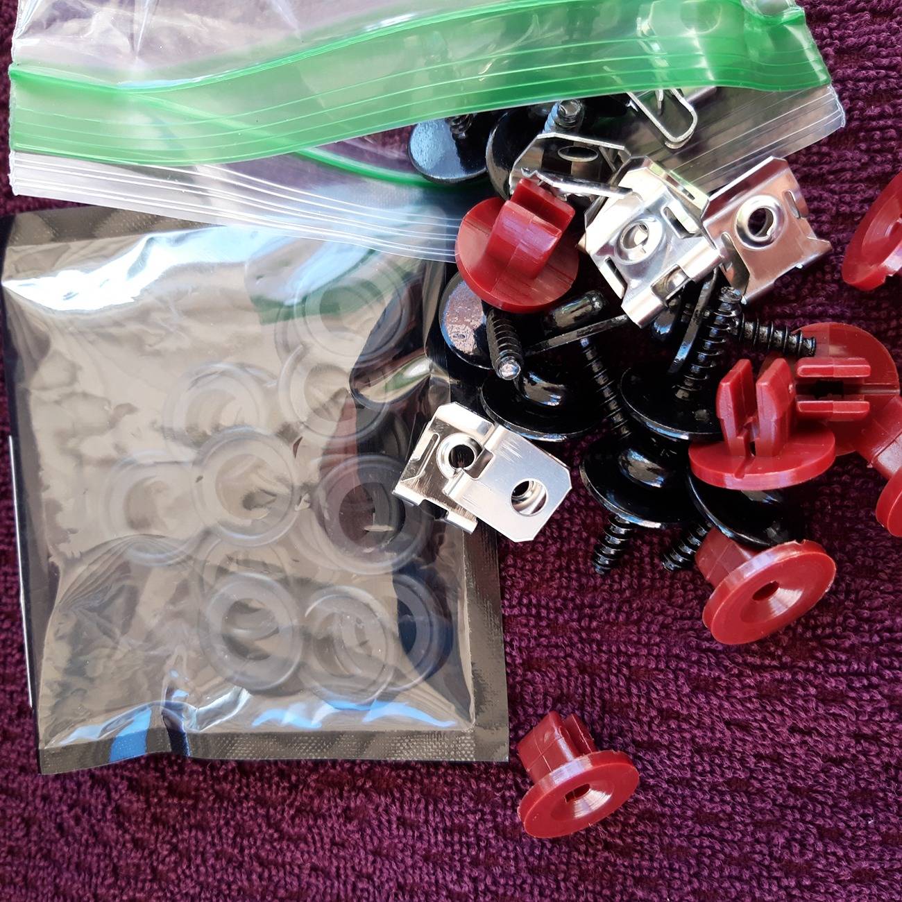

I got a bag of these washers off the internet last spring I don't remember if it was eBay or Amazon. If it holds tight I plan on changing them every oil change. Why not I have a whole bag of them. I've only used one so far no leaks. I did keep the old one just in case.
Don't forget the extra screws and spring nuts. You may need extras. You're to remove and replace 15 screws when you do your oil change.
They are available.
