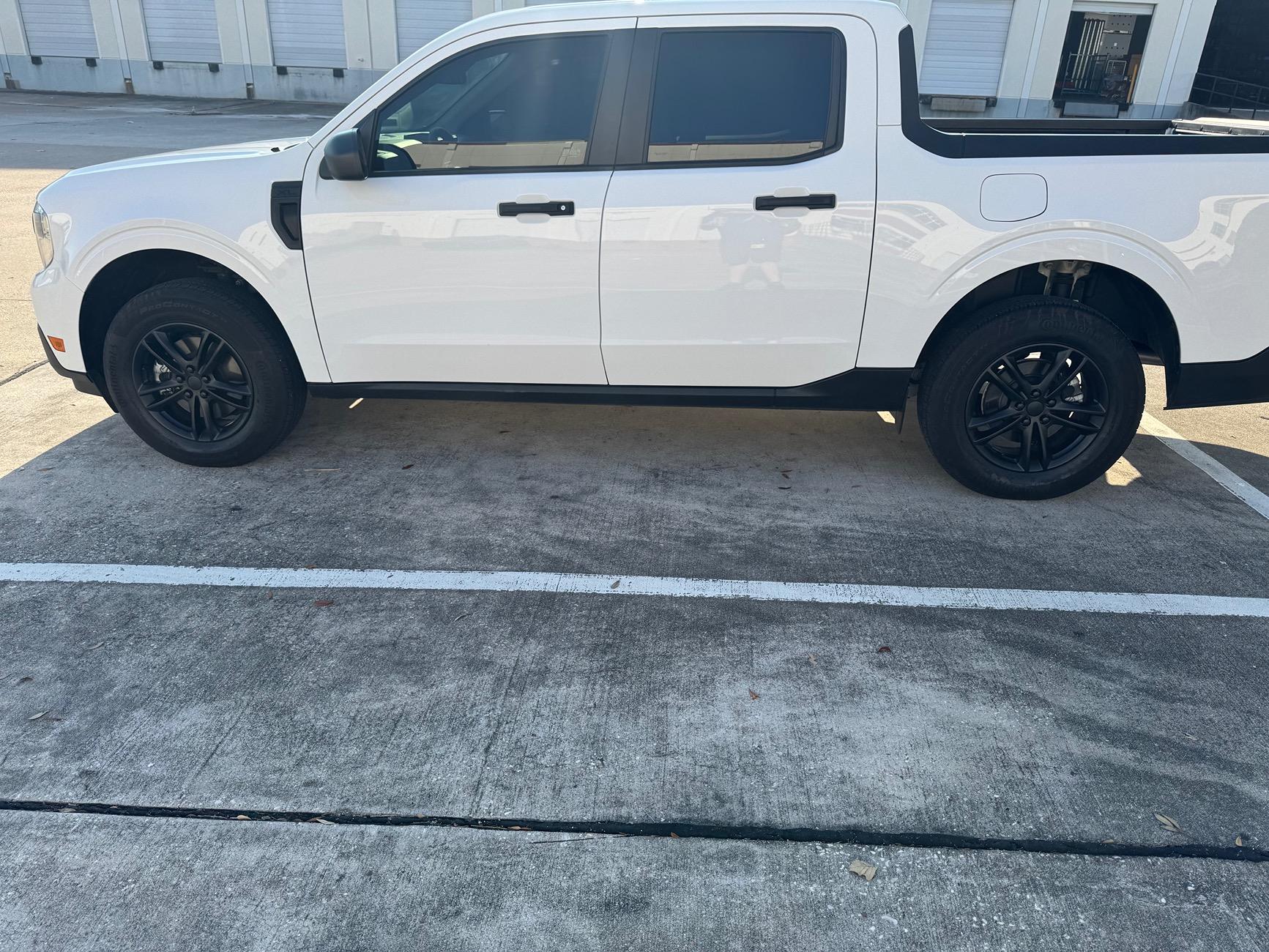

The 2018 + fusion wheels fit fine
Ford Maverick Ford fusion wheels with +55 offset will they fit? IMG_5212
what size tire?
BTW my post from 18 months ago, I did go with a 255/55-18 and it does fit fine. tons of room on the inboard side.

what size tire?
The factory tires for now 225/65-17
