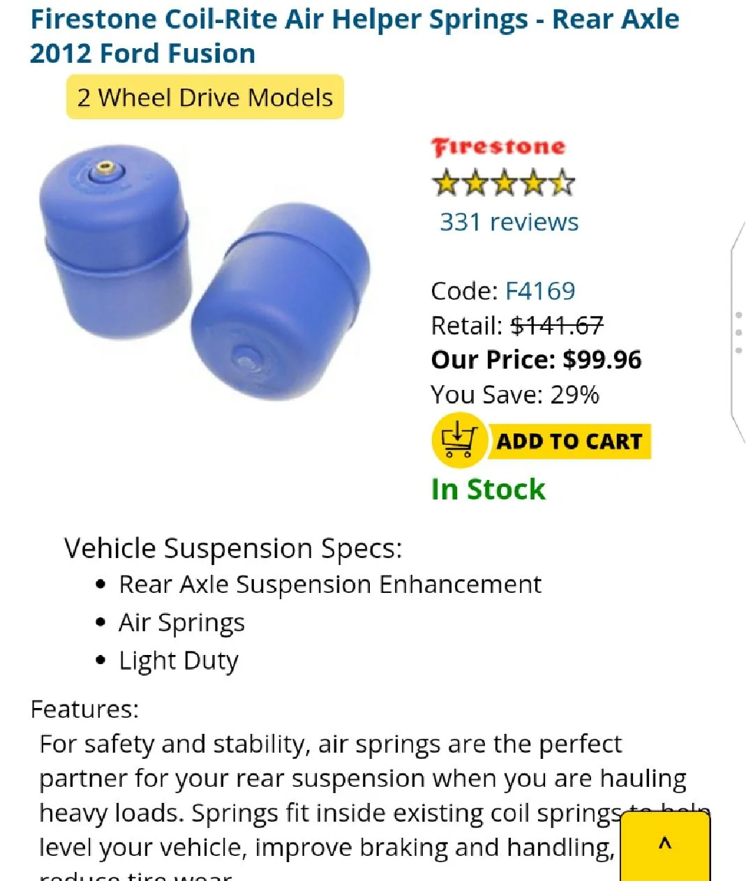

Thank you for those valuable documents. Do you think we could find some aftermarket air helpers for better towing capacity?
