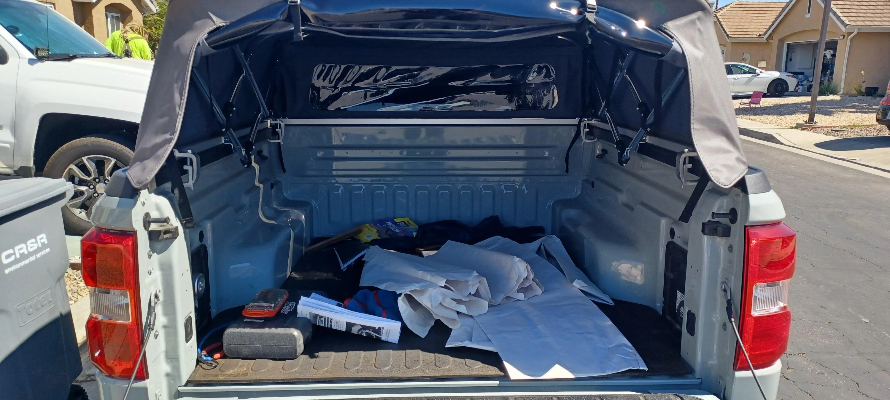

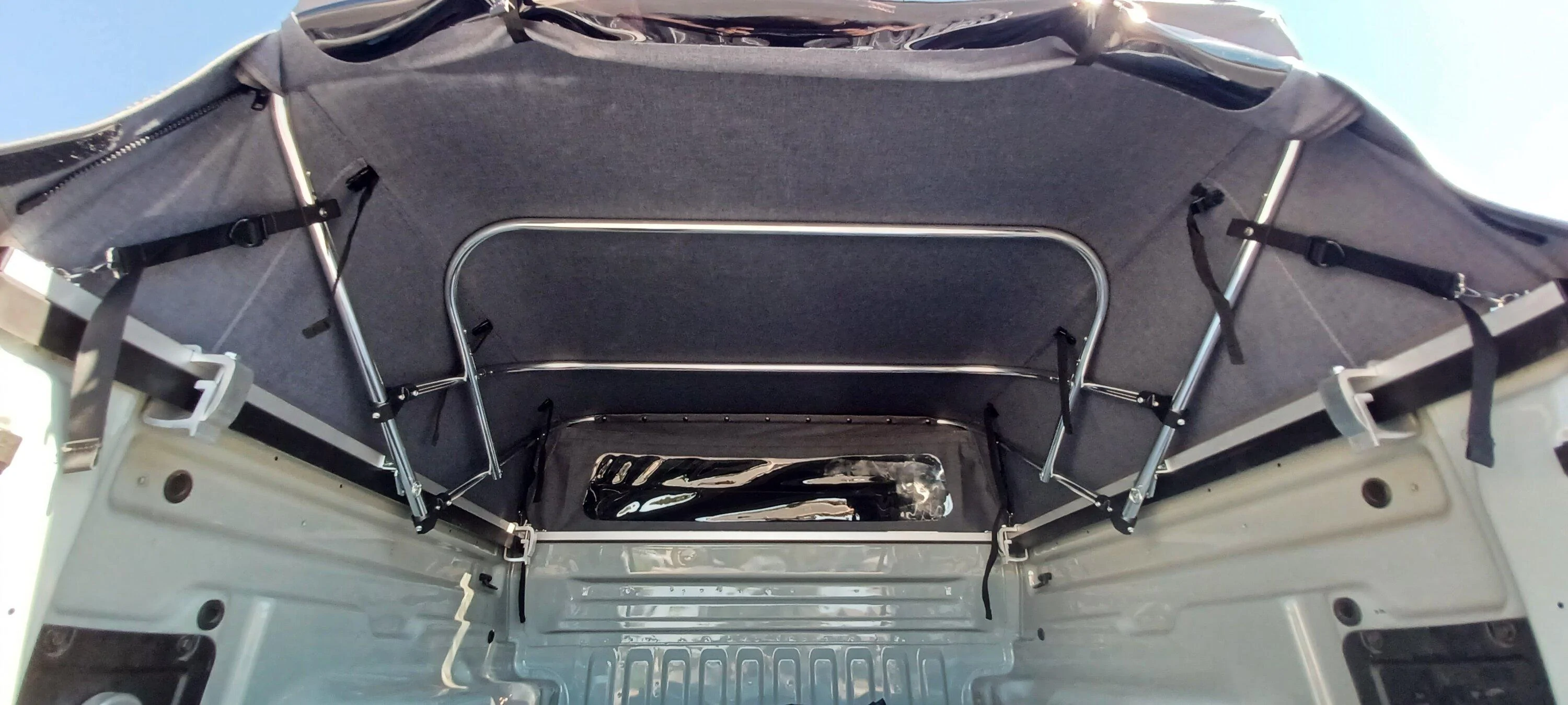

Would you trust this if you filled the back with boxes? Or would you use a cargo net over the boxes to help keep any sliding off the frame of it?
Booyah πŸ‘ŠπŸ½ 😁 πŸ‘πŸ½ πŸ‡ΊπŸ‡Έ
Stacked it to the top many times. If it is going to shift or move just tie it down inside and you'll go.

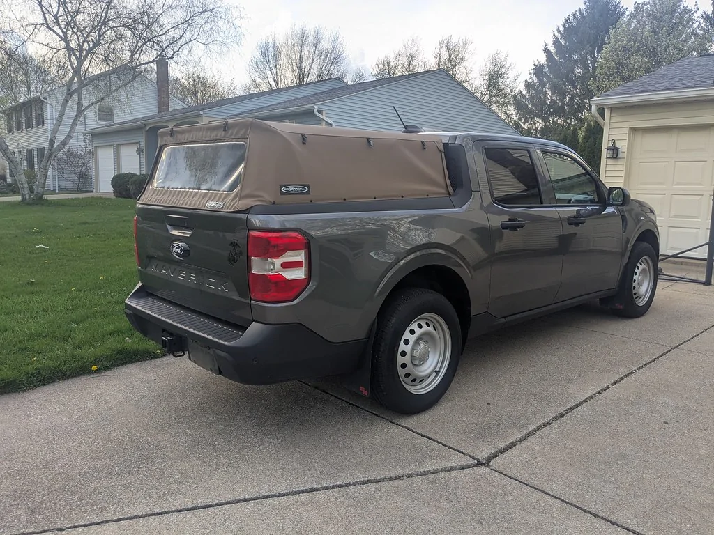

I've had mine installed for a couple of months now. It's been a rainy spring and I can reliable report it leaks. Water is getting in where the plastic trim around the bed has that seam up toward the cab, both sides. It's a natural channel. I followed the instructions and put a little extra sticky foam in that groove but water is getting in anyway. I think some silicone caulk is the only solution.
Also, on hot days, the adhesive on the Velcro appears to soften - comes right off if you tug the back flap too vigorously.
Softopper has a couple of bugs to work out of this one.
Ford Maverick Folding Softopper camper shell installed on my Maverick 55274547848_faa4ed65e7_

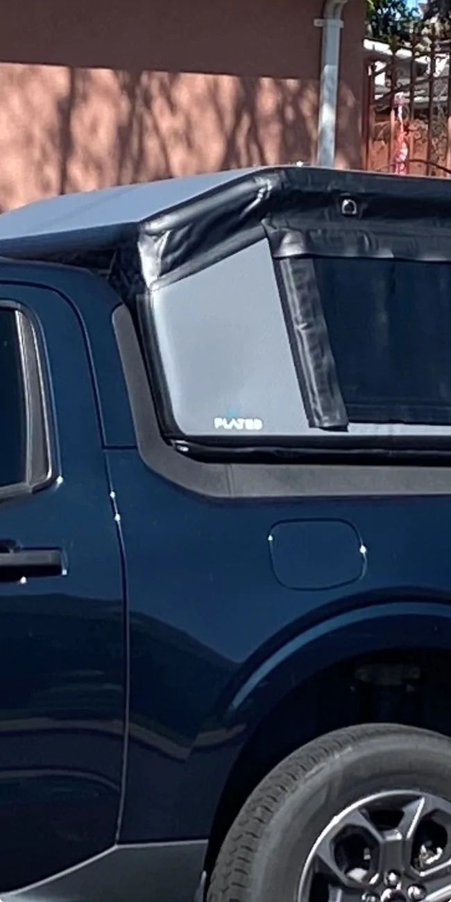

Flated:

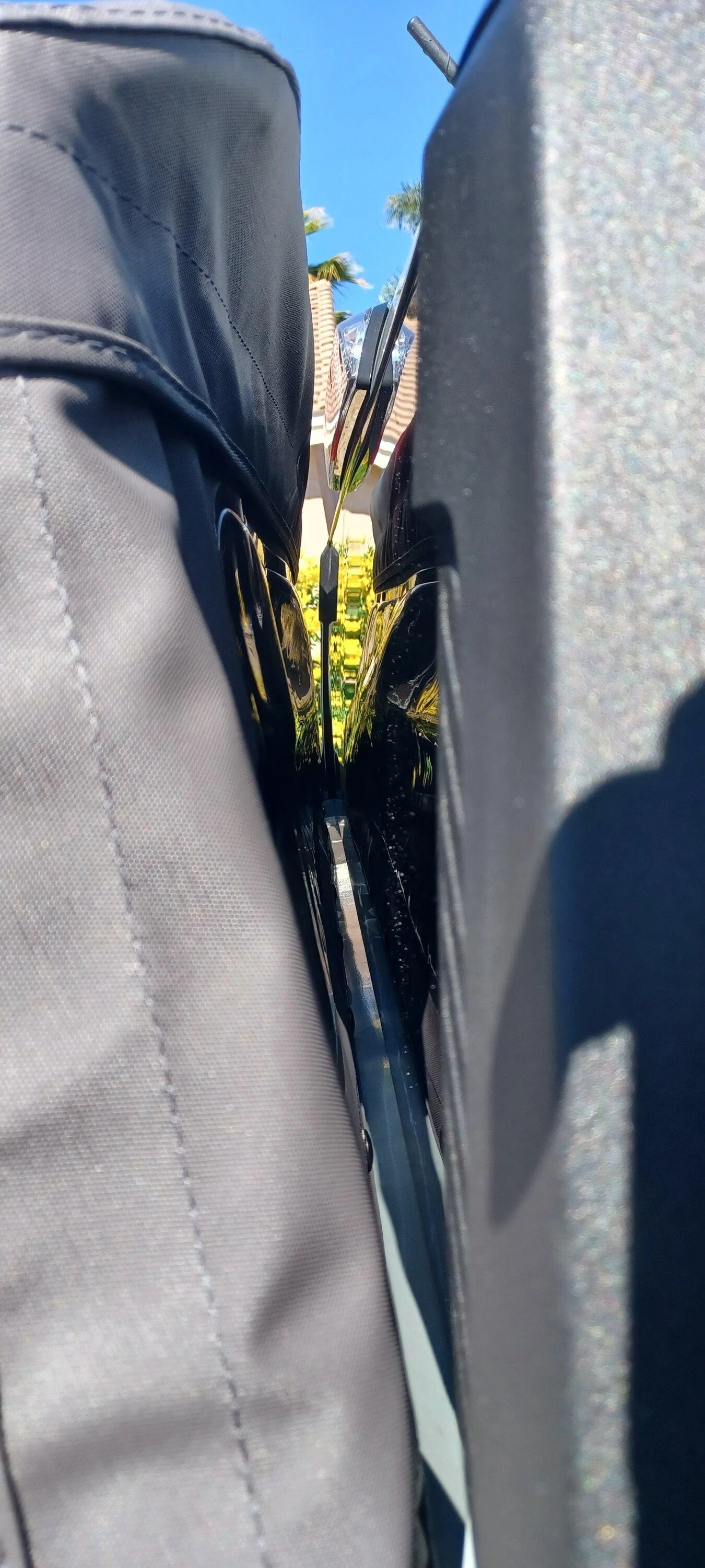

Waterproof except for the side that touches the cab glass. To be expexted with a "temporary" topper.
Love it. Zero effect on MPG + or -
