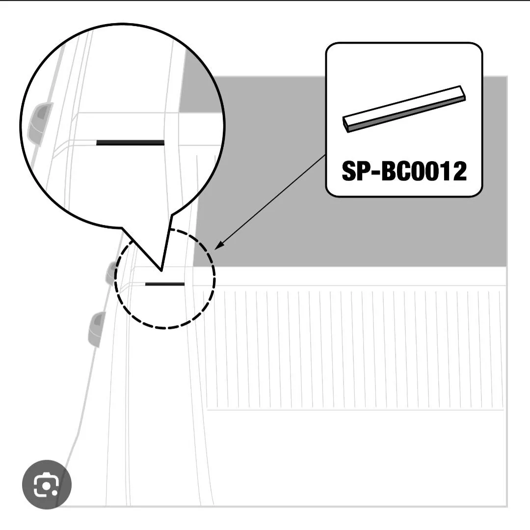

Nothing that a good roll of weatherstripping from Lowe's or Home Depot can't take care of. Even many tonneau covers have a degree of leaking on the Maverick due to the design of the upper bed sides. Not a problem to fix with the stripping.

I have installed a Truxedo Pro X15 roll up tonneau on my Tremor. In the areas around the front of bed and down the side rails I used butyl tape to seal these areas and have no leaks, even in big down pours. The X15 comes with some really good sealsm but adding the butyl tape made all the differance in sealing the bed. Try to seal your camper with butyl tape and end your leaks.

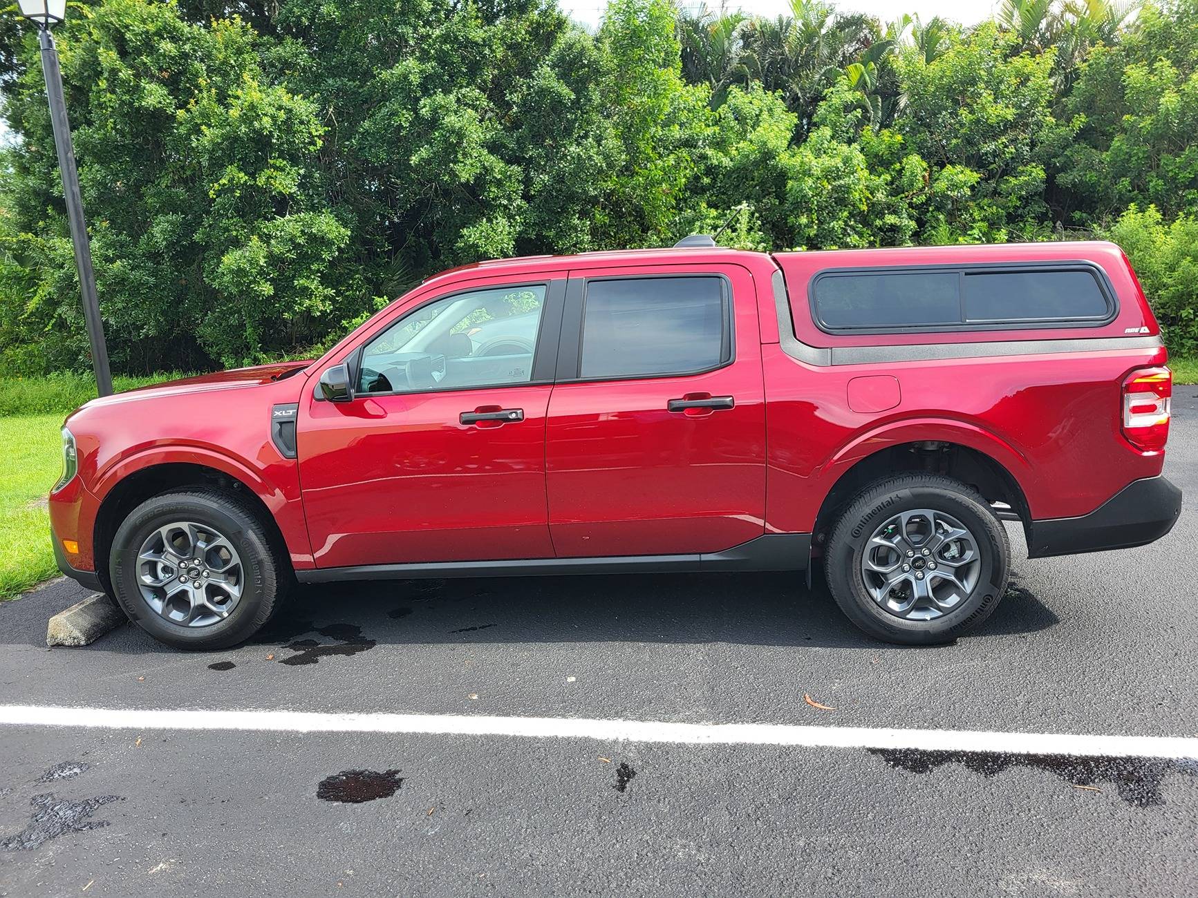

Got my topper on Tuesday so will see if I have any leaks.
