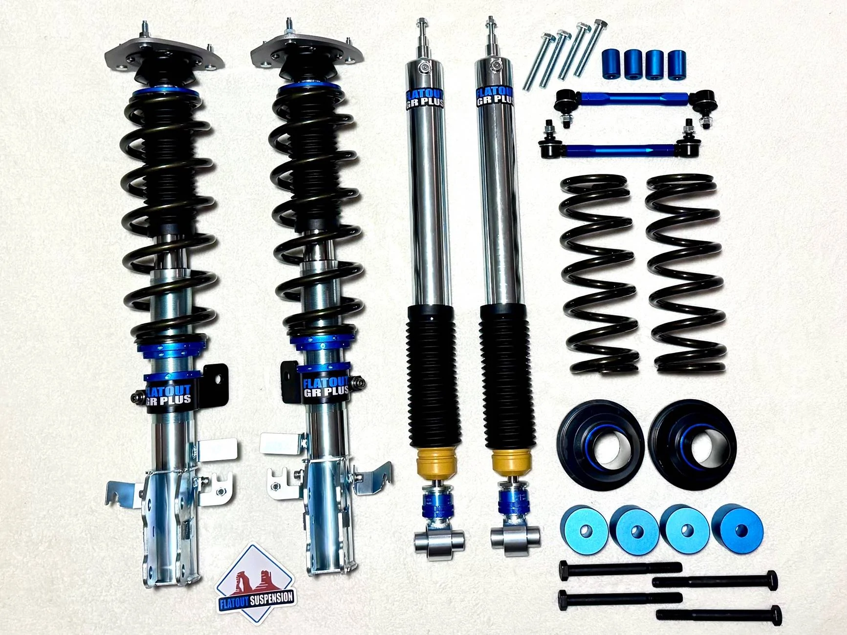

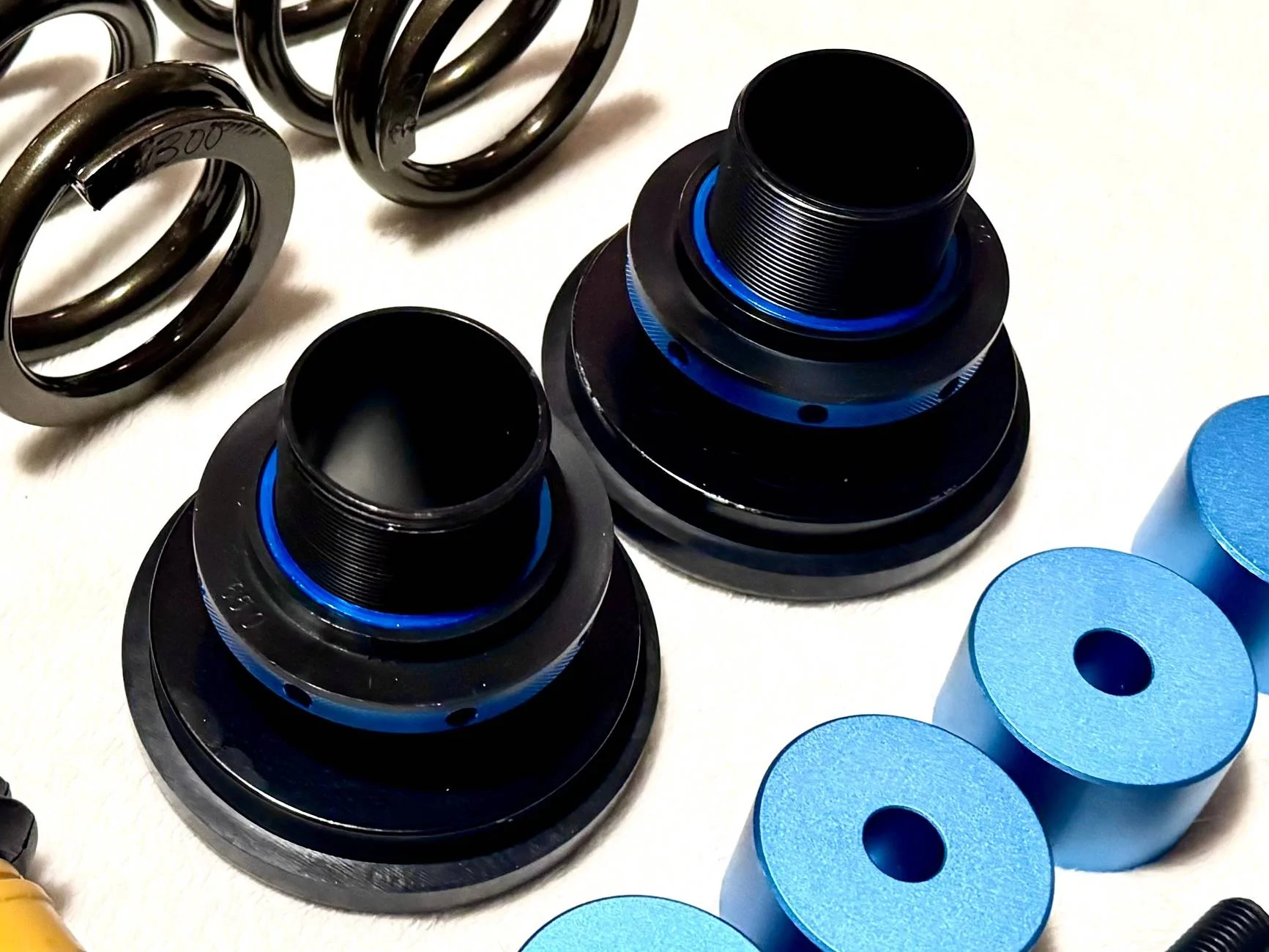

Flatout GR Plus 2” adjustable lift suspension for the Ford Maverick AWD (including Hybrid). Yes, we have a kit for the FWD/ Hybrid as well - just a few different bits than what’s shown here.

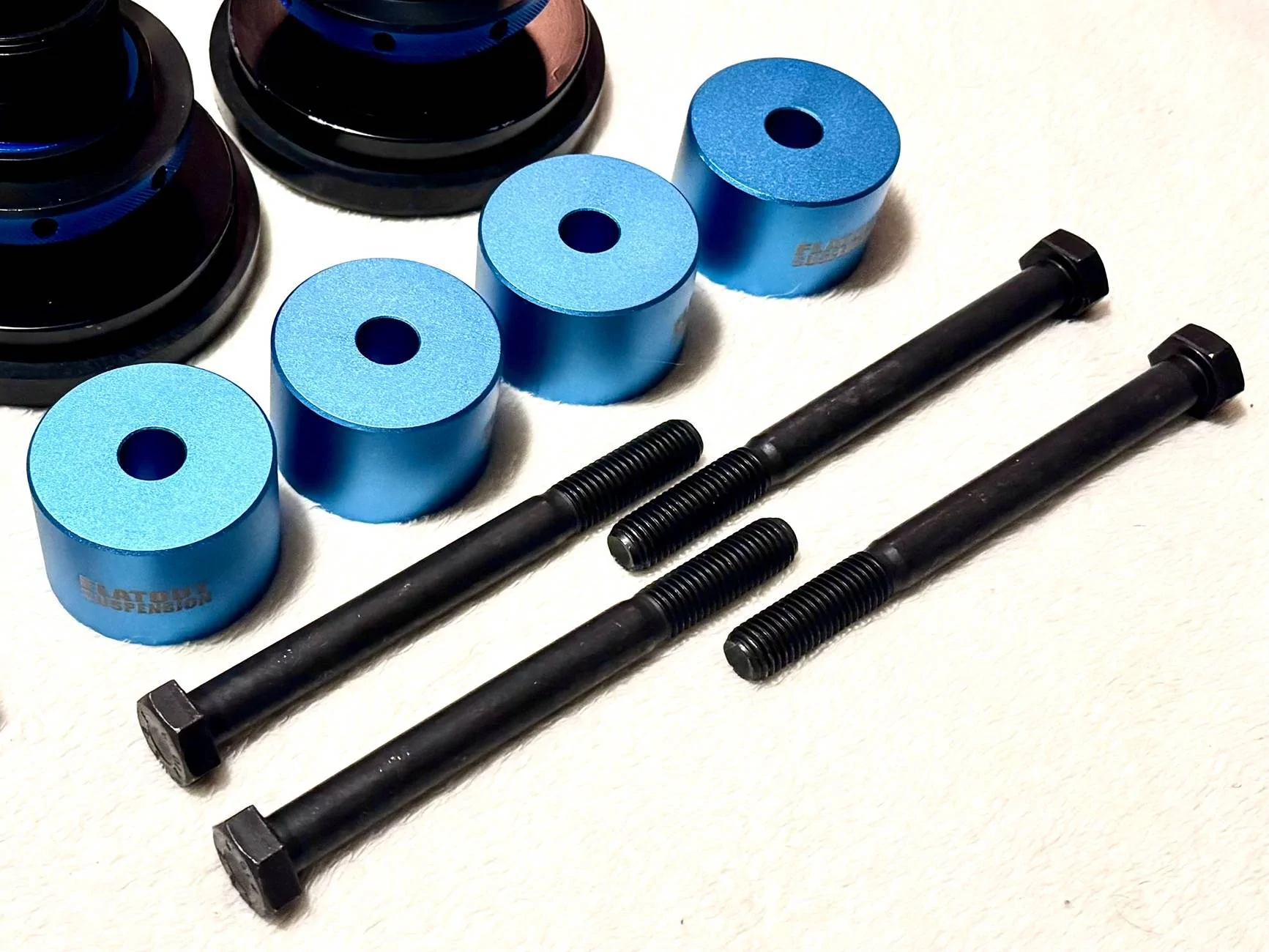

I don't see anything in your kit like an engine-lowering cage to keep the CV joint angles reasonable. Its maybe a better looking kit, but still kills the vehicle in the same way that the competitors do.
Skulls Road
Mar 16, 2022
126
149
High Desert
Those blue metal donuts in the picture are subframe spacers.
Master Blaster
Master
Feb 20, 2024
1,320
1,939
Toronto
23 Maverick Lariat Hybrid
Hmm. I looked at ther install instructions and they don't seem to mention any step about installing subframe spacers or any step that would do the equivalent of that. Also both of the 2 possible Mav kits do not show those spacers like the Bronco Sport kits do. Either the instructions are missing the most important part, or there are no critical subframe lowering parts in the kit. Can you confirm?
colinl
Colin
Jun 21, 2022
5,440
6,180
ICT
I noticed that about the maverick instructions as well, and then noticed that the subframe spacers for the bronco sport kit are *rear* subframe spacers which would not do anything about the cv joint angle on the front.
this is why I asked 10 days ago if they are going to offer revised control arms.
