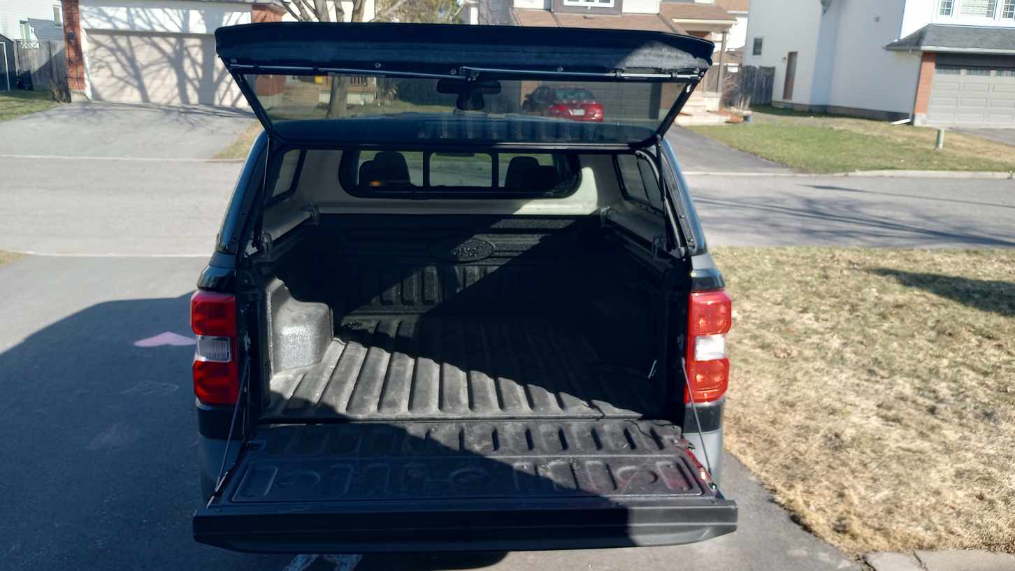

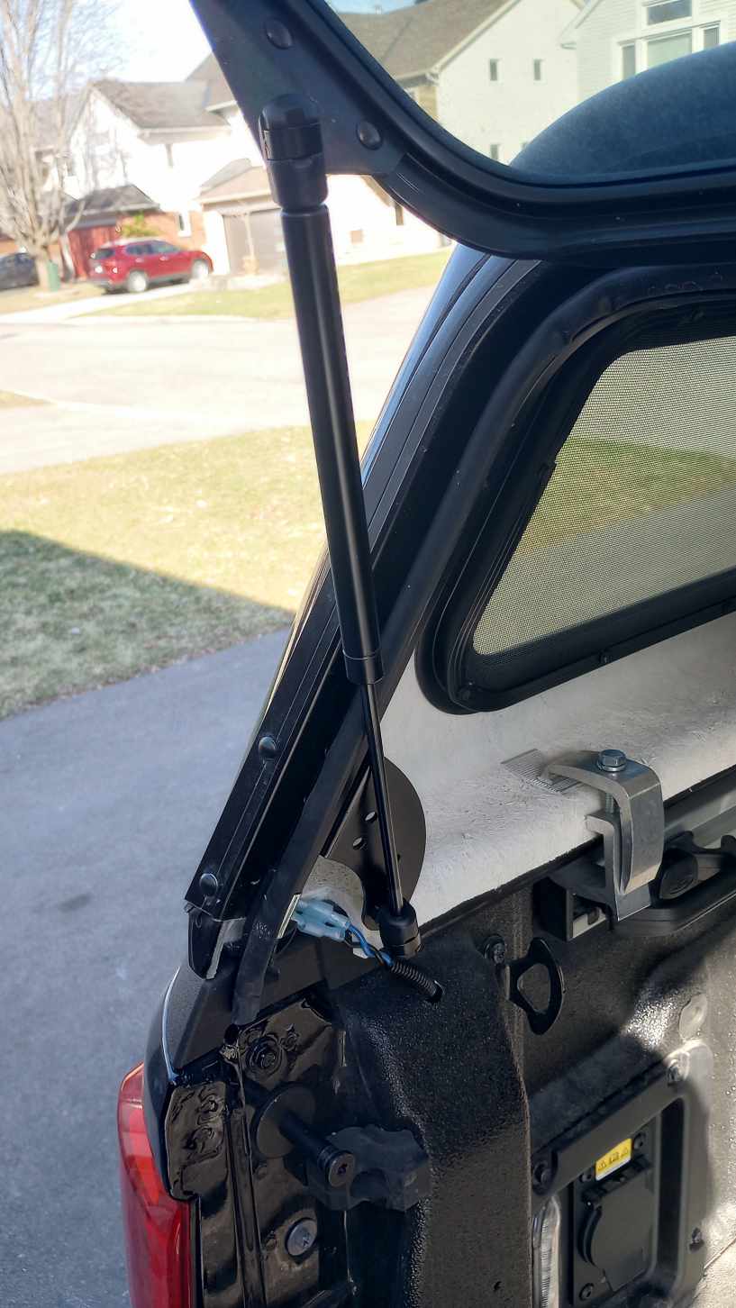

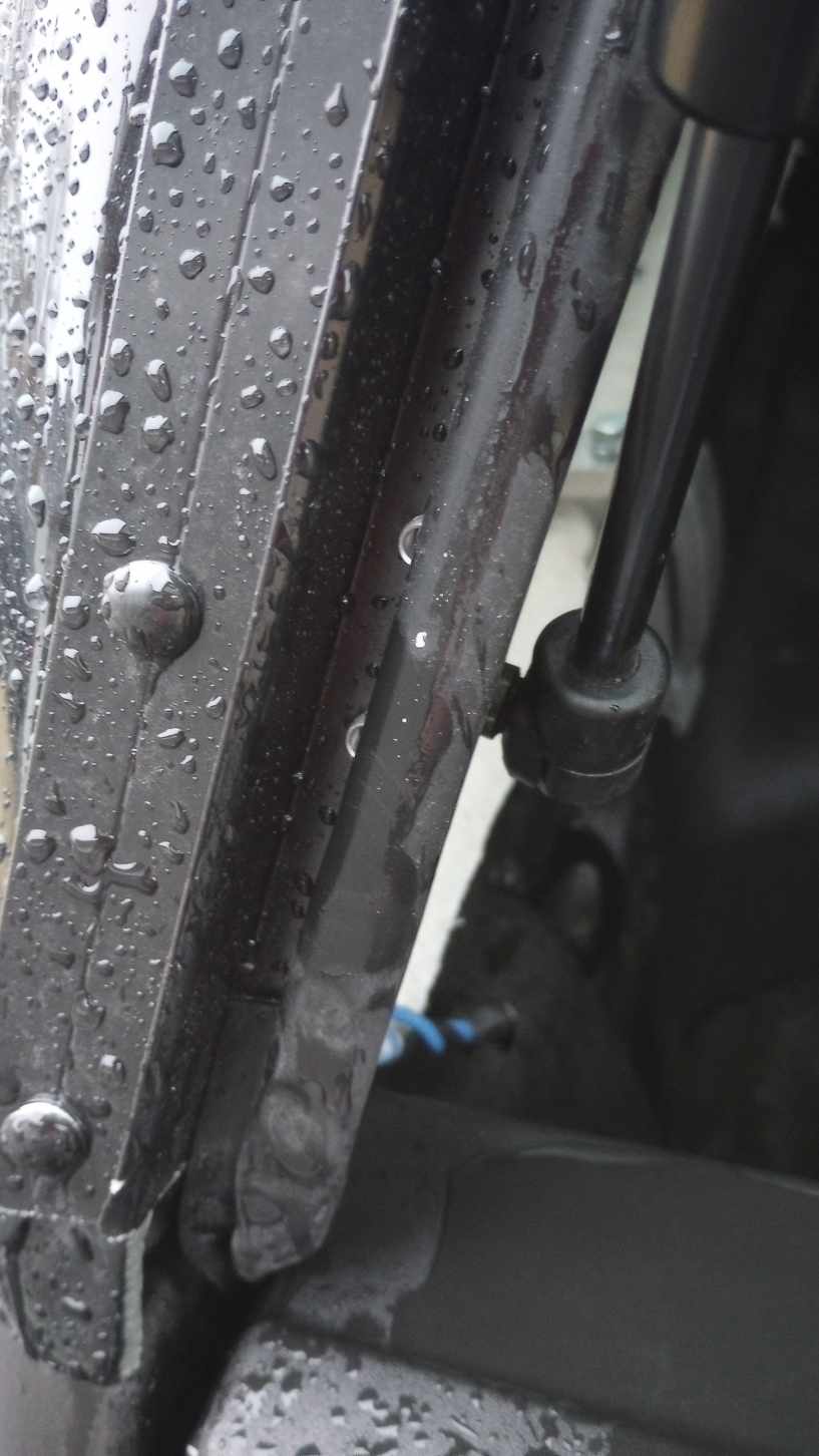

Thought I would share as it was 30 min fix for around $60. My excitement after the topper was installed turned to annoyance pretty quickly when I opened the rear hatch for the first time to see it only open to a 90 degree which meant the hatch door was in my teeth. Completely useless for loading or unloading.
I ordered a new universal mount bracket and new 14" lift supports from amazon.
I started by drilling out the original lower bracket rivets. Then bolted up the new bracket and snapped on the new longer lift supports.
Hatch door now lifts significantly higher and I'm not bending over or banging my head on it.

Ford Maverick Fix for low rising hatch door on ARE toppers IMG_20240403_183830776
Ford Maverick Fix for low rising hatch door on ARE toppers IMG_20240409_092154589_HDR
Ford Maverick Fix for low rising hatch door on ARE toppers IMG_20240409_092141338_HDR
