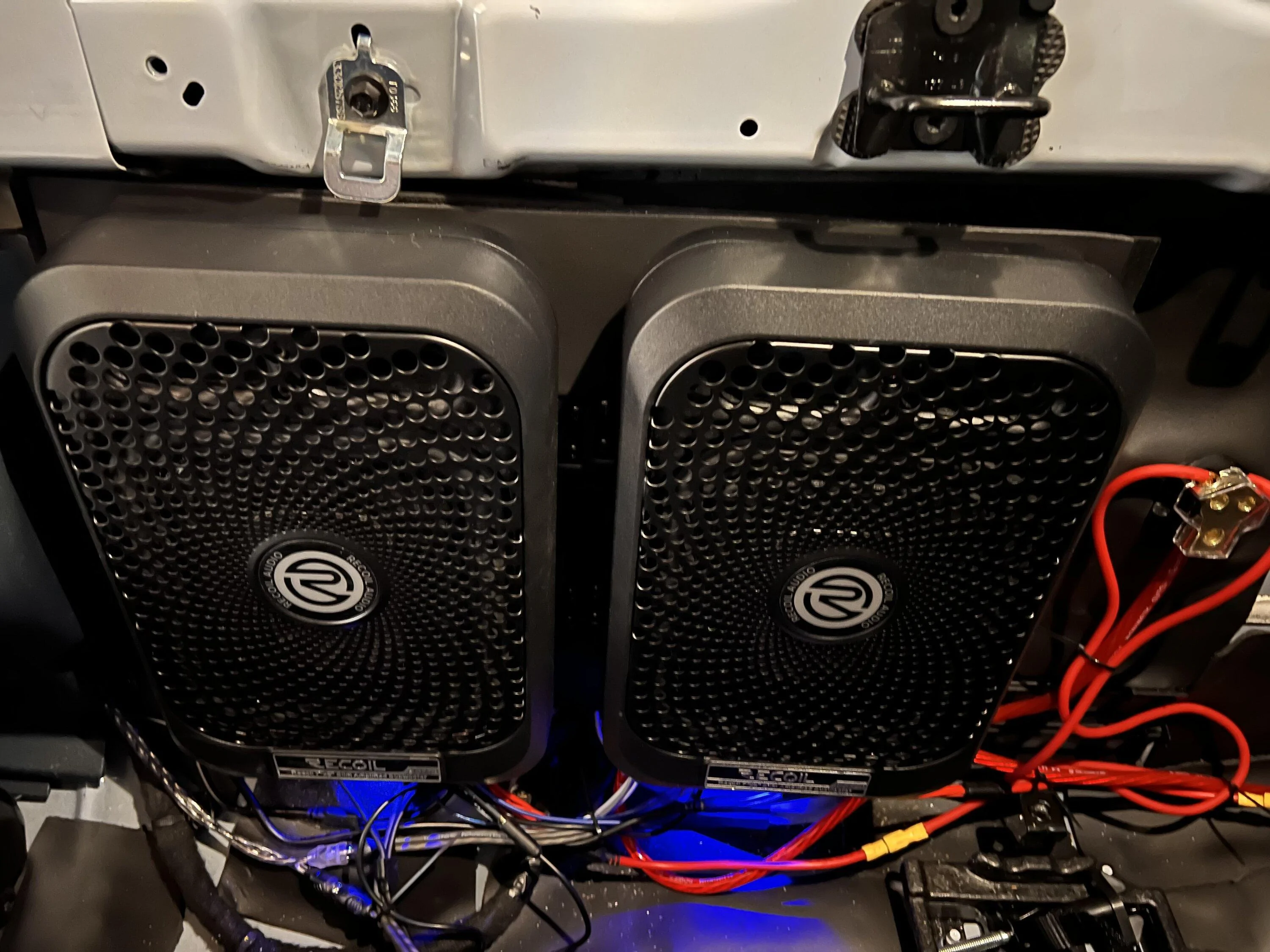

I installed 2 Recoil 1779 slim underseat powered subs behind the seat as well as upgraded all speakers on the base factory system. I am very pleased. I have the XLT, I don’t think and under seat sub will fit under either front seat due to the air vents.
I am very satisfied. My subs and new Herts front door speakers are all I need. PUZU dsp allowed me to set several different tuning options for different genres of music.

The PUZU DSL allows me to control each one separately, only run 1 most of the time. DSP is about $135 and has a built in amplifier for other speakers. The DSL is the GameChanger of the system IMO
