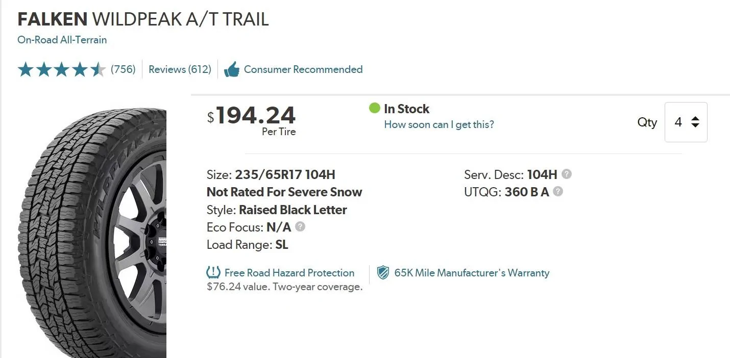

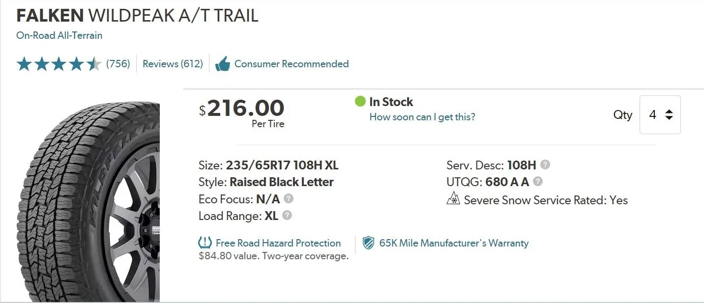

, because quick tire wear is a frequent complaint about this specific tire, the wildpeak at trail.
There are actually (2) versions of the Trail, in the 235/65R-17 Tremor size. Look at the large UTQG difference between the 104 and 108 versions, plus the 104 is not 3-Peak rated.
