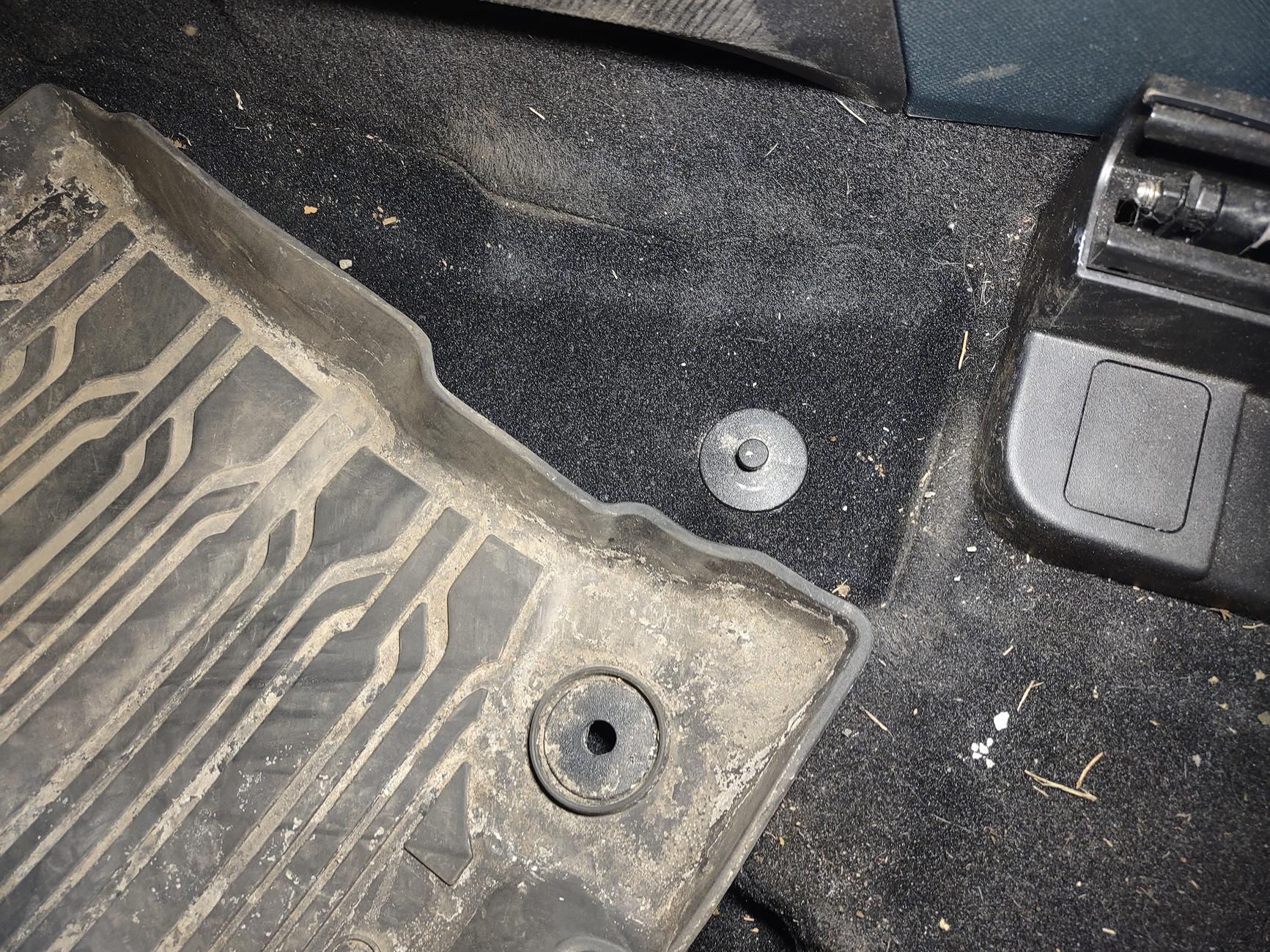

I need to clean the factory Ford all weather mats for cleaning.
I'm not sure how the retaining pins near the seats detach.
There doesn't seems to be enough gap to insert a tool to lift up the center to release it without marring the plastic and when I tried pulling straight up it lifted the carpet too.
Is there a trick to getting these out? I'm a little hesitant to just start yanking things on a new truck.

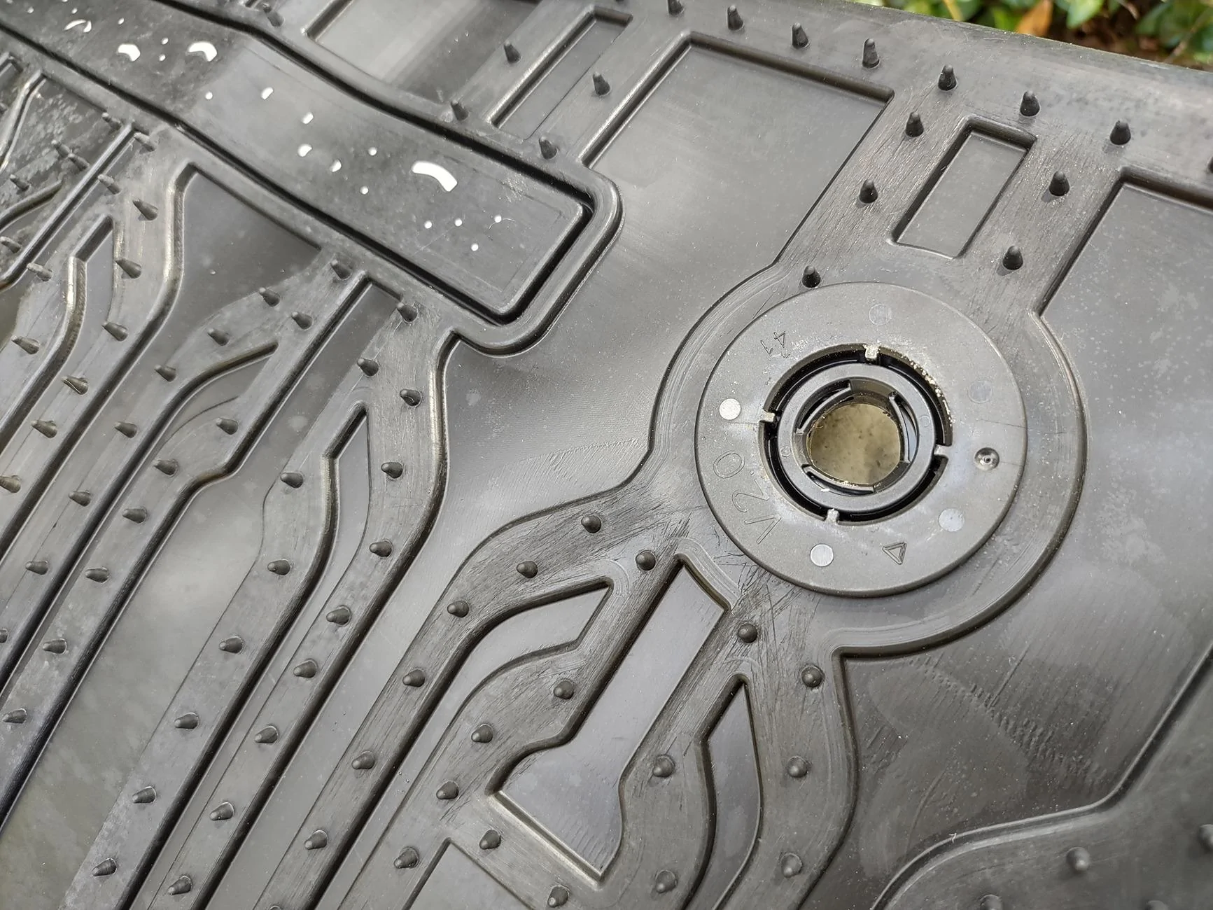

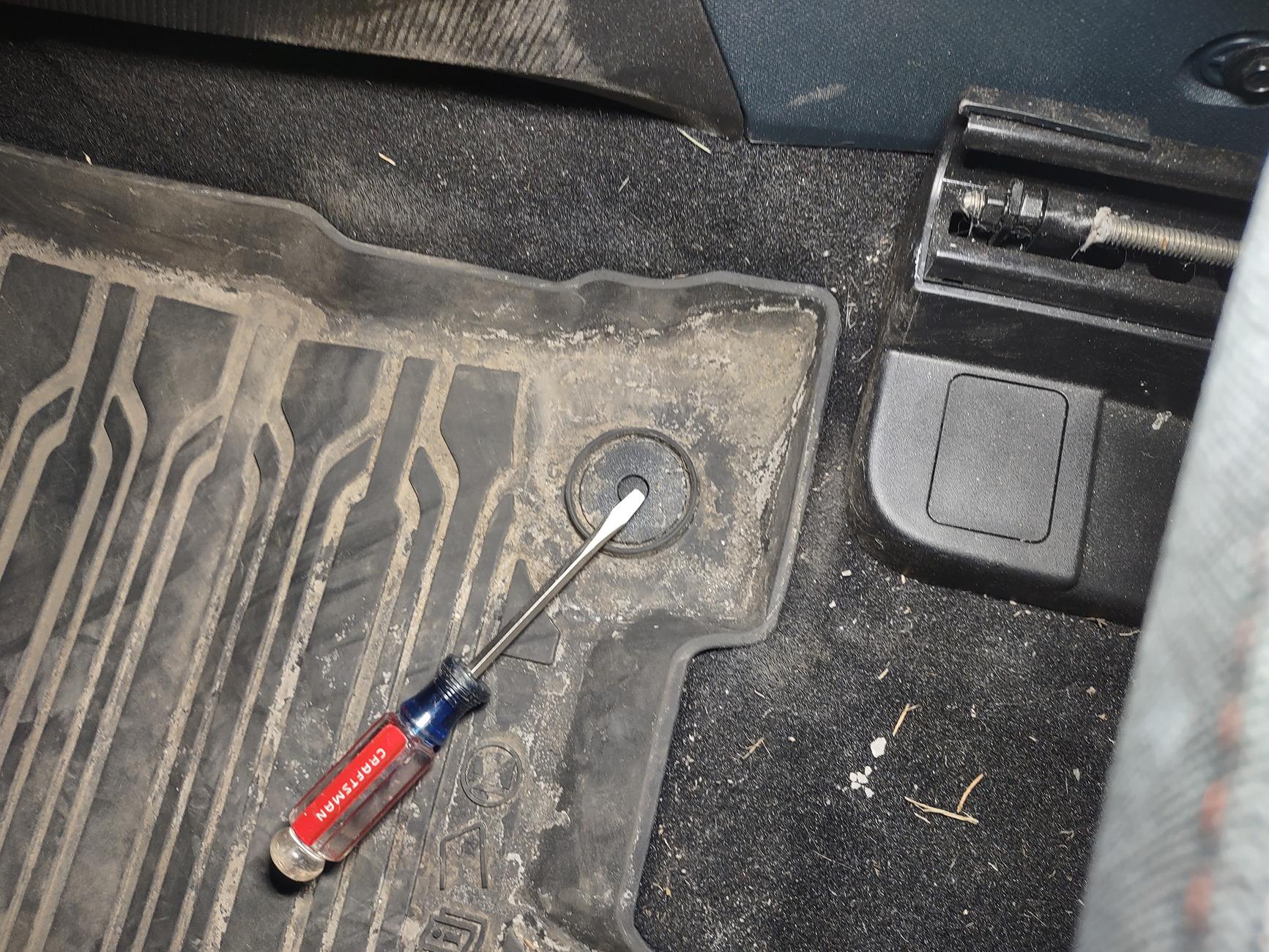

Press down hard on the center button while lifting up the mat.
I love this forum. Just the info I needed. I held the button down with a screwdriver and pulled the mat off.
