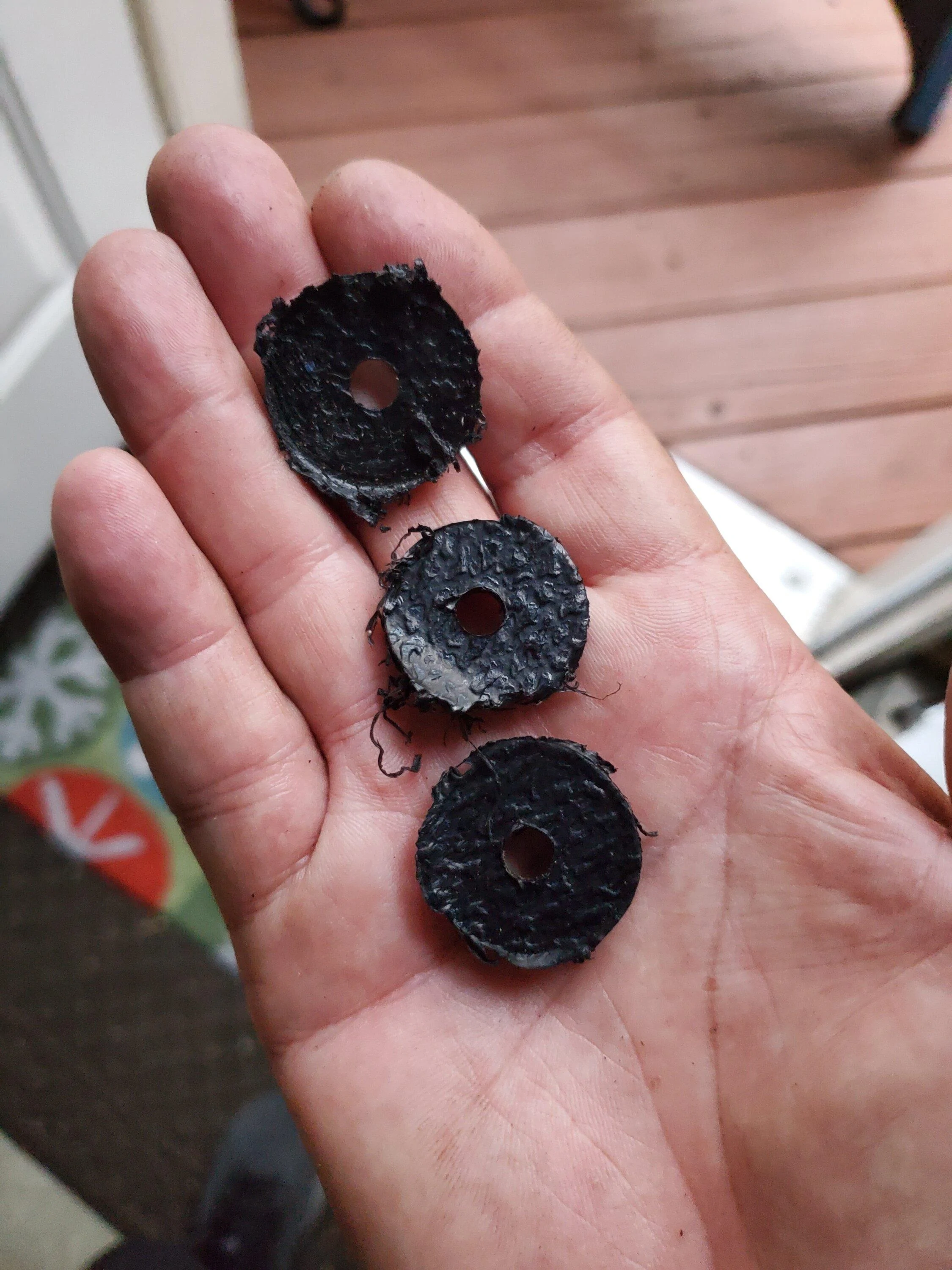

First tip.....When installing the drop in bed liner you use the hole saw to cut out access points to mount bed accessories and tie downs. Many folks will use the Home Depot method suggested by Ford and add extra tie downs that way. I am not committed to the Home Depot version yet. For now I am just adding additional D rings that will be used for " light duty ". Whats the tip you say??? Keep the hole saw cut outs from when you install the bed liner because they make perfect plastic stand-offs that you can install your D rings over vs installing directly on the bed paint. Someone in this forum had suggested Pringles lids for the same affect. See pic

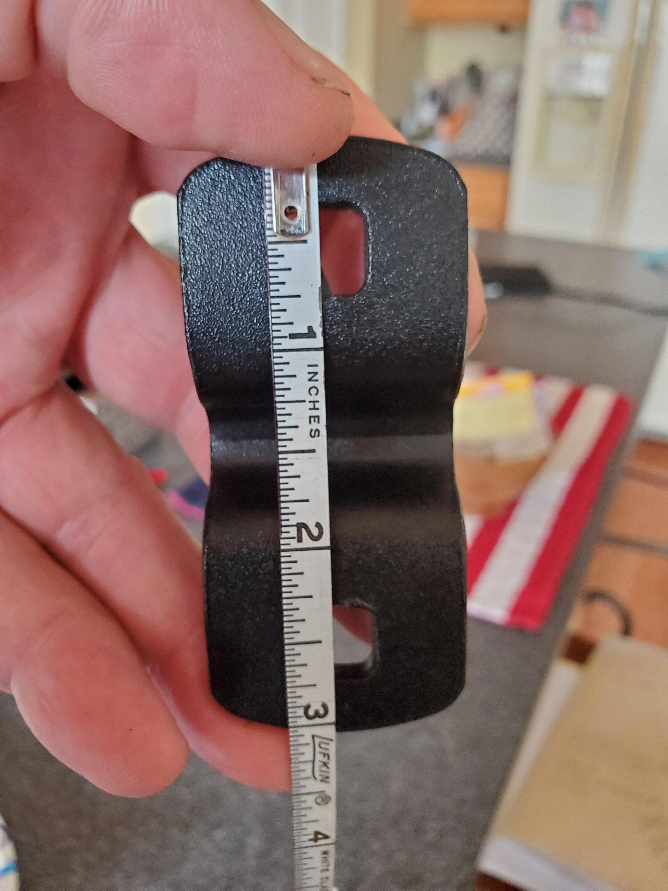

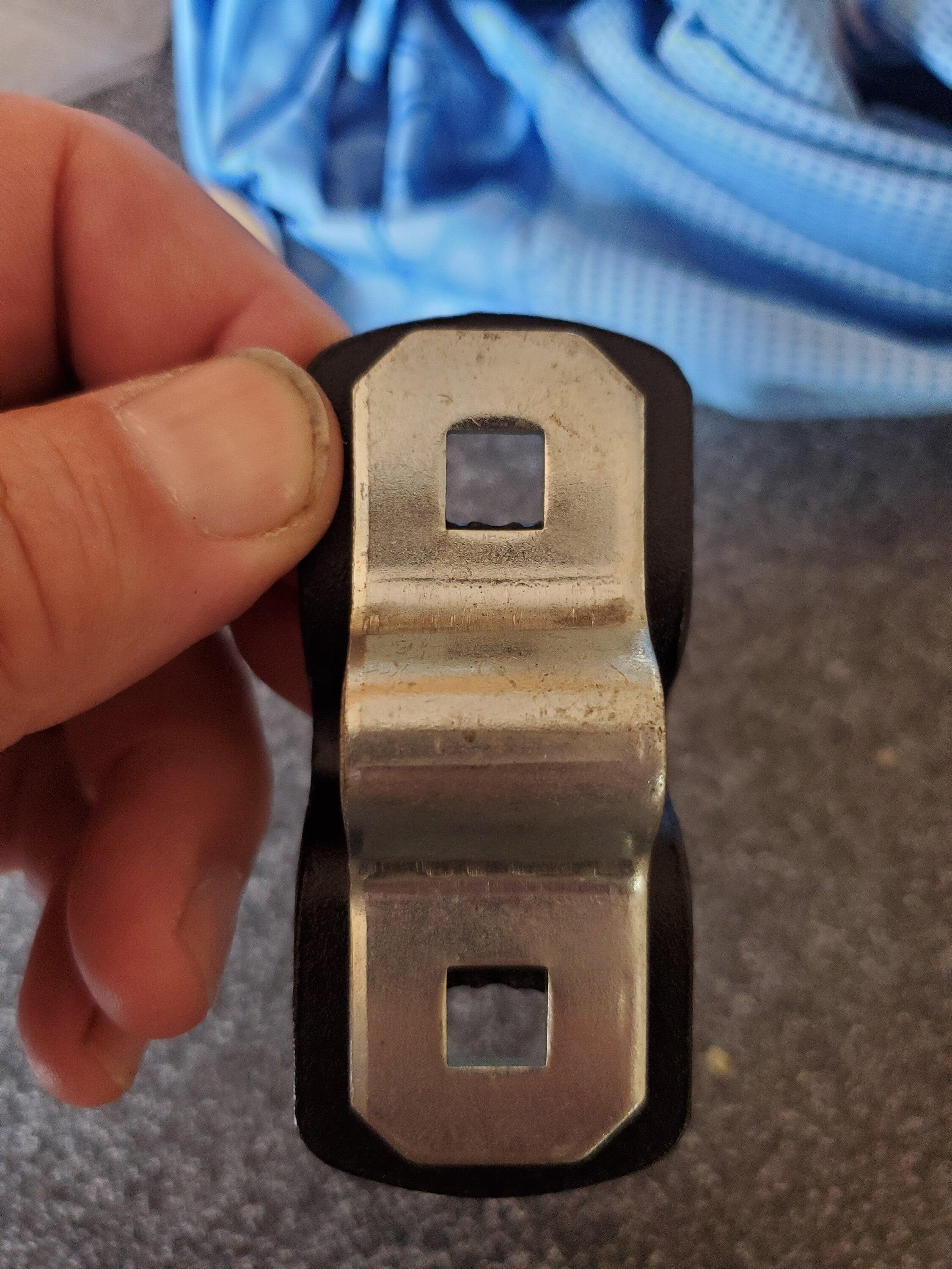

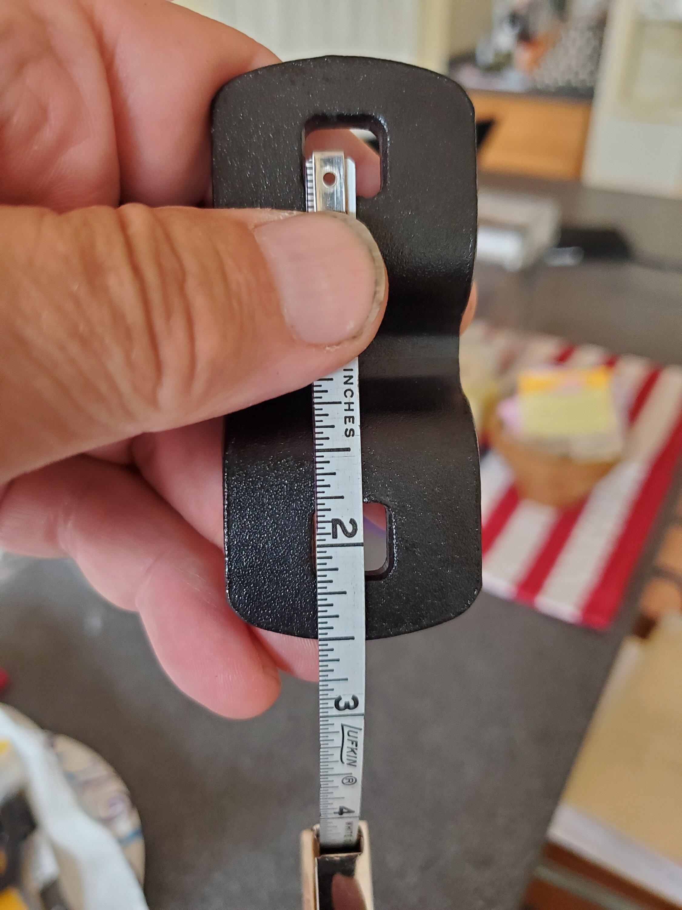

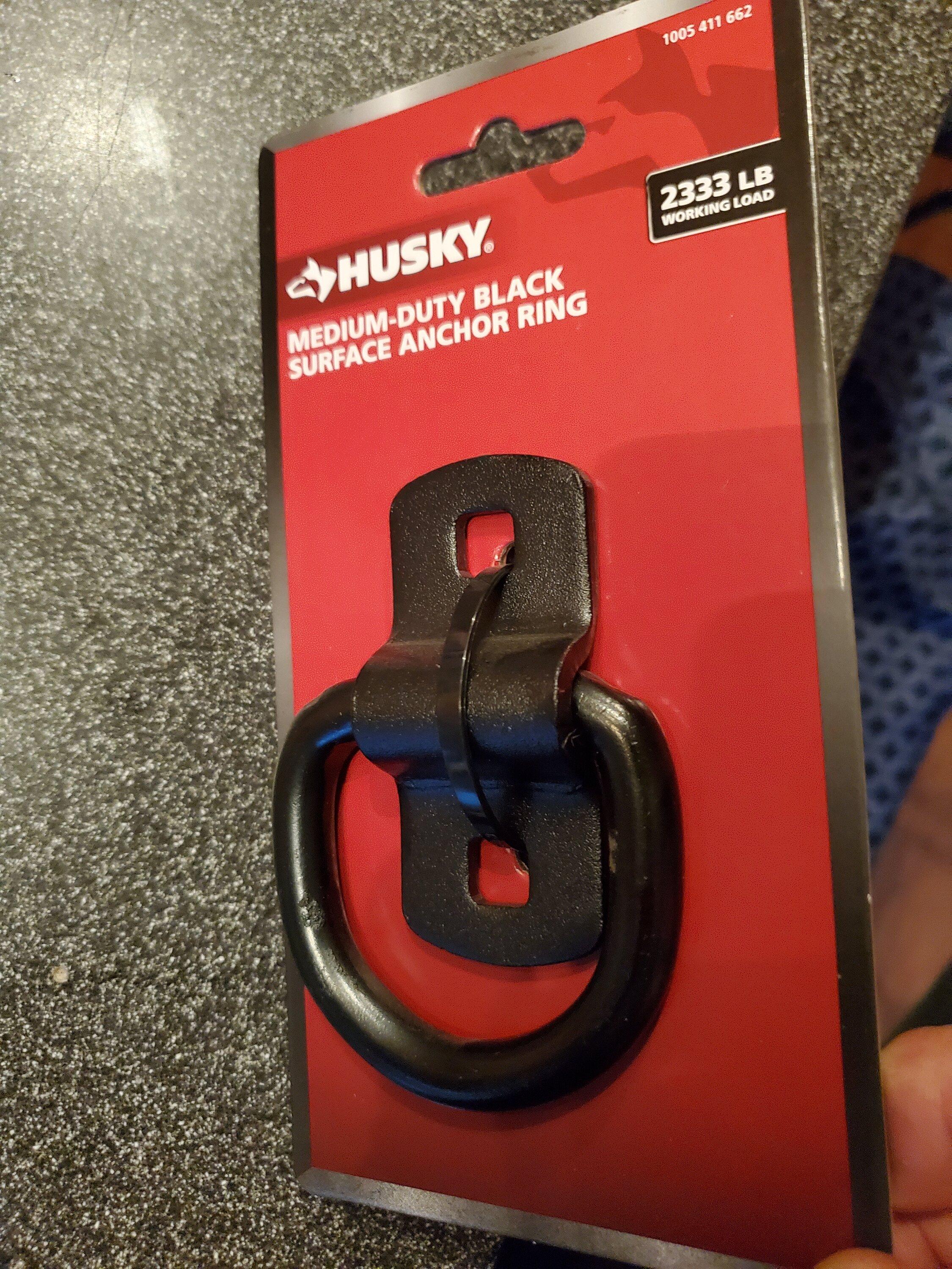

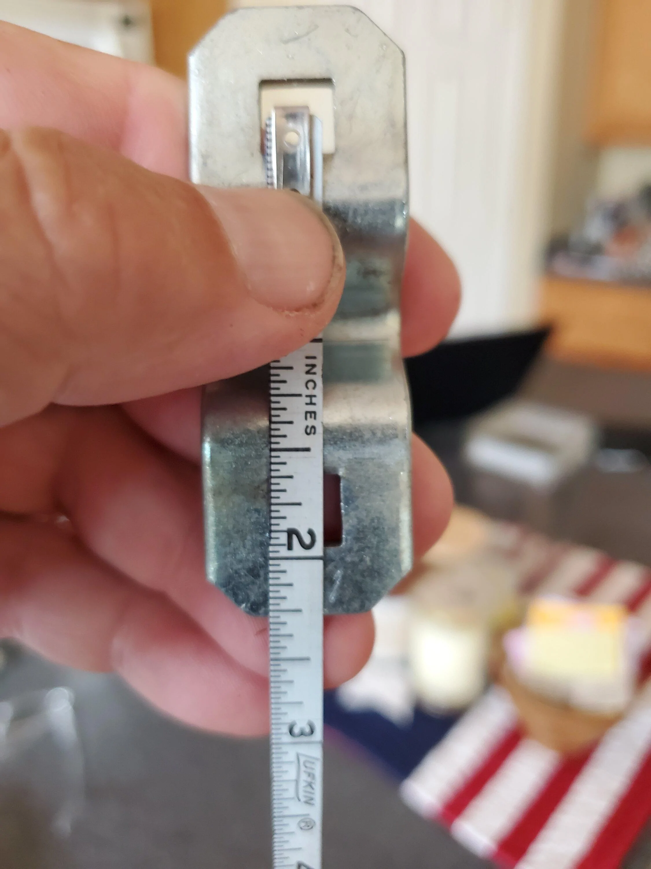

Second tip.......Well I have a plastic drop in liner and a bed mat so that's what makes this scenario work. If someone has already suggested this I apologize in advance. Dont use those wimpy tie downs for the two that are on the floor near the cab....use beefy tie downs from Home Depot. Normally they would stick up too much and get in the way but the bed mat creates a 1/2 spacer so it works perfectly. See pic of tie down.

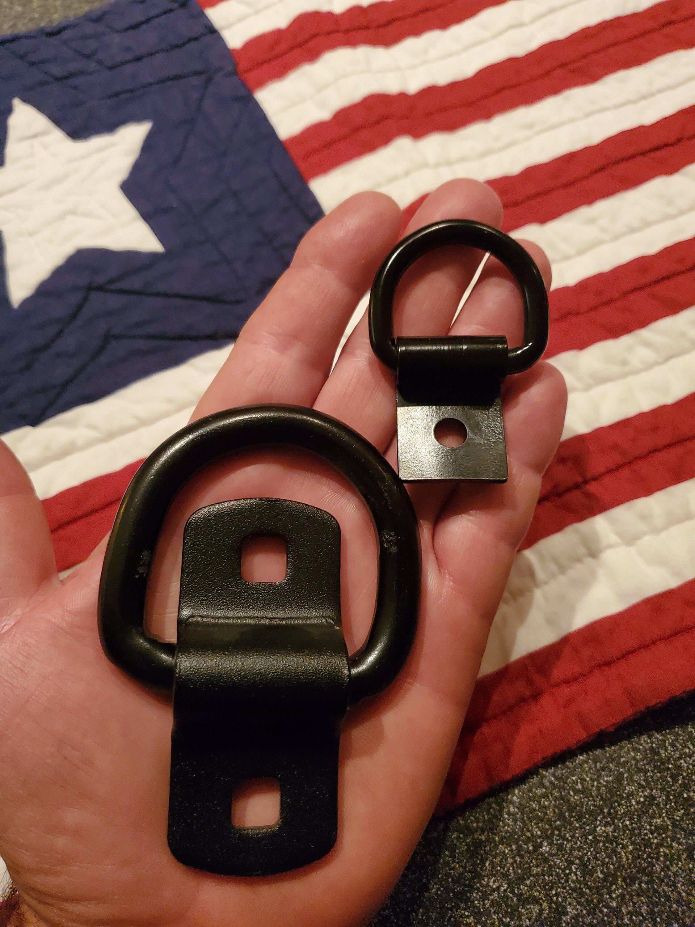

My initial thought is not to use the Ford Home Depot sliding eye bolt DIY project......my plan is to install a 32" heavy aluminum strip across all of the exposed holes and my D rings will be installed on top of the aluminum. The aluminum strip will cover up the hole saw holes and possibly add a little strength to the D rings.....I said possibly.

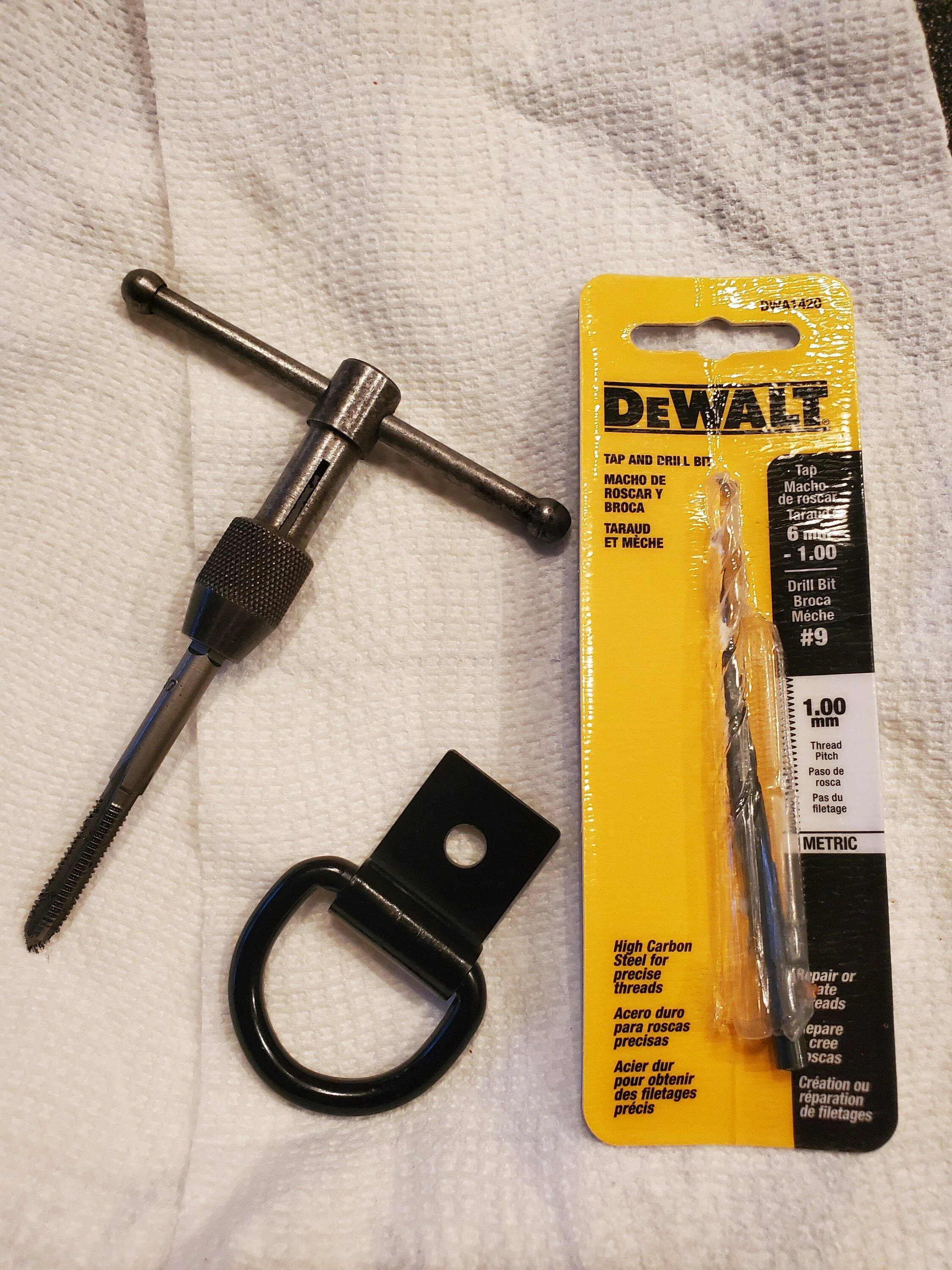

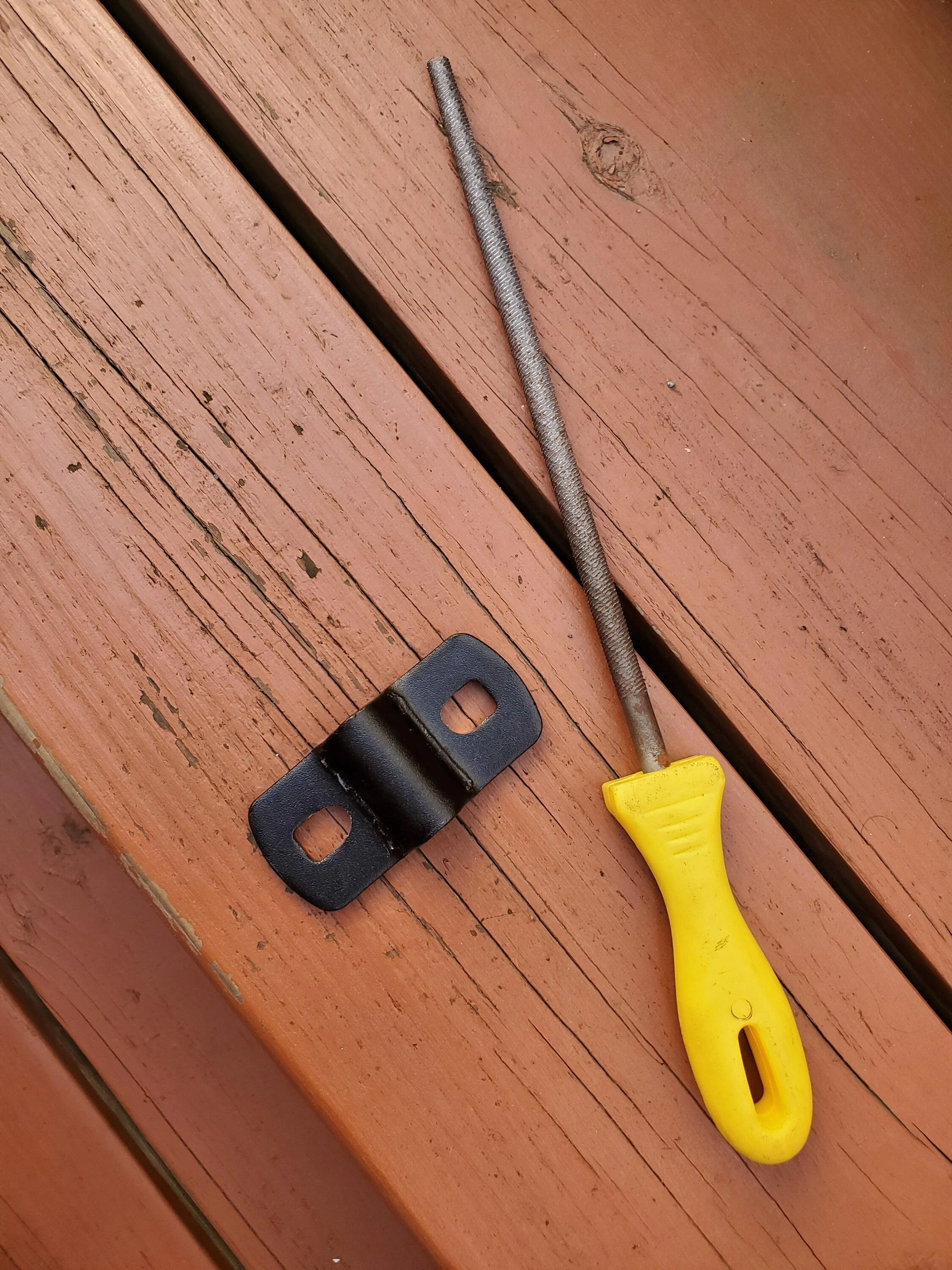

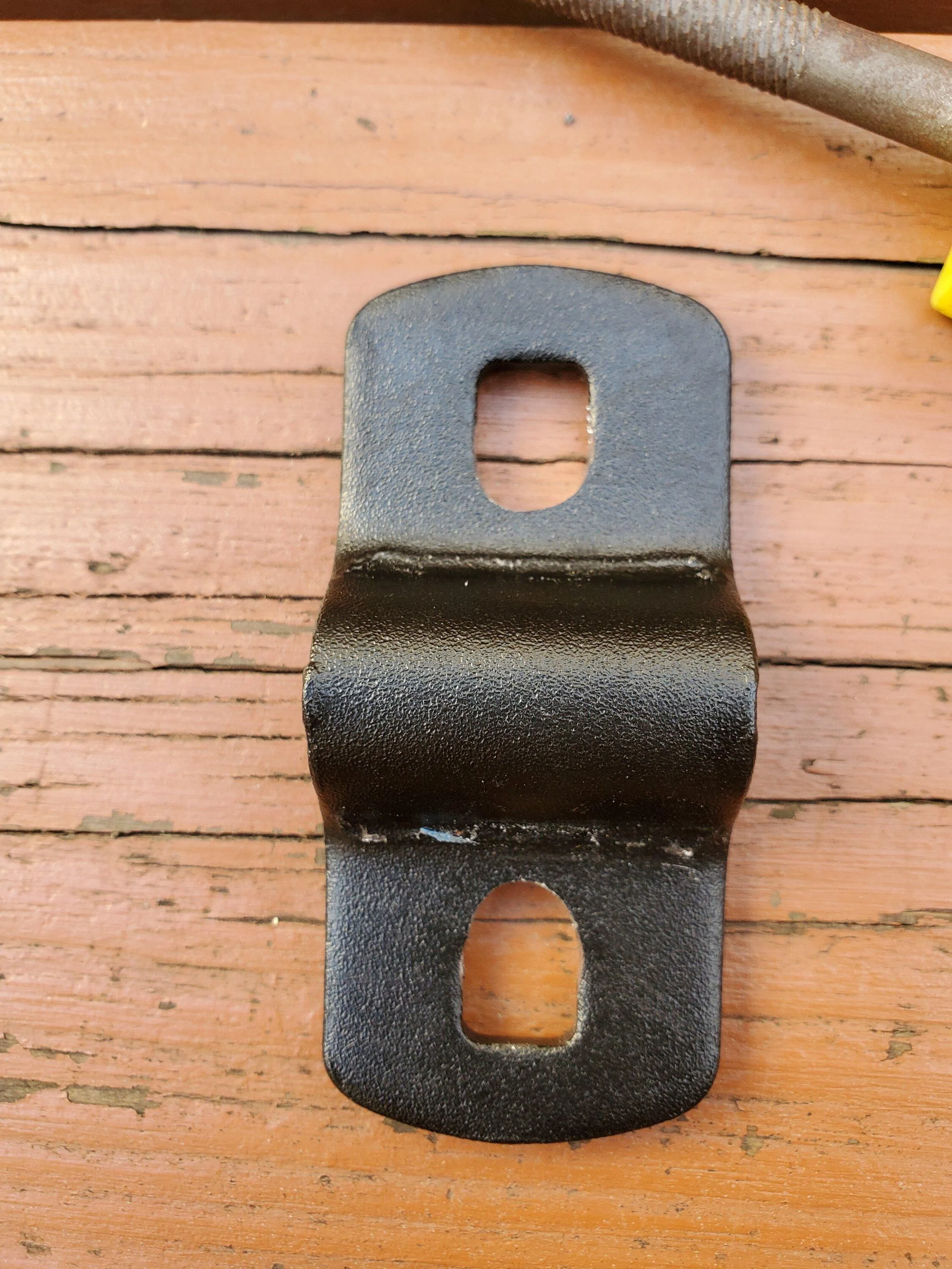

I am also adding the additional OEM style tie downs in the rear of the bed near the tail gate. My XL came with the lower ones but not the upper. I am sure u guys have covered this here before but I got the info from a YouTuber to use a 6mm tap for the top mount holes and a M6 bolt and this worked very easily and was a no brainer. I have yet to finish the install of the beefy D rings on the floor of the bed but I hear those are not as easy to tap.
I should mention....these beefy D rings will need to be drilled out just a little bit so the floor holes line up.
