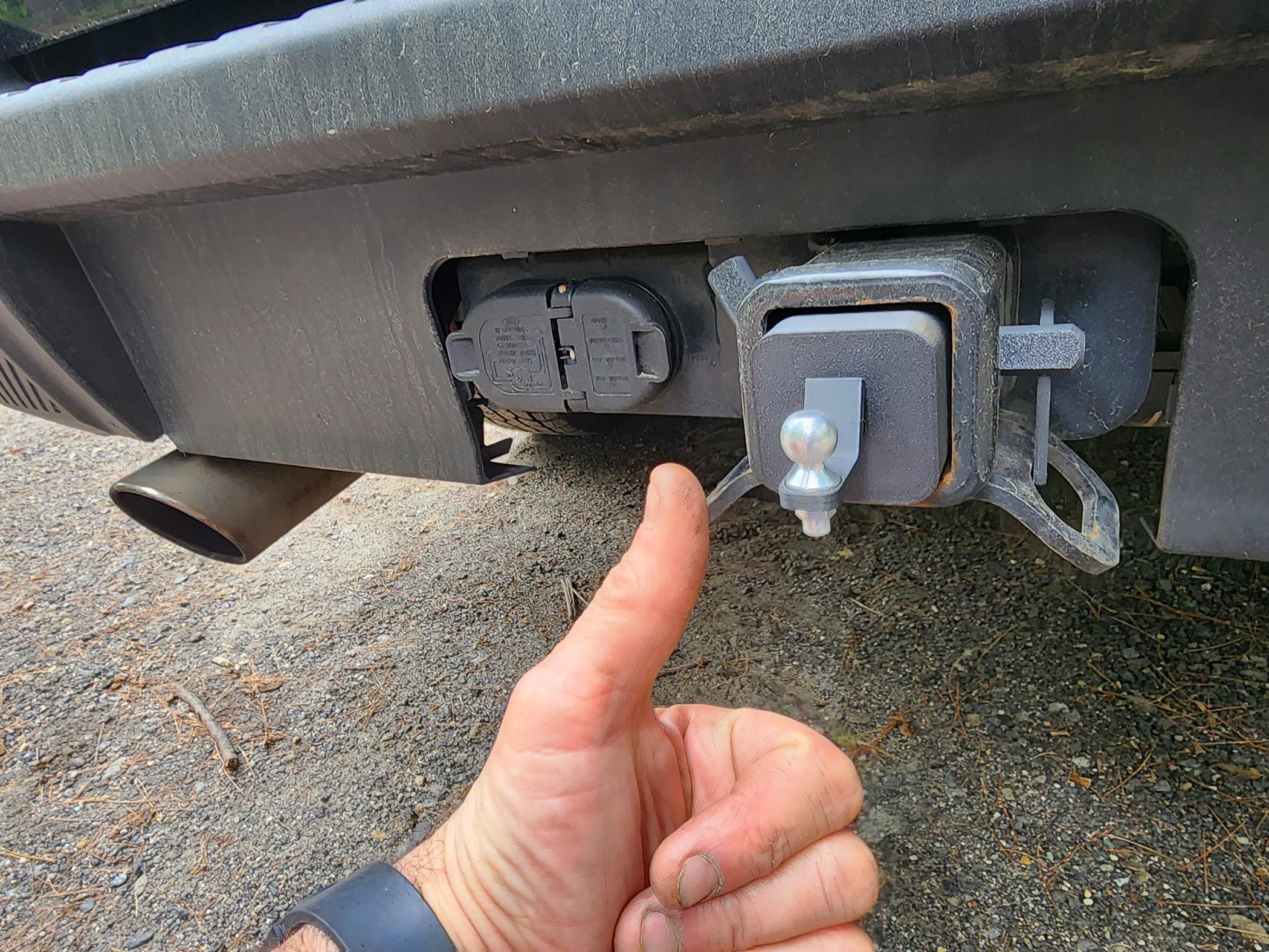

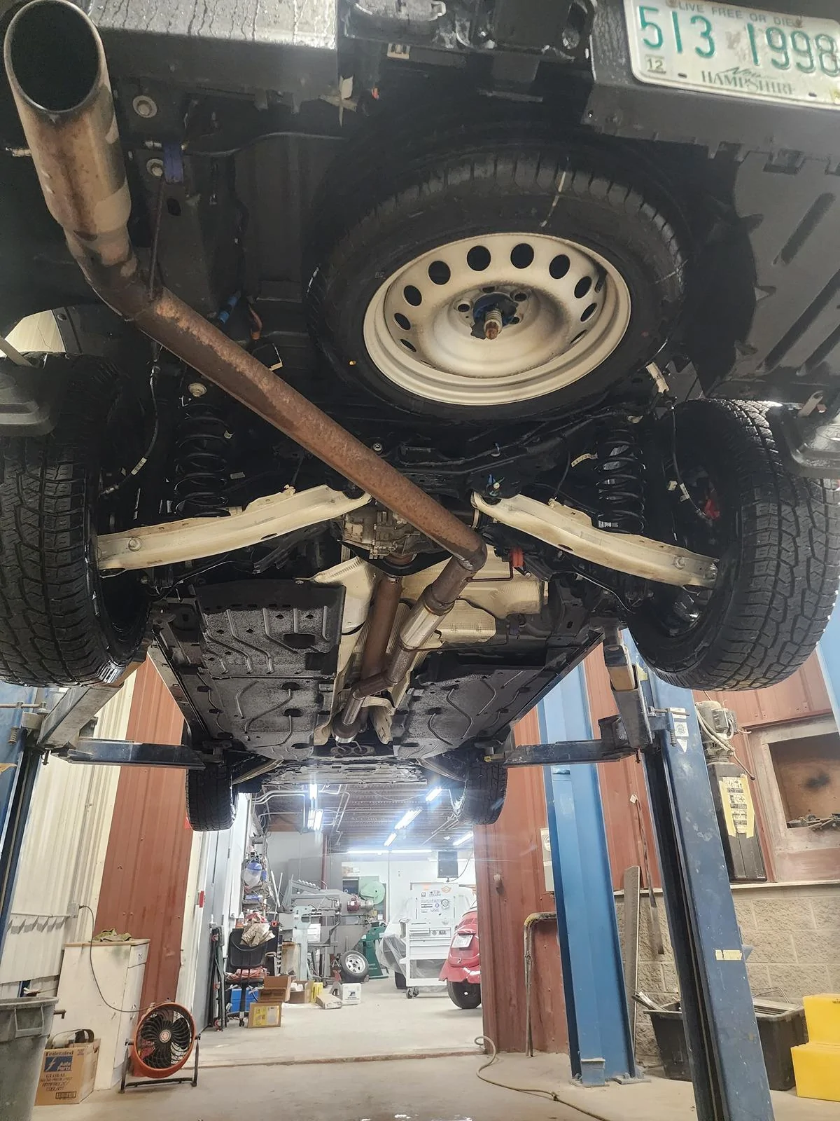

It gets hot back there when towing. I built a 3" exhaust and exited it a little past the plastic bumper. Haven't had a problem since.
