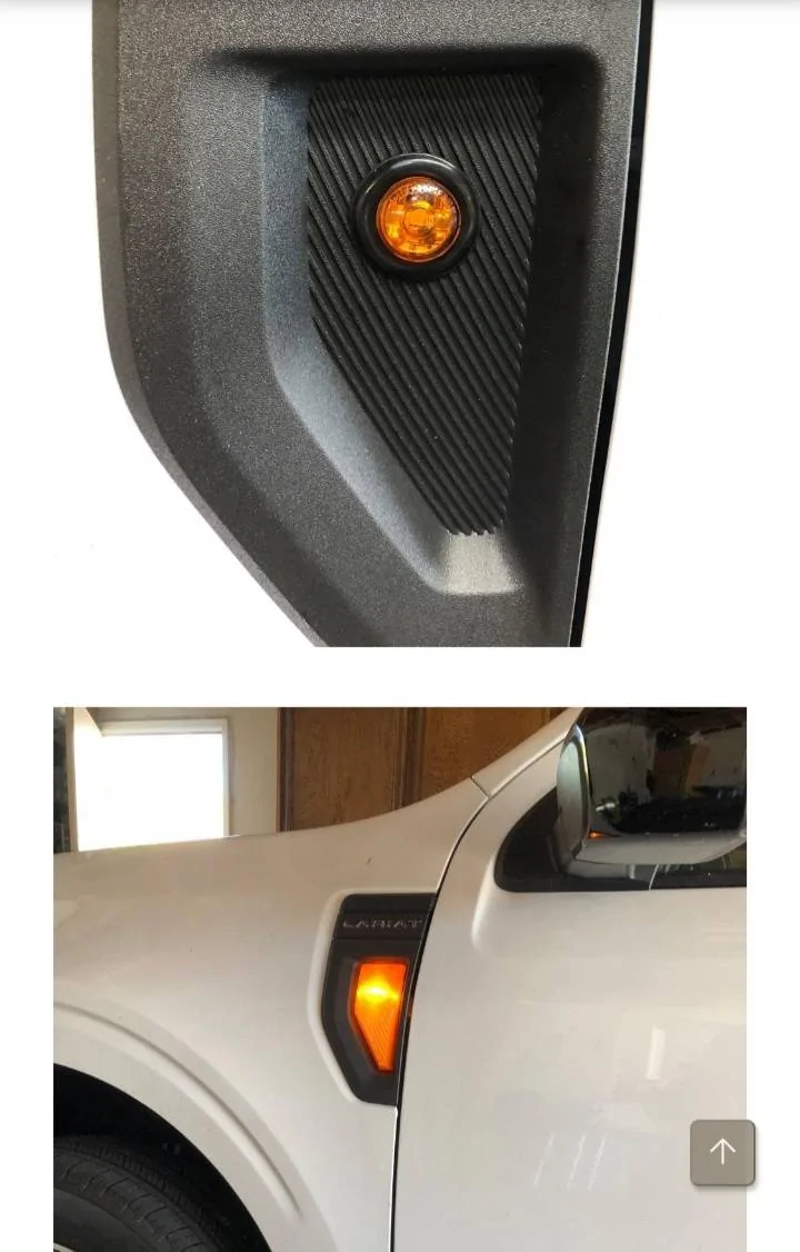

I wonder if the lights picture below would work for the side markers?

Checked with a local garage and they will have to add amber lights in the back. No OEM parts from Ford :( The pics you posted are actually kind of where I was thinking! The garage here agreed that those side markers would suffice.

There have been writeups on how to wire a side turn signal to the plastic with the trim marking (right in front of front doors).
