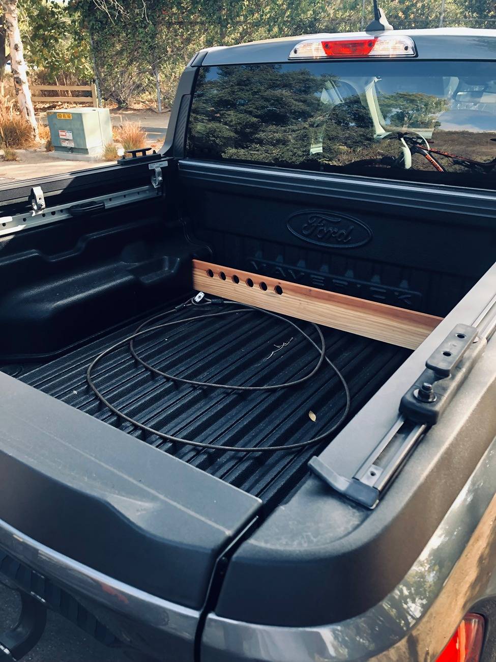

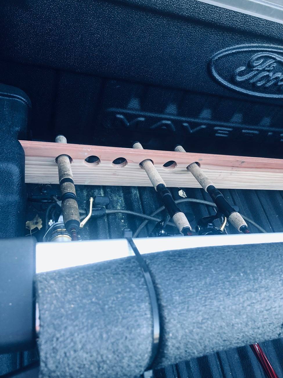

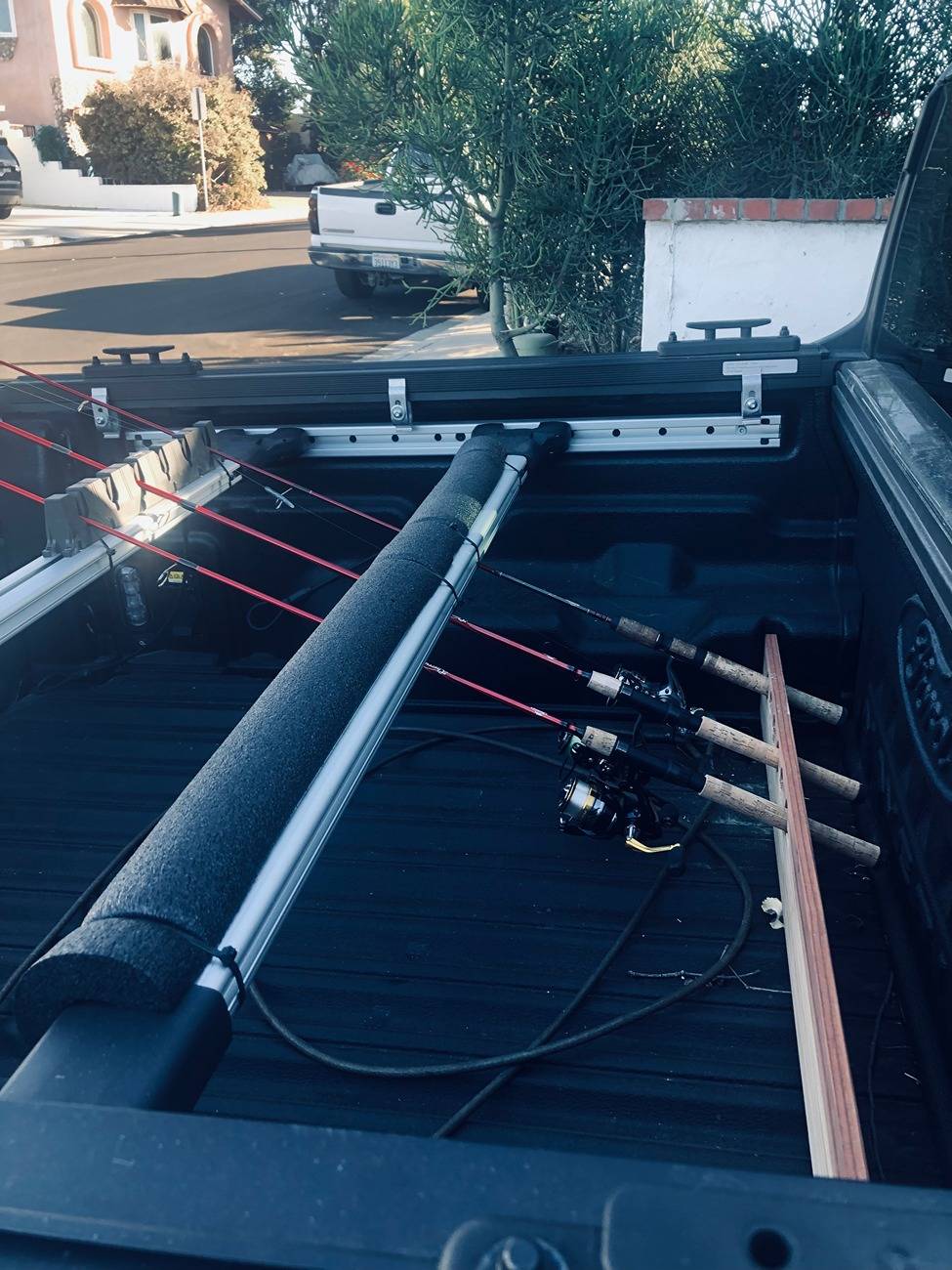

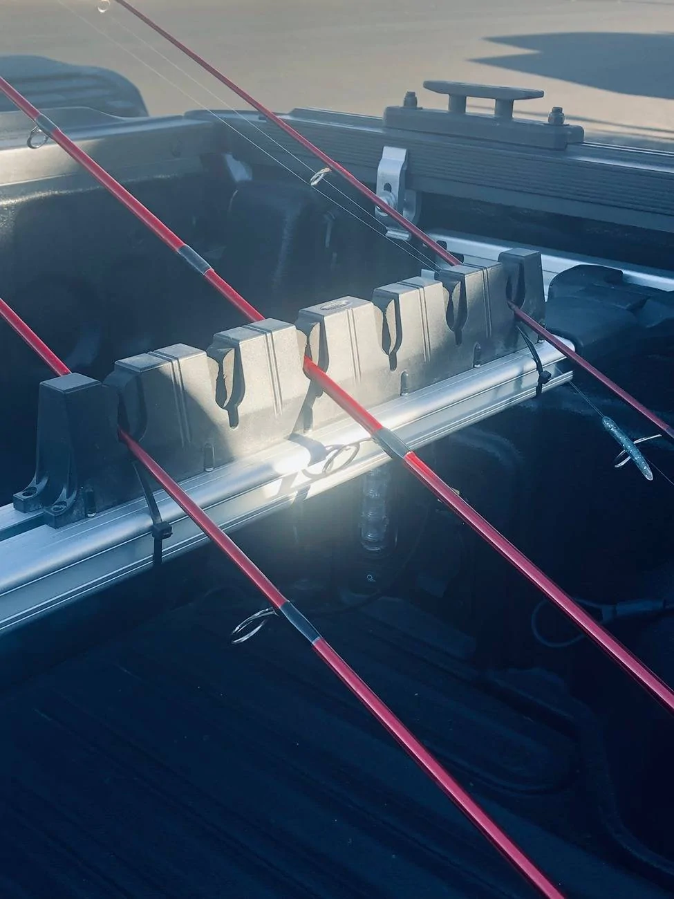

Last minute fishing pole rack - worked out pretty dam well on my trip up HWY 395 for end of trout season in NorCal eastern sierra's . I took down the pole rack I had in my garage and attached 1 end that had the rod fastener and zip tied it down onto my 'Ford' cross bars, I nerfed padded the other cross bar again using zip ties.. I used the bottom section of pole rack to mark out the spacing on a 1x5 redwood plank I had sitting around. Took a drill mounted 1 1/2 inch barrel sander and reamed out the holes at a slight angle Upward on one side and downward on the other side.. All week end my buddy and I were popping our poles in and out while hitting up various fishing spots. really seemed secure, (Albeit, a locking system will be better but that's not in the budget right now).I ended ordering another wall mount set to replace the one i used on my cross bars.
