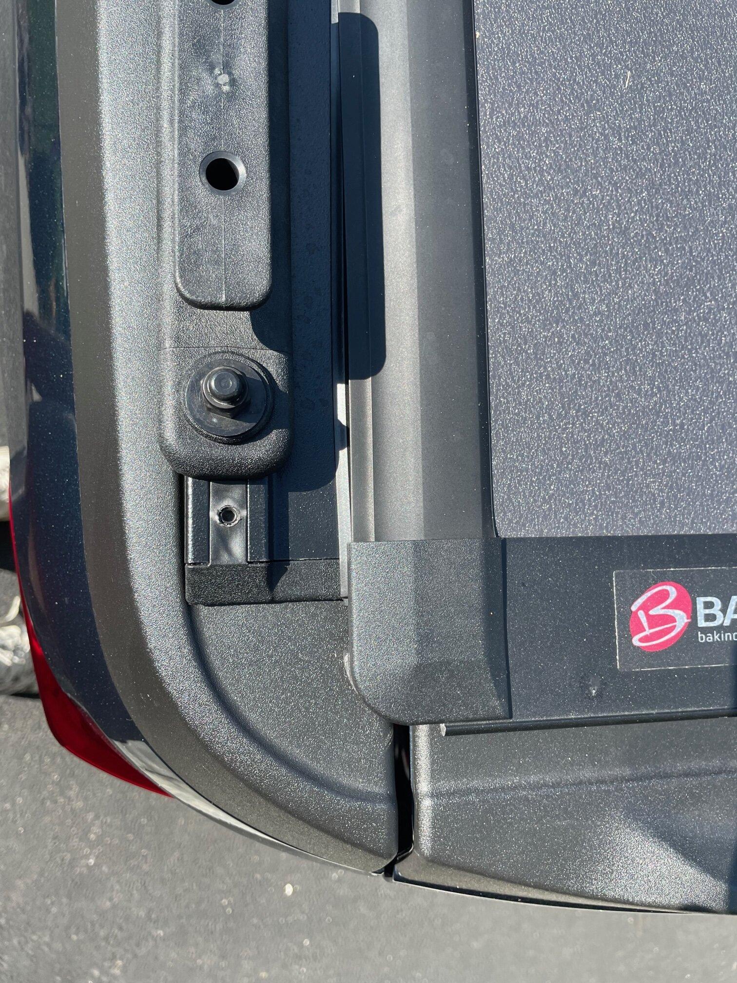

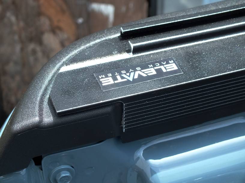

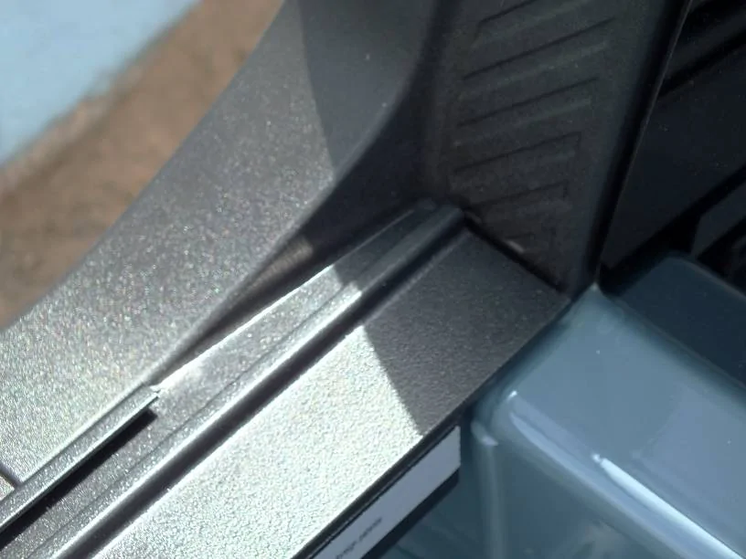

Here ya go.
Again, these are the 56" Elevate T-slot rails for "compact" trucks (RealTruck #TRX-1118329).
Ford Maverick Elevate rails length Elevate Front
The length is just a tad short of "perfect" for the Maverick. I shaped the top to a constant radius that approximated the truck's trim close enough, and milled off the unusable portion of the T-slot. I should have done the same thing at the front, I think.
Ford Maverick Elevate rails length Elevate Rear
I made my own folding ladder rack that attaches to the T-slots and works pretty well.
I had a lot of troubles with the T-slot bolts provided by Truxedo, so I used these M8X30 T-slot bolts from Amazon instead.

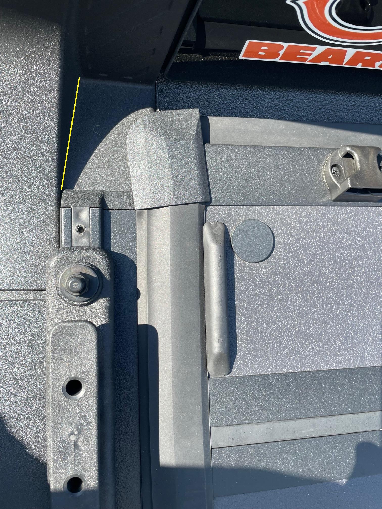

Here ya go.
