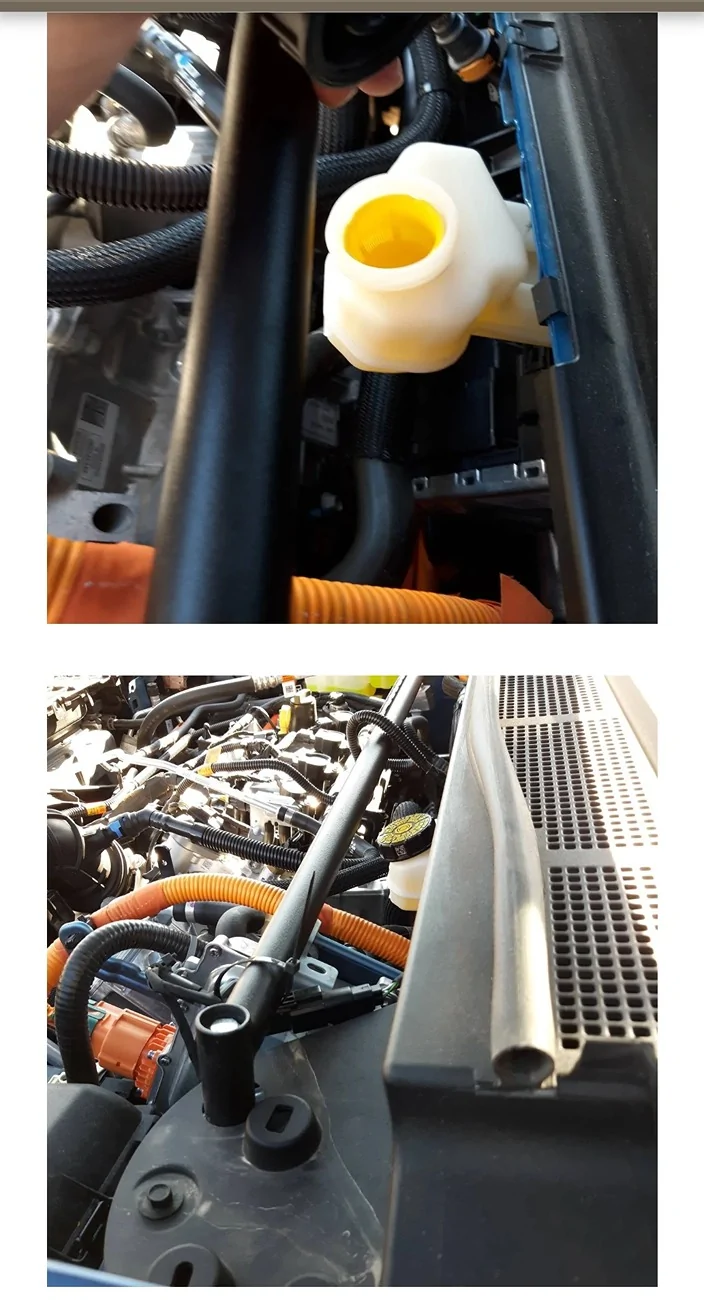

Here's a picture of mine hybrid with the steeda brace.

Glen I see that you have zipped tied the connector in place out of the way of the bar. I do not know how to remove the connector from its bracket. The connector went where the slot is on the bracket of your truck. thanks for showing the lower picture. Tom
I didn't have to disconnect anything. I put the wire tie onto the brace after it was in place.

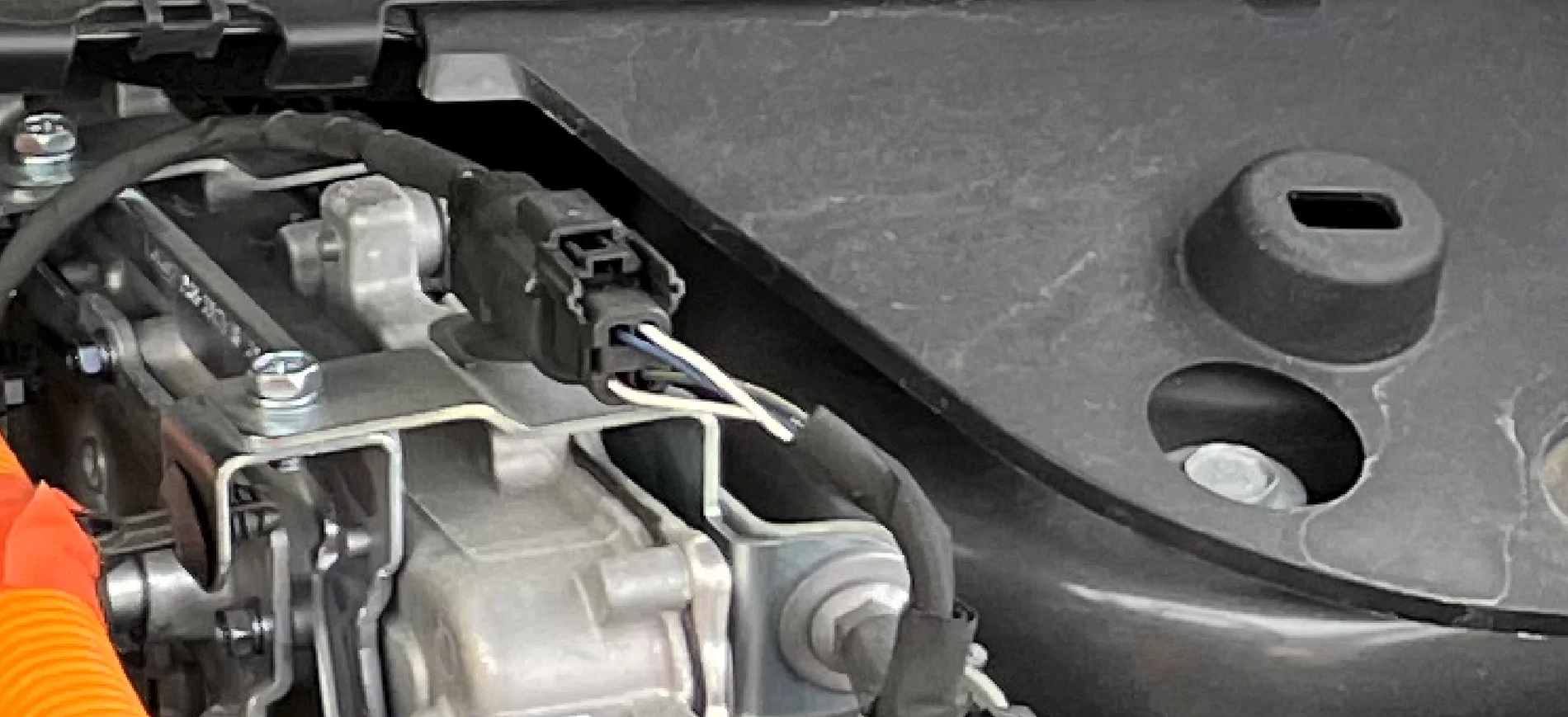

Glen my connector is mounted in the slot that is empty on your truck
I'm not familiar with that setup.
Can you shoot a quick picture of it.
That way we can actually compare the two side by side so to speak.

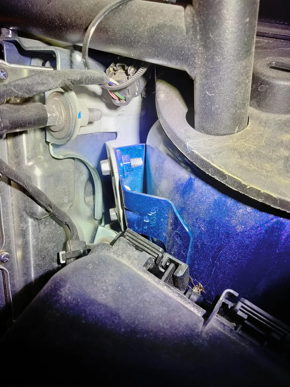

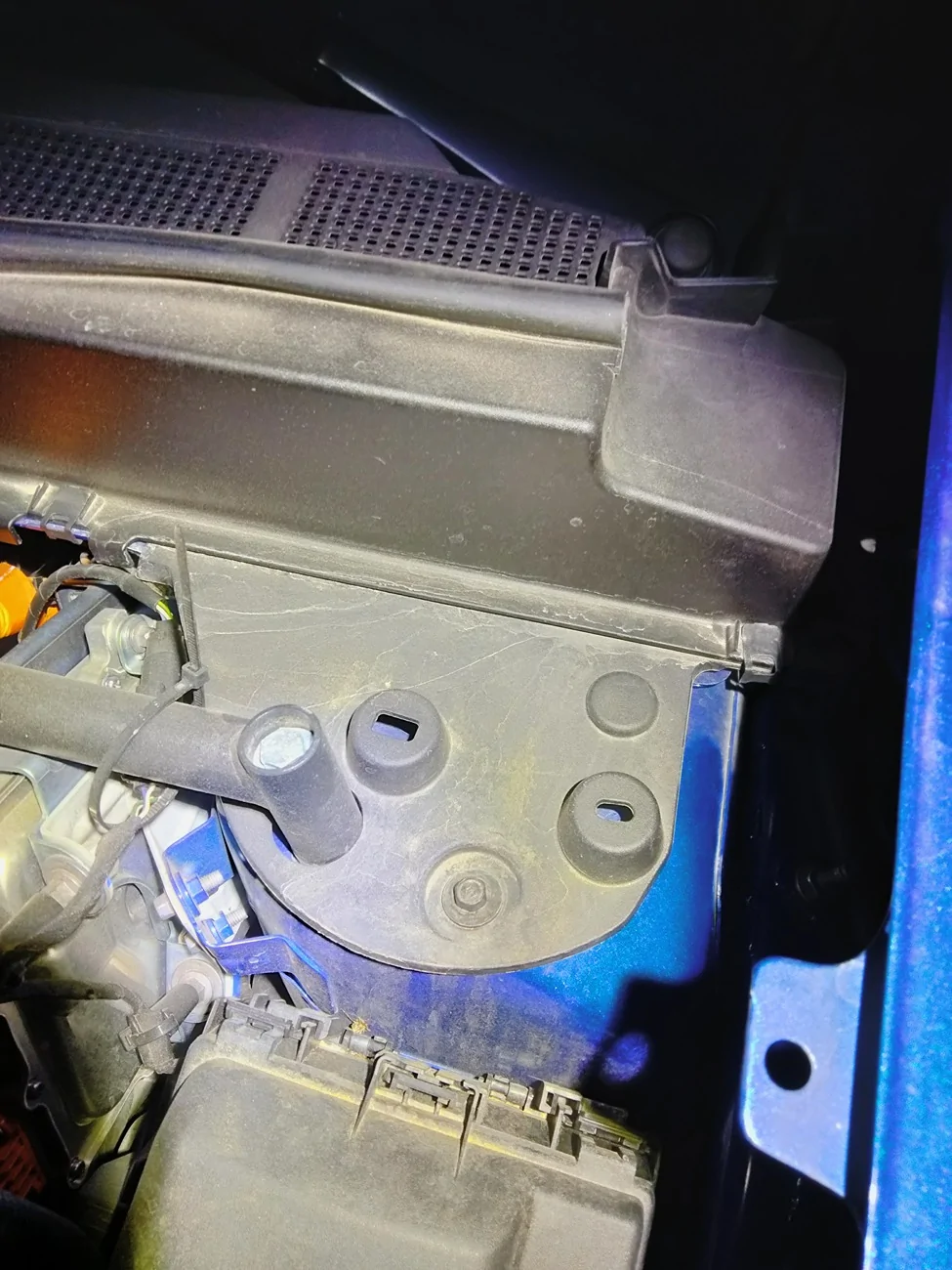

I'm at my truck now taking a picture. I'll upload it here.
What brand of strut brace did you get?
Ford Maverick electrical connector. IMG20260508185157
Ford Maverick electrical connector. IMG20260508185257

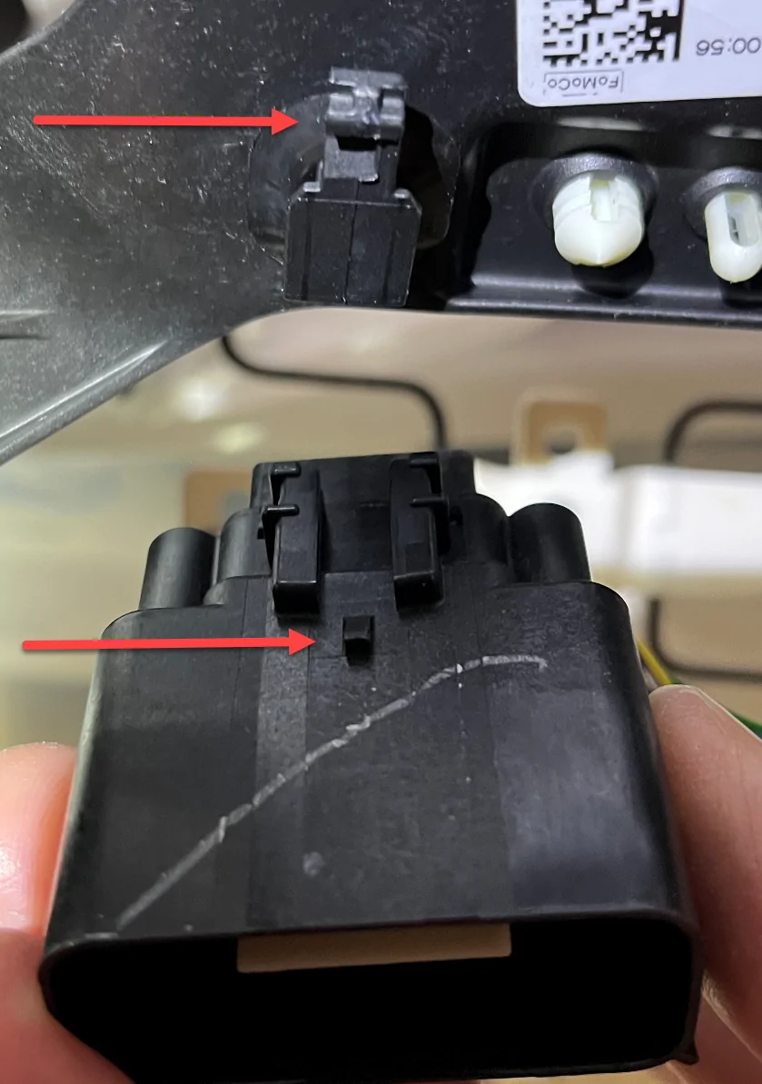

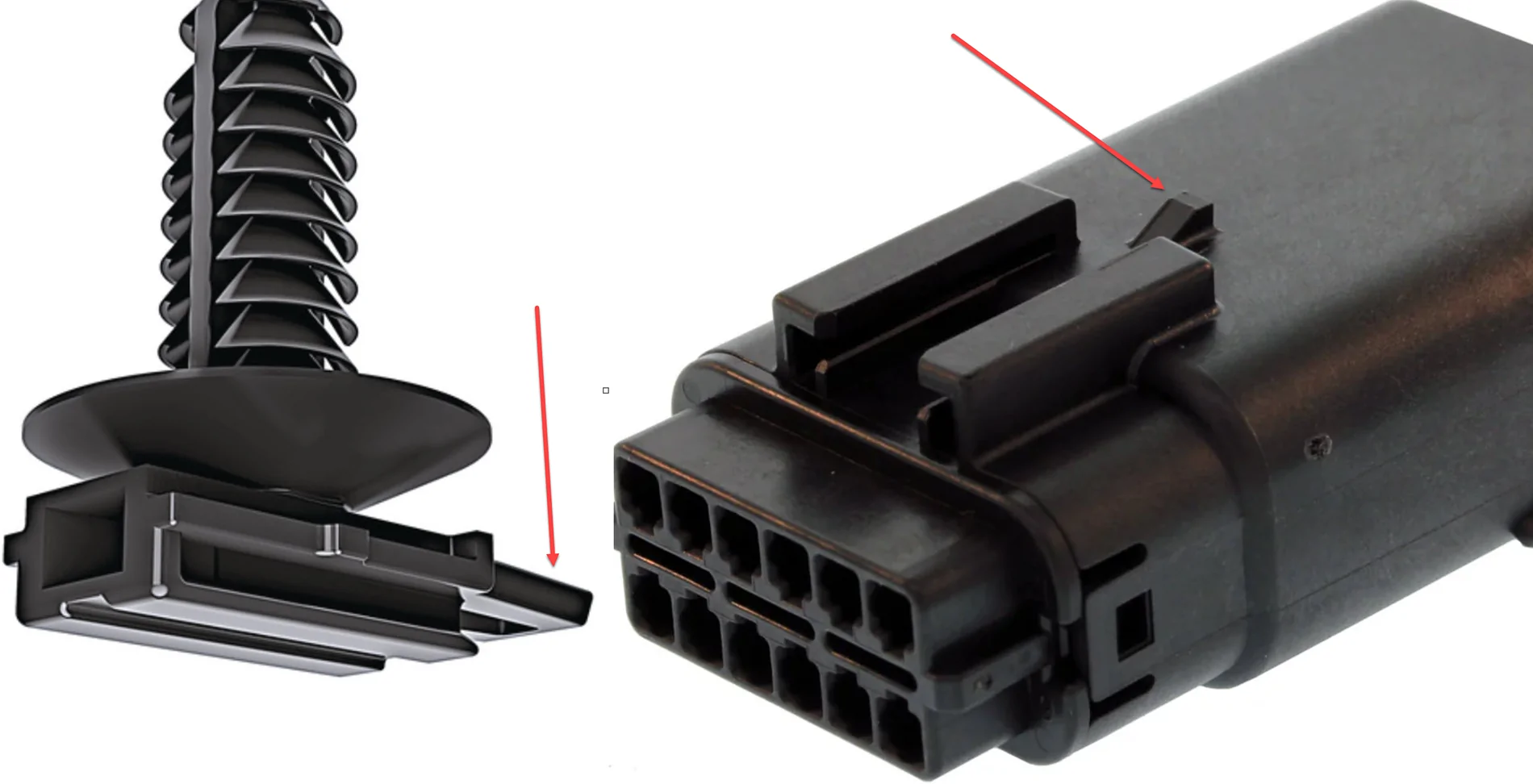

The Molex connector has a clip rail with a shark fin that hold the fir tree clip in place.
So have to pry up the clip part that locks onto the fin.
Helps if the connectors are disconnected from each other.
Or work the fir tree out of the hole if can't get to it.
Clip to connector is something like this:
