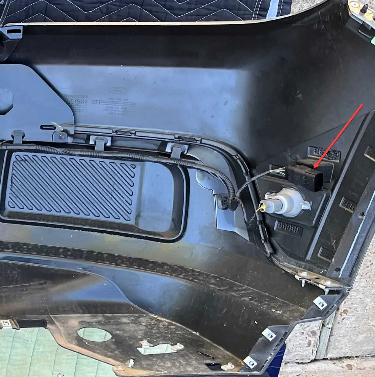

Has anyone else been experiencing issues with their driver's side marker light? Mine's been burnt for a couple of months but even with a new bulb and harness direct from the manufacturer, it still doesn't work. Granted, I was involved in a minor car accident in late December but it was the passenger side that got hit, not the driver. Ironically, the side that got hit the marker light worked just fine but yet the driver's side that was untouched burnt out shortly after. I'm not sure if it's related to the accident or if it's just coincidence. Just curious if this is an isolated electrical issue only mine has or if anyone else has experienced the same thing. I will appreciate any feedback.

Don't recall any issues like that posted before but that sure doesn't mean there weren't any. My guess is it a wiring issue somewhere probably related to the accident 🤷‍♂️

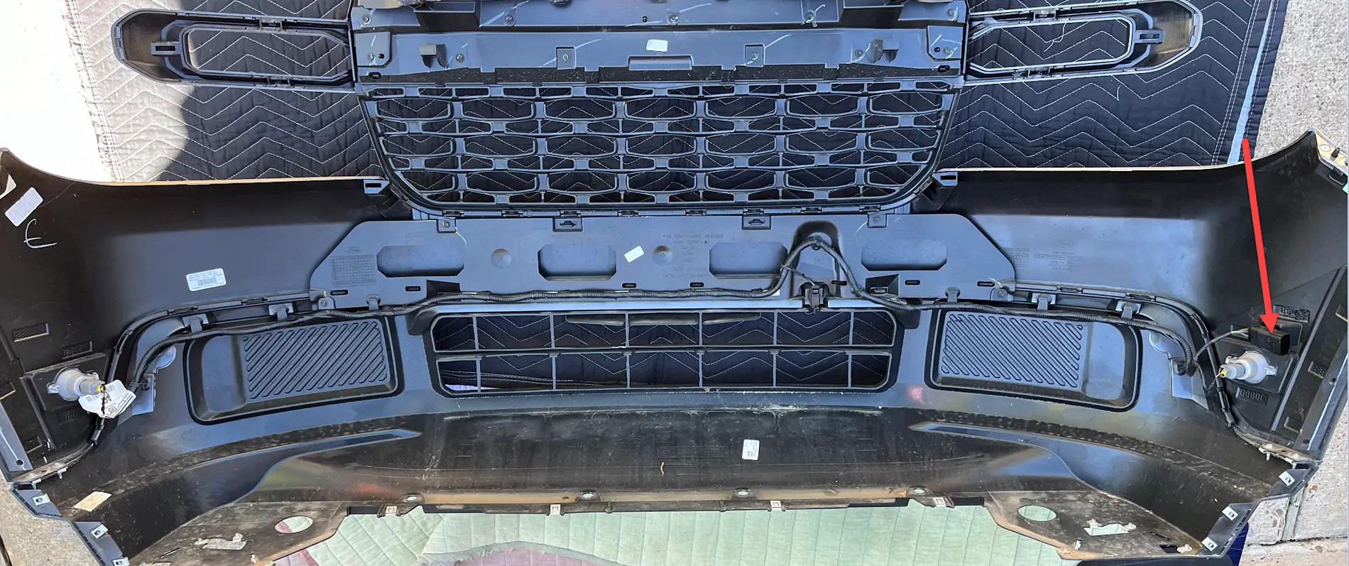

The front marker lights and the ambient air temperature harness is fed from connector that's just in front of right wheel well. Maybe or not related to the accident if the harness feeding that had some damage?
