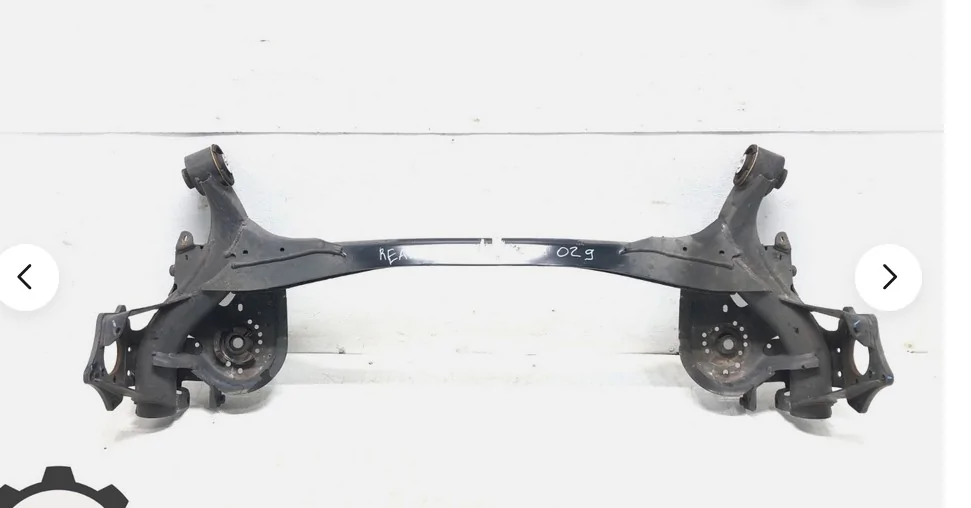

Couple years ago there was more than one thread RE: "Alignment issues" at least one had custom modifications for rear end alignment if I remember correctly. I'll see if I can find it???

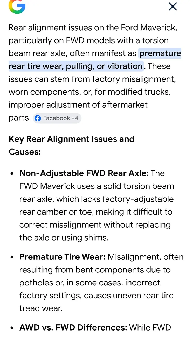

Seems like some people on Facebook are having the same problems with their Ford Maverick.
You may want to check Ford Maverick on Facebook.
Ford Maverick Drifting & Tire Wear Maverick Pulls Screenshot_2026-02-07-18-51-53-29_40deb401b9ffe8e1df2f1cc5ba480b12
