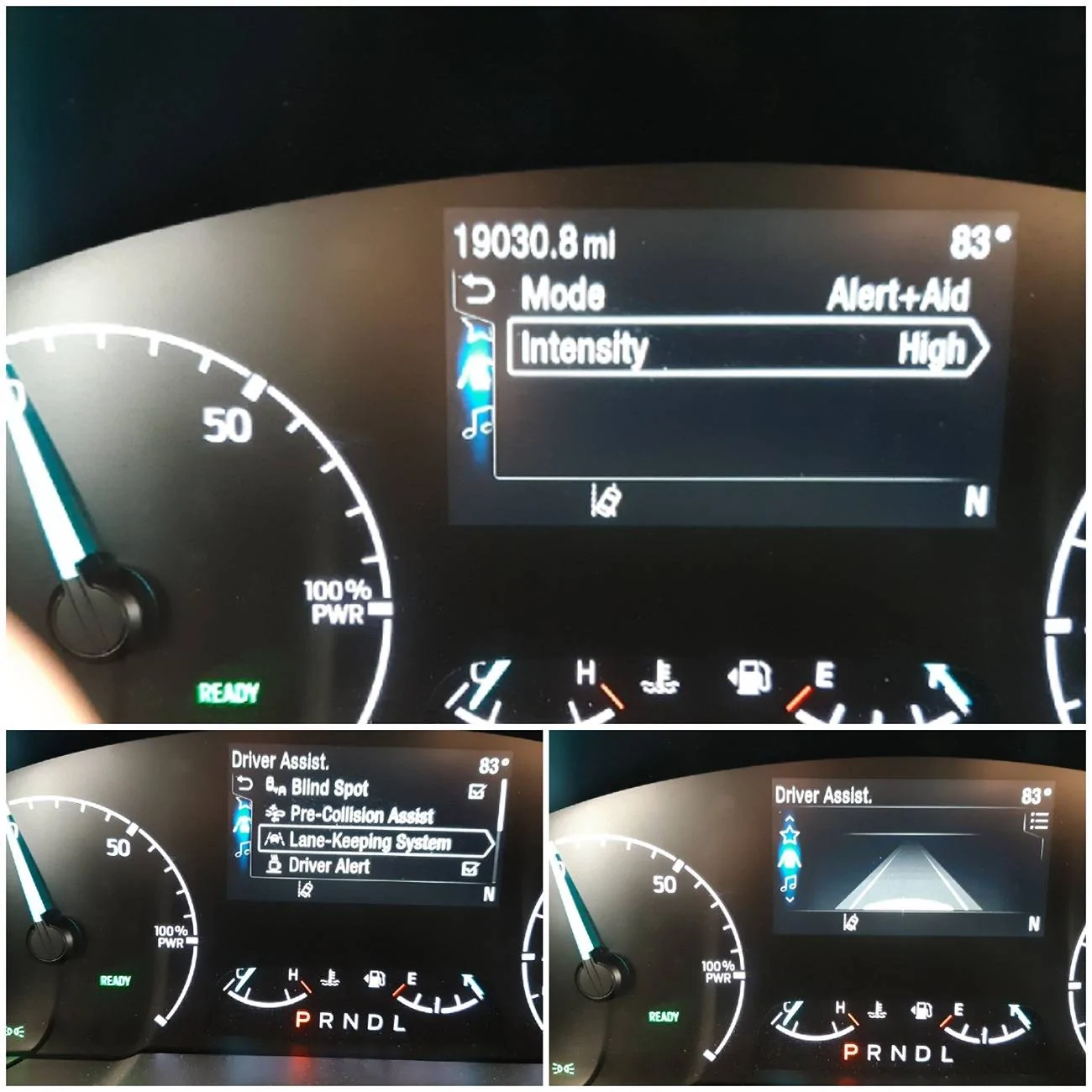

Does this thing really work? I have it sent to High Sensitivity, then intentionally drift out of the lane and nothing happens. Am I missing a setting or something?

Are you sure you have the sensitivity set to high?
Driver assist Lane-keeping is an on and off feature. How did you turn it on?
I asked because....
Lane-keeping uses intensity.
It is switched on and off by the button at the end of your turn signal stalk.
Ford Maverick Does Driver Assist actually work? 20250531_111735

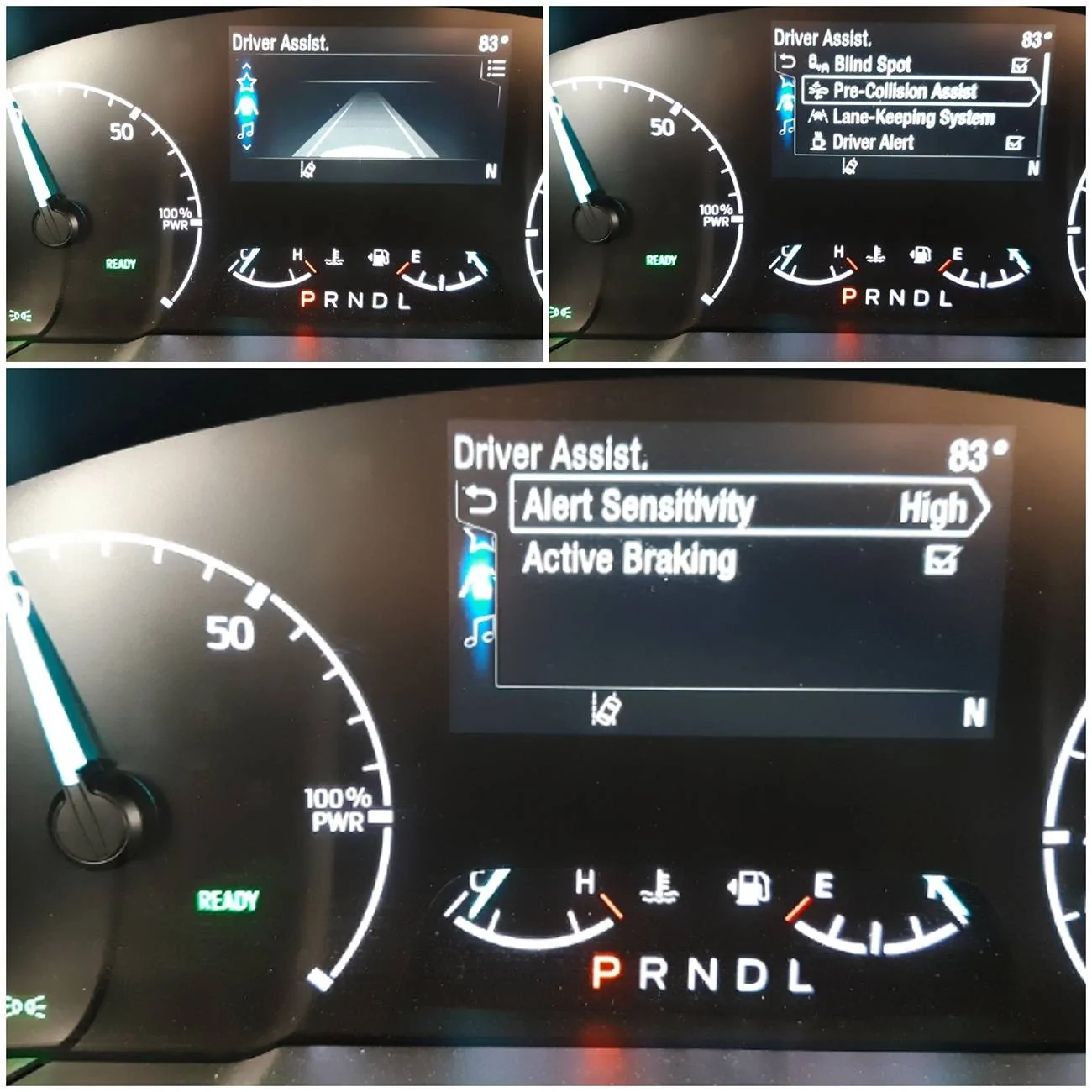

Pre-collision alert uses sensitivity.
Ford Maverick Does Driver Assist actually work? 20250531_111638
