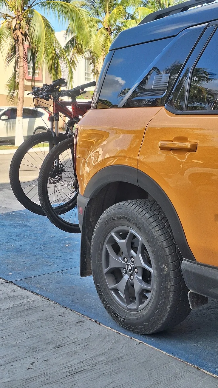

I don't have back parking sensors on my Maverick but I do have them on my BS Badlands, and I do bike, I disabled the sensors on the Multimedia screen system
