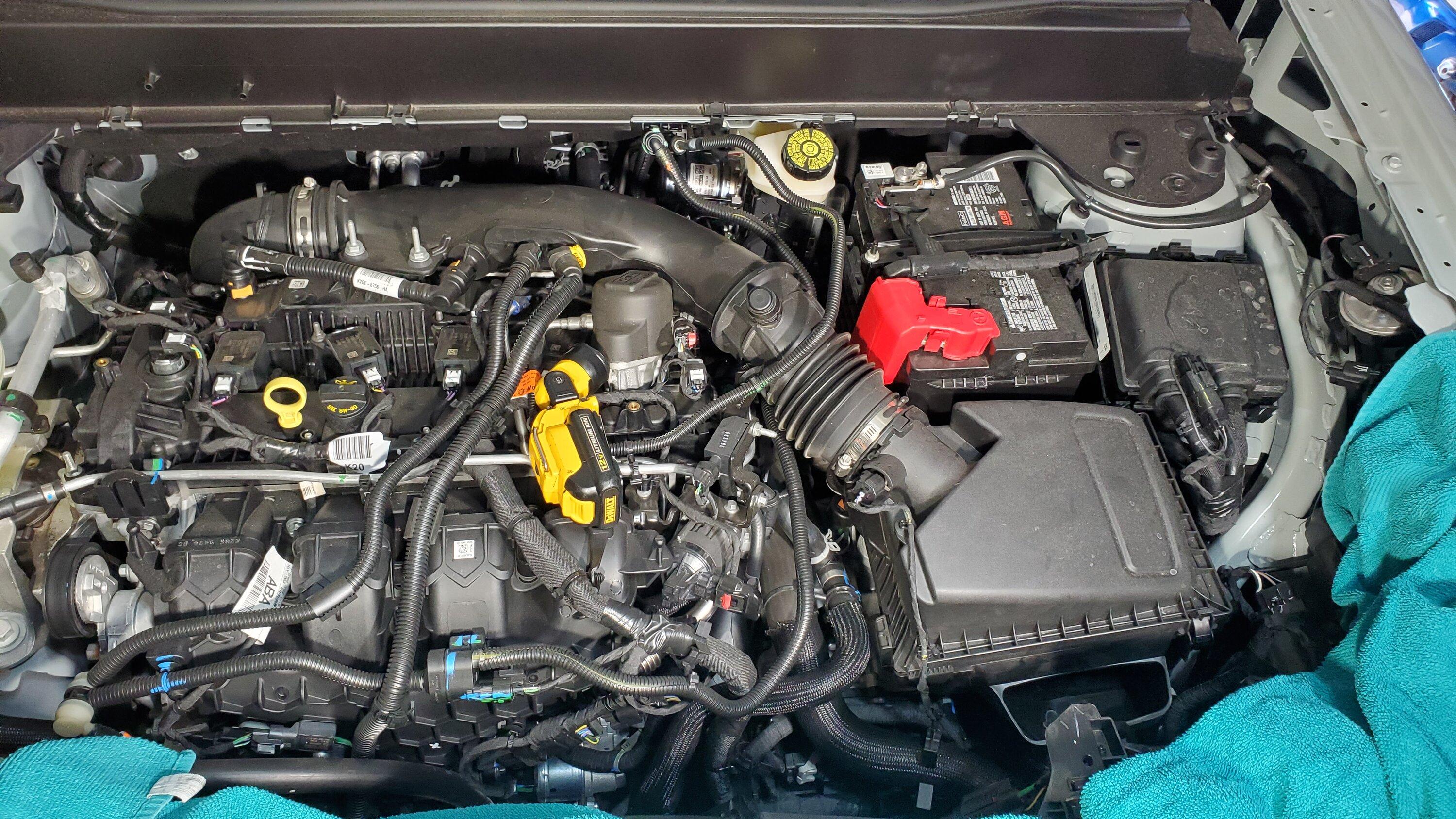

I'm trying to find the dirty side hose to install an oil catch can. I've removed the cold air intake tube, and I've searched around looking for the PCV to throttle body hose, but I can't for the life of me find it.
Here's a photo of the engine bay with cold air tube removed.

Can someone here point me in the right direction?

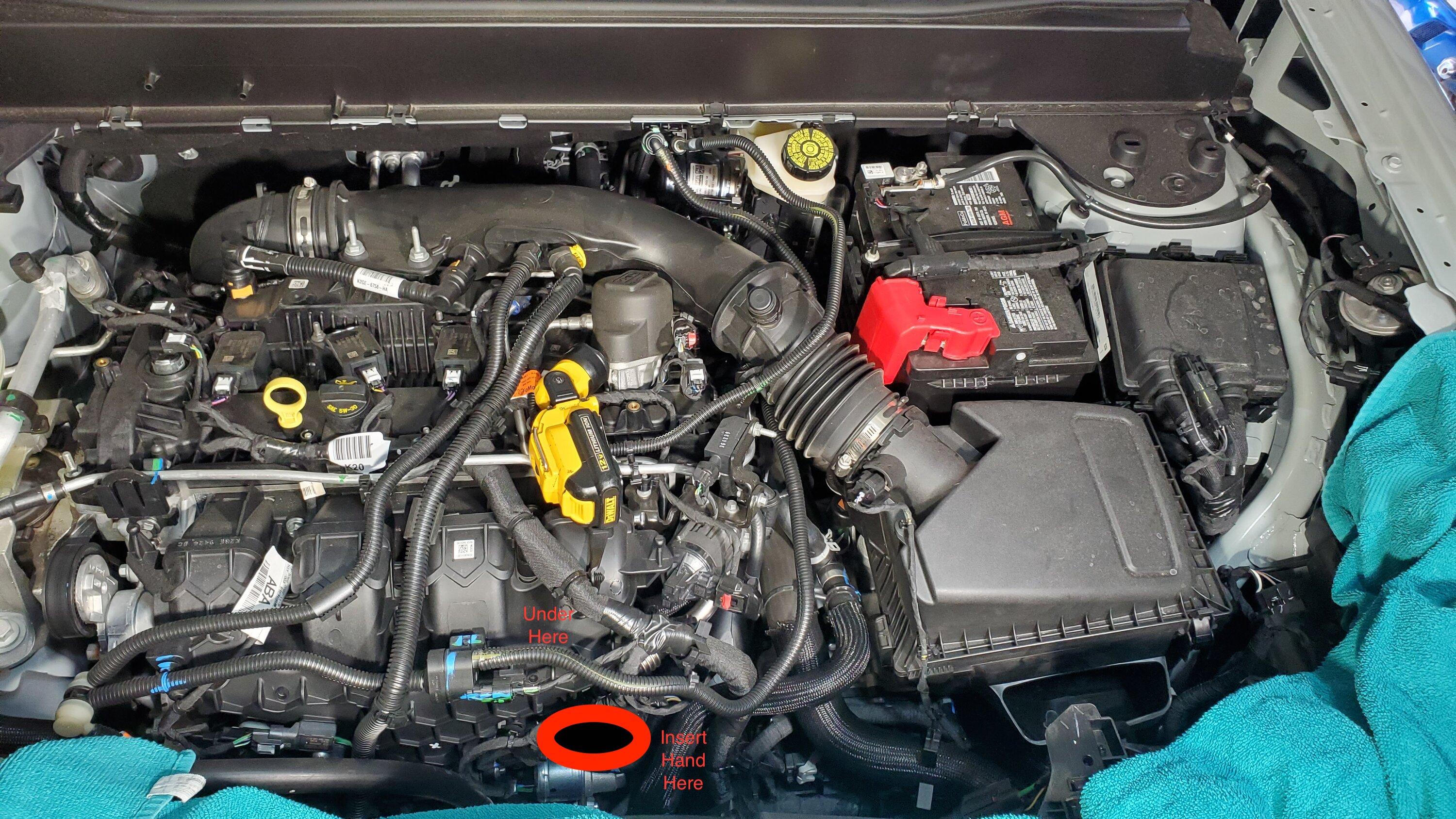

You will need to insert your hand where I marked below and then it will be up and slightly to your left.
Ford Maverick Did they move the PCV on the '23s? PCV
You will feel the rigid hose and will need to press the clip as you pull it off of each elbow. BE CAREFUL because the clips break easy. If you break the clip, you will have to get a replacement hose at a Ford Dealership or buy Ford OEM replacement elbow quick connects on Ebay. Ask me how I know...:ROFLMAO:. See this video about the clips (aka Tabs)

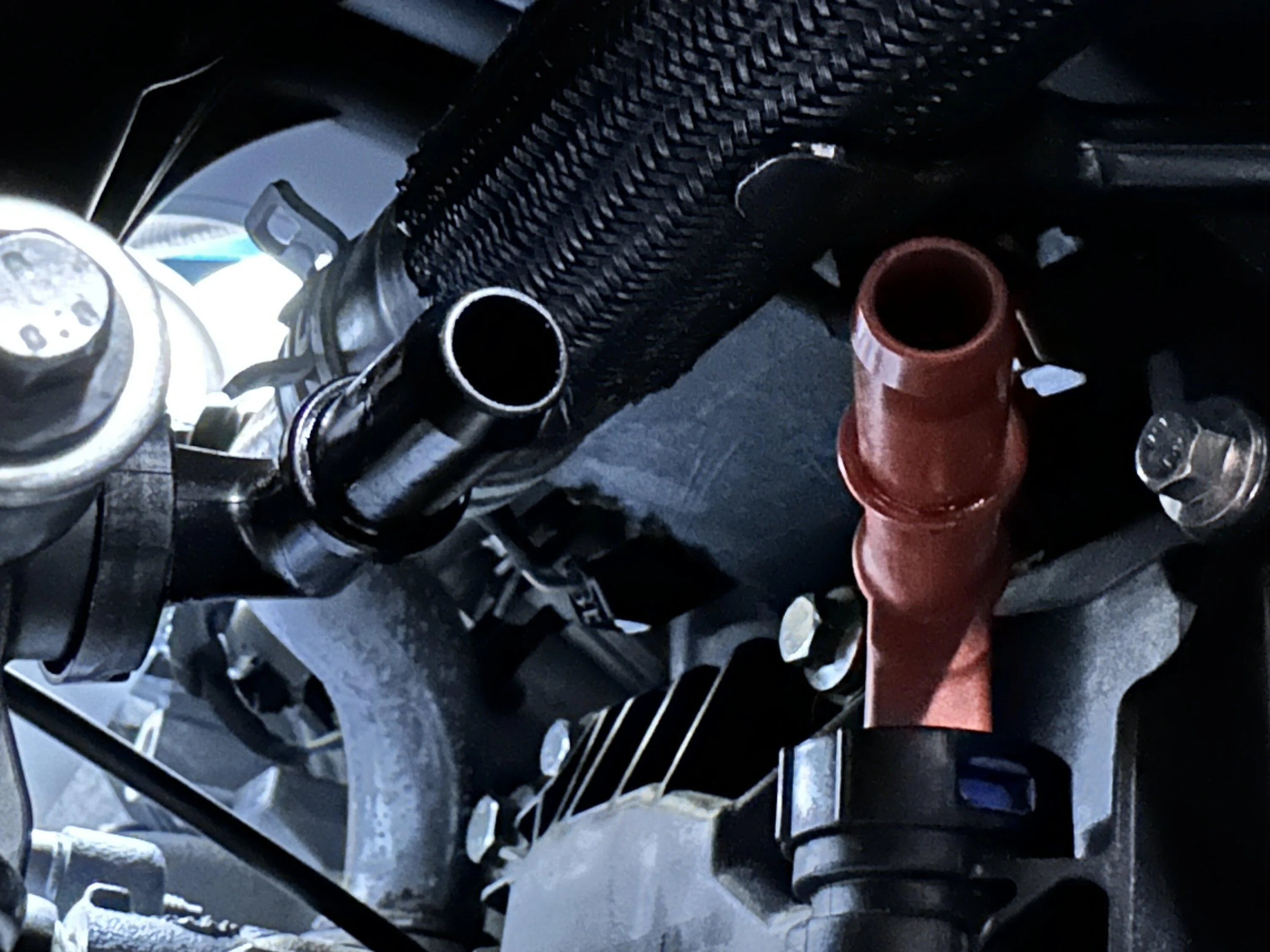

I am also including a pic of when the hose is off. The Orange connector goes to your PCV and the Black connector goes to your Intake manifold.

I had a hard time finding it too. I was reaching too low, it’s higher up than you’d think. Try sticking your phone down there and taking a video, should give you a better idea of where it is.
Thanks so much for your help! This was very useful guidance. And that's a great pic of those ports. I tried getting some shots of my own, but none turned out quite so clear and bright.
