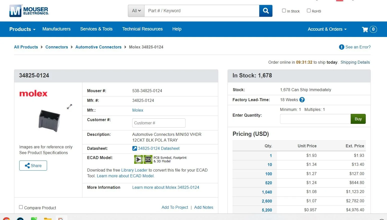

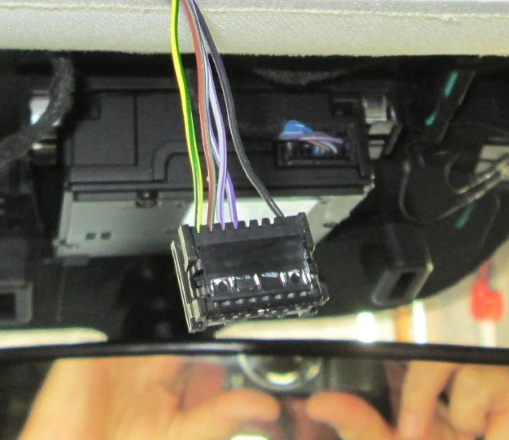

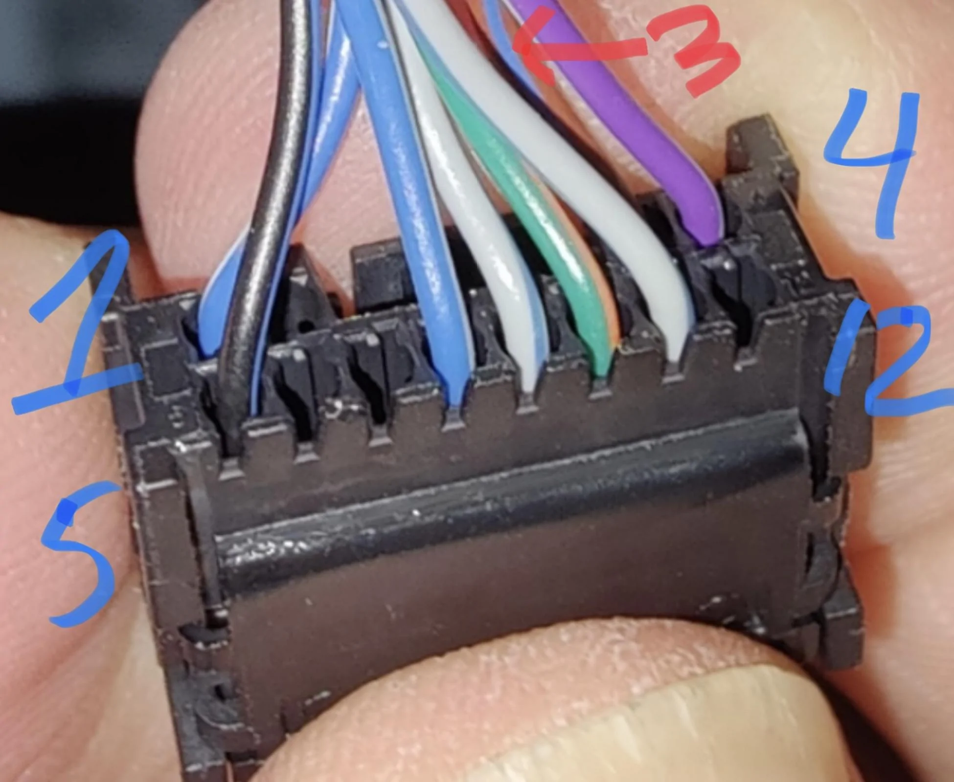

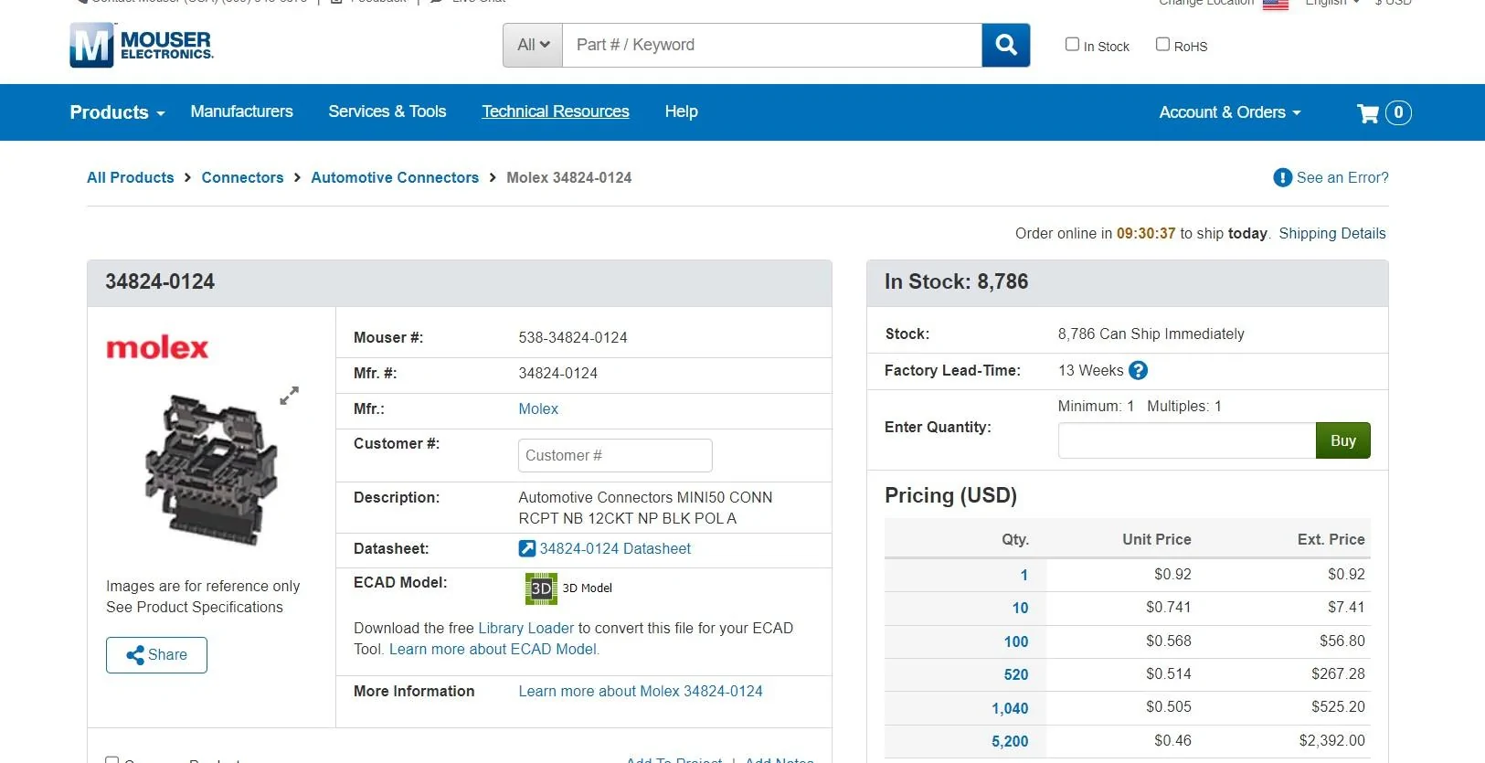

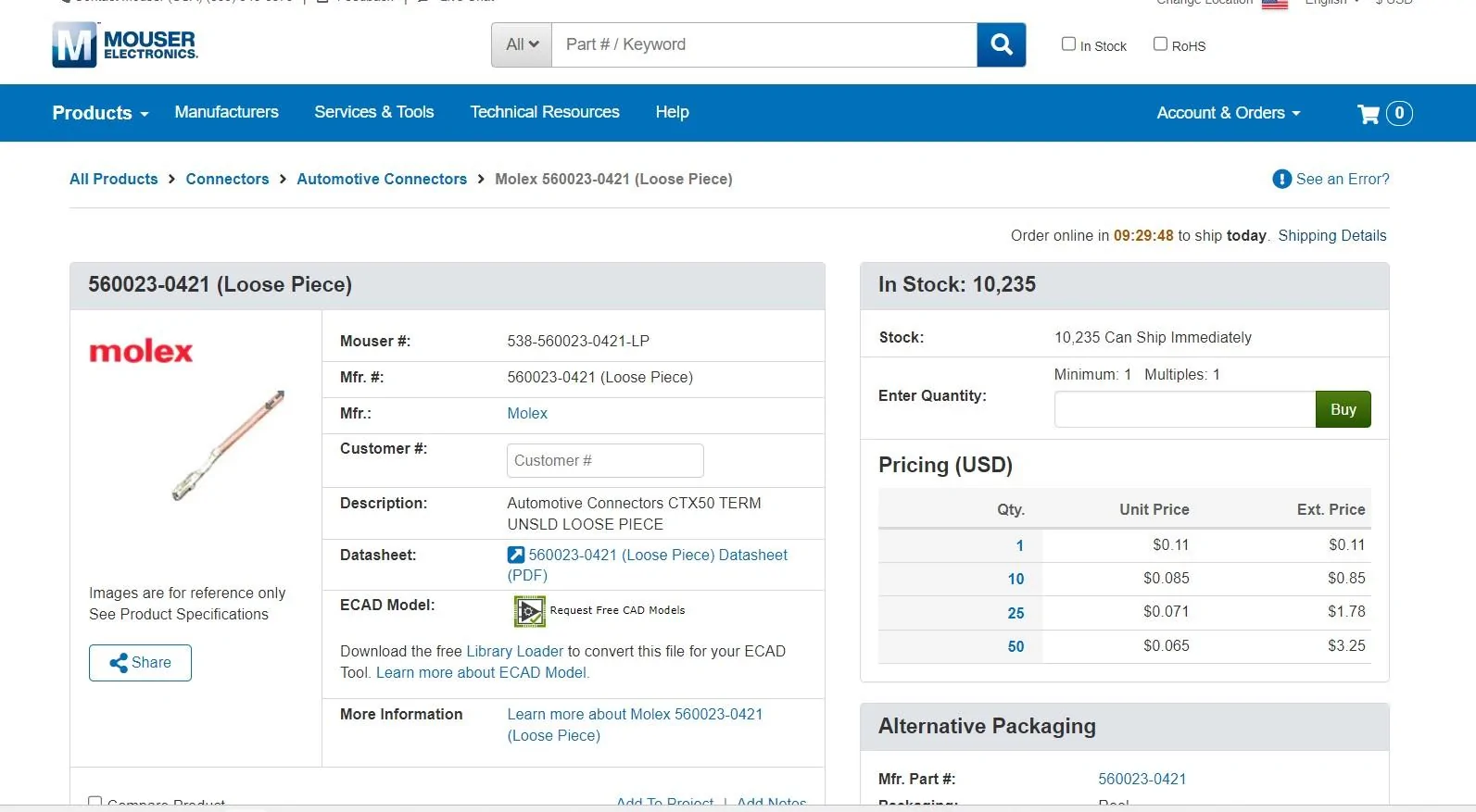

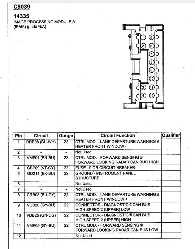

Yup. Not for the faint of heart to wire, but there is a 12 pin connector to the assist camera. Get a plug, a new socket and 8- 22 ga wires and affix your 12 volt socket or a 5 volt buck converter to pins 4 (power) and pin 5 (ground). I have dashcams for both my Mavericks and my 2020 Transit connected this way with patch cords. The Mavericks also have the Kia mirrors wired from this socket. You should be able to find the part numbers here with a search.

Just to clarify... You are saying the purple wire (4) in 12VDC hot, and the black (5) is ground. Is that correct. Don't understand about needing a plug, new socket, and wire.... I would just use a crimp on tap connector.

Don't tap into the camera wiring, you can cause some issues. If you gotta tap into the overhead light connector instead. If you're even more handy just make a pass through plug that you can wire into instead.

I already did this to power the auto dimming mirror. Do you think I can split it again and also power a dashcam or is that too much..?
Not too much. My dashcam and mirror run off of the patchcord I made, so as to not cut into the wiring. Afterall this time, I'd probably just tap into the wires if I had to do it again. ZERO issues. Just be sure you use the right voltage for your dashcam. My 2024 Maverick was a 12v dashcam, and my 2023 uses a "buck converter" to produce 5v as it is a 5V dashcam. I made the same patchcord for my 2020 Transit, but just for its dashcam/rear cam combo unit.
