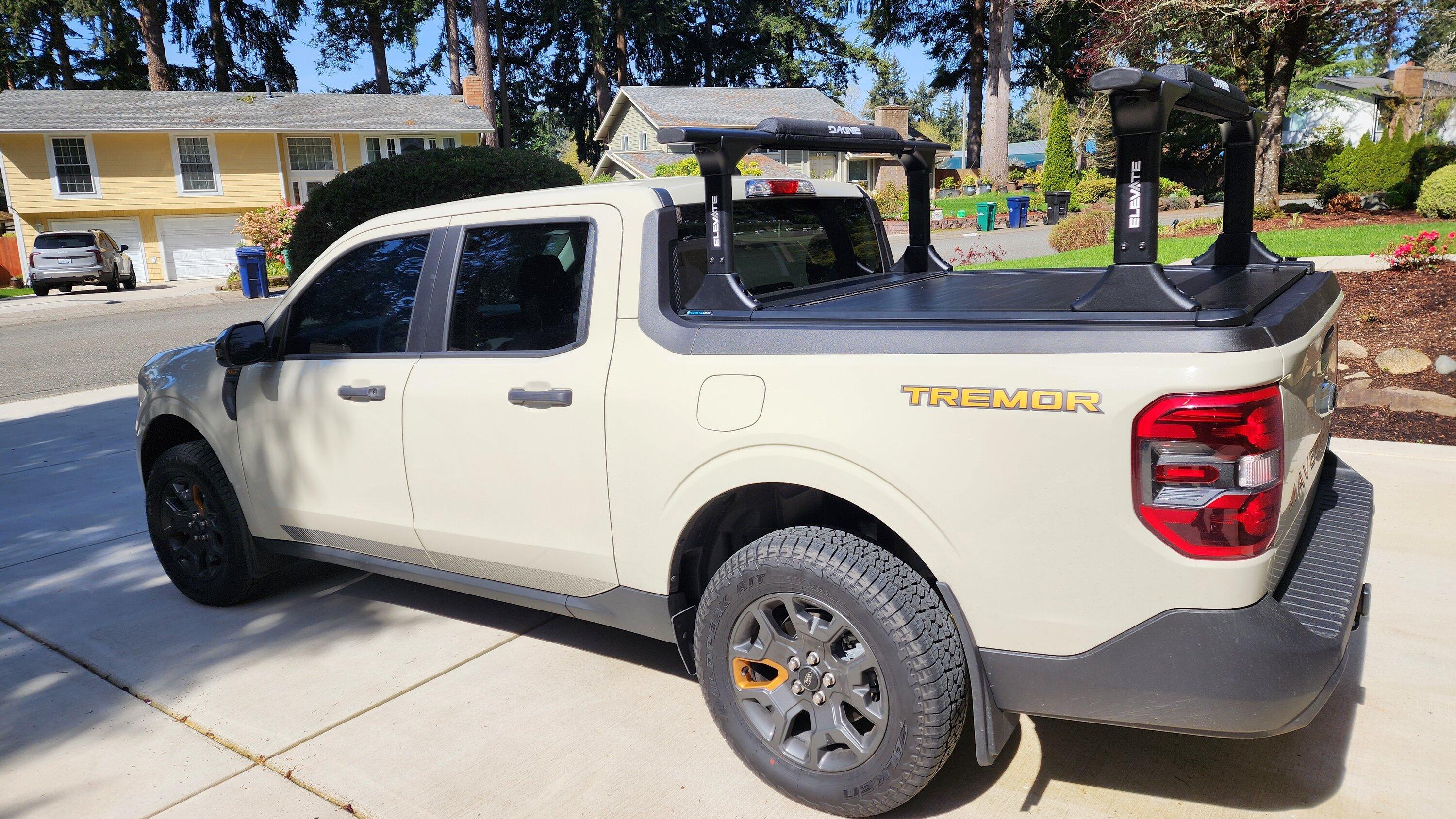

I'm loving my Pro Retractable tonneau, a great cover and great value at $891 shipped!
The one shortcoming however was how the canister cover mounts on top of the front of the T-rail tracks. This reduced the max distance between the Truxedo racks, making for a less than ideal cargo carrying surface, and in my view odd looking proportions.
Ford Maverick Custom Install - Truxedo Elevate on Truck2go PRO Retractable Tonneau 20240406_100510

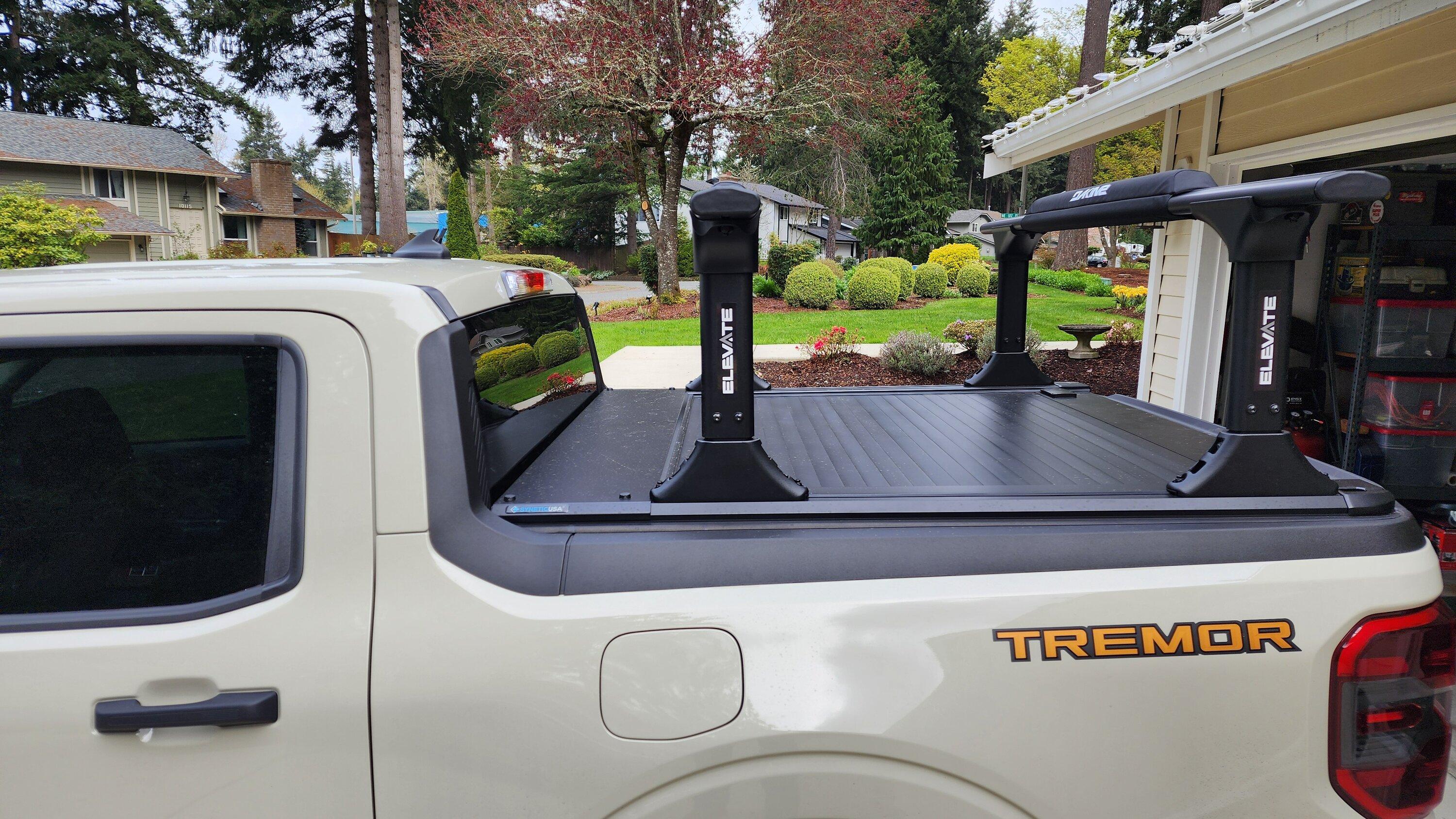

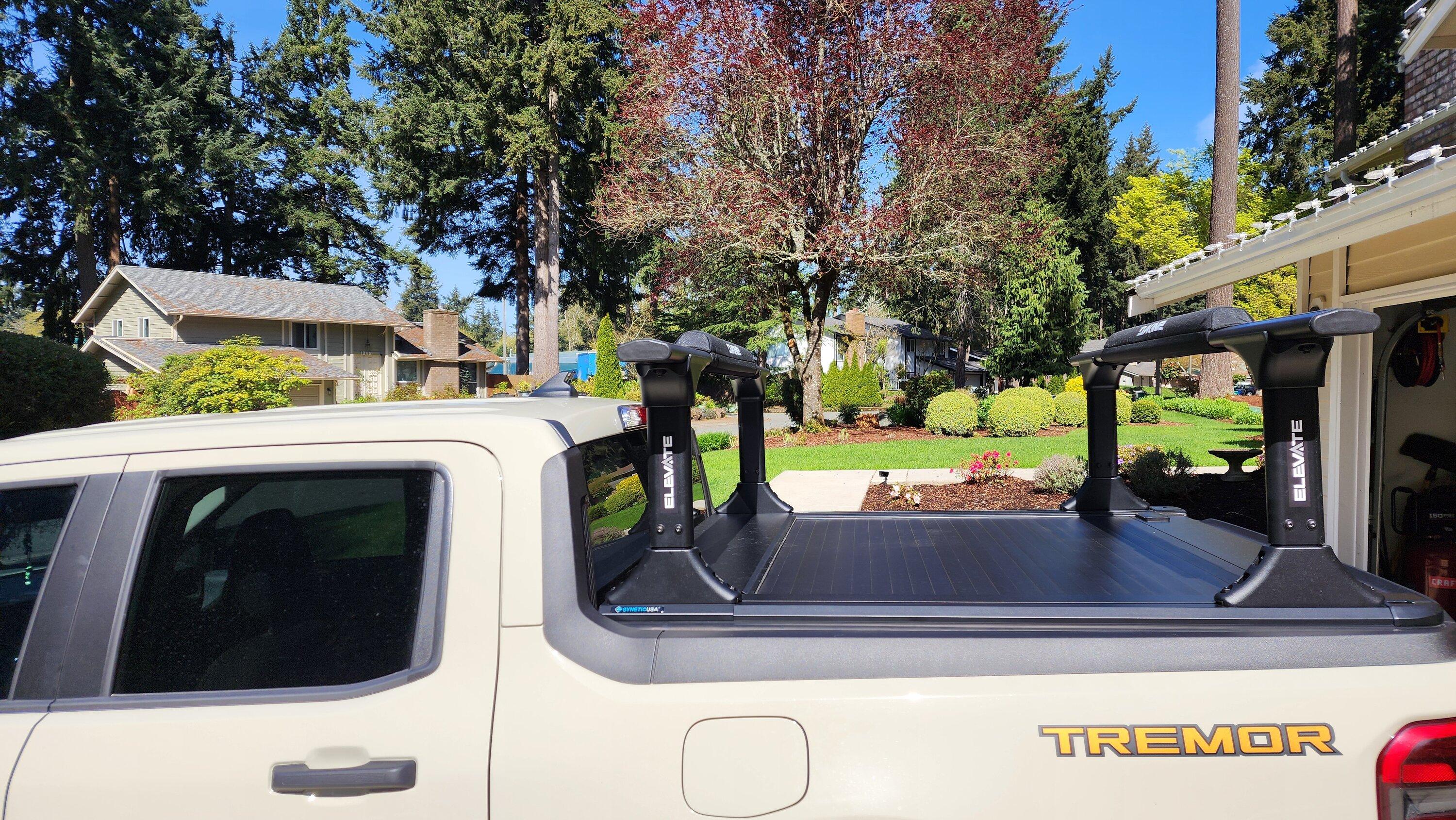

Getting the front rack closer to the cabin was fortunately pretty straightforward - simply drill the cover to accommodate the rack's mounting points.
Ford Maverick Custom Install - Truxedo Elevate on Truck2go PRO Retractable Tonneau 20240410_105410
This consisted of enlarging the existing front mounting hole on the cover, and adding a new hole towards the back.
The most time consuming part of this mod was waiting for the longer T-bolts I had to order from Amazon 😉.
Here's the finished product:
Ford Maverick Custom Install - Truxedo Elevate on Truck2go PRO Retractable Tonneau 20240410_111604
Ford Maverick Custom Install - Truxedo Elevate on Truck2go PRO Retractable Tonneau 20240410_112748

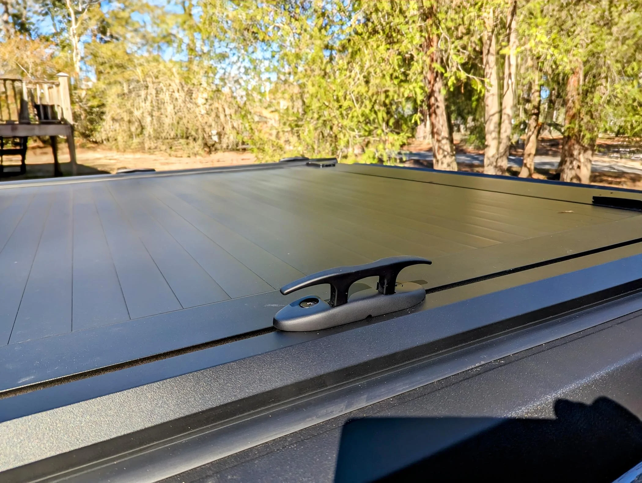

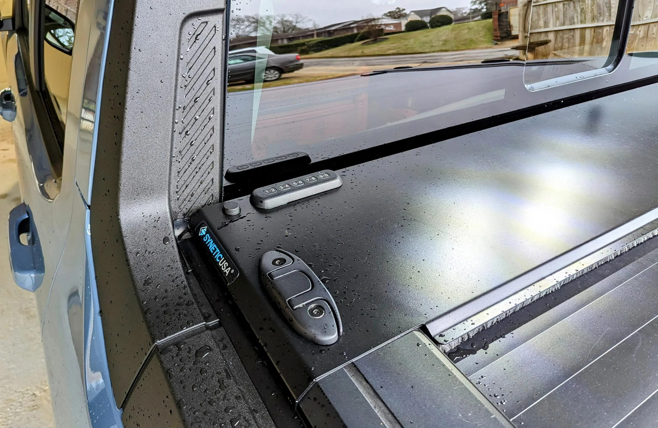

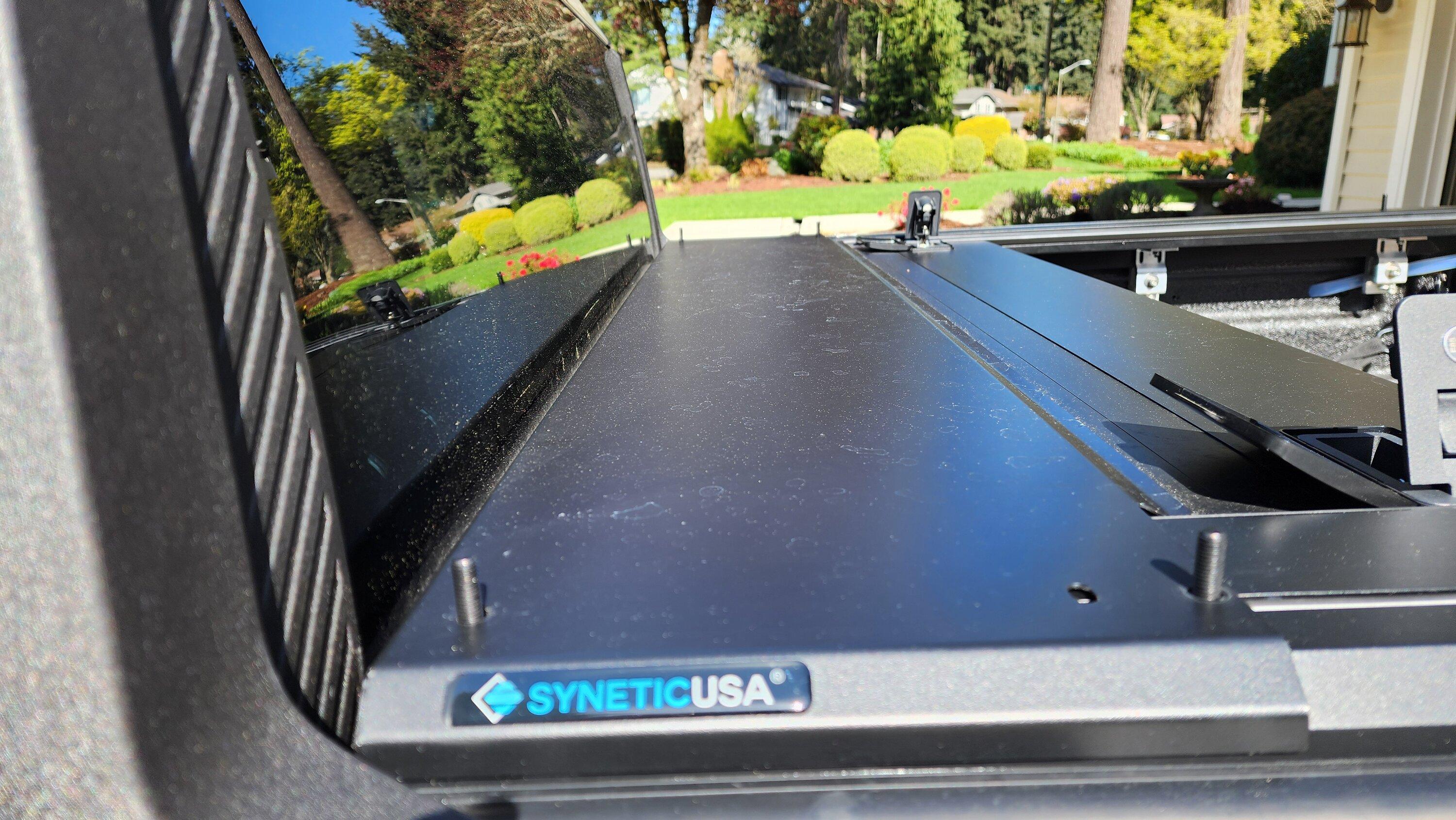

I have the same SyneticUSA/Truck2Go tonneau. Definitely annoying that the coil cover obstructs the T-track.
Previously had two Sport Tracs for 23 years and loved the tie-down cleats on the bed rails. So I was looking for something comparable and settled on folding boat cleats.
I wanted a pair near the cab, so I also drilled an extra hole in the tonneau coil cover.

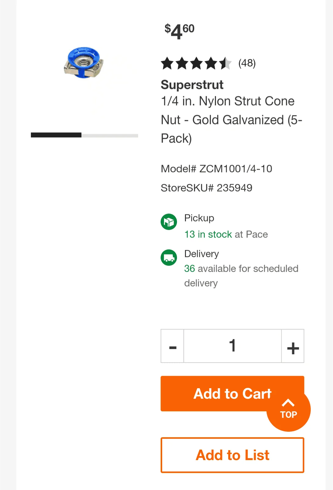

FYI: to anyone that needs T-nuts for these T-slots, electrical unistrut/superstrut "cone nuts" (see photo) fit perfectly. Discard the blue part. They also fit in the inside bed rails that come on the Lariat (but keep the blue plastic part there).

Nicely done getting that upright close to the cab. That Elevate rack looks to be at it's lowest setting and still 3-4 inches above the cab. Would take some cutting to get it lower. What do you haul? Kayak or paddle board would be well off the roof which is what I'm searching for. regards Jeff

I have a long history of hauling an impressive variety of things in modest pickups. With the Maverick I have the shortest box I have ever had which is why I added the rack. Kayak hauling is just one of my use cases which I know will work out well. Time will tell how happy I am with the Maverick for hauling, but based on what I've seen and read on this Forum I'm pretty confident it will satisfy my needs.
In any case, the Tremor is a blast and I'm loving driving it 👍.
