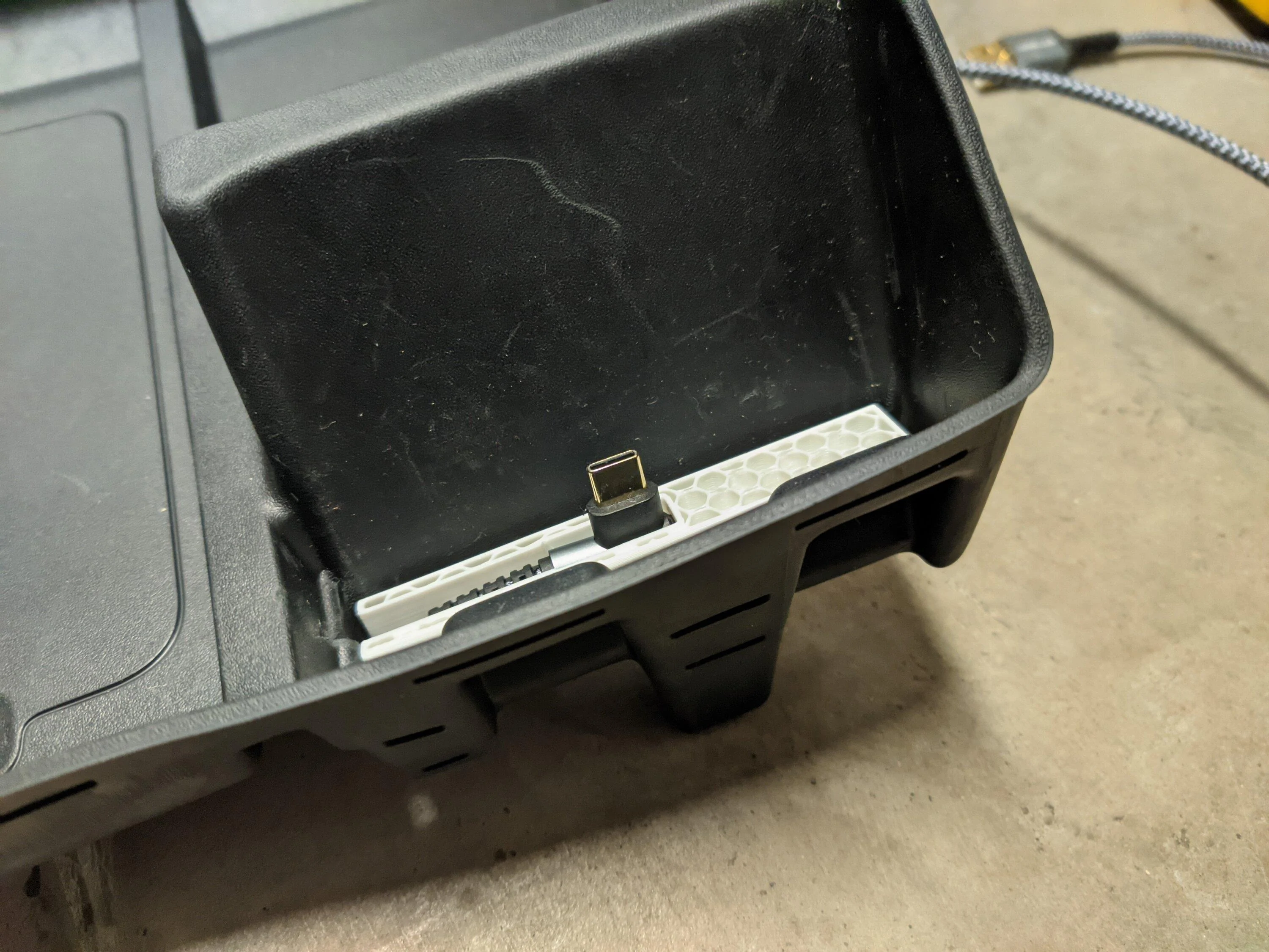

I 3d printed a tiny little holder for a right angle usb c cable and it has been working amazing (ignore the fact that i canceled the print mid way through)
Thank you for this! I printed the file you shared and it worked great with my cable as well. I put foam over the top like you did but it doesn’t look as nice as yours. What type of foam/padding did you use?
SoosKitashi
Ryan
Jan 11, 2023
Maverick XL
I actually used some hat size reducer foam since it was sticky on one size and was the perfect width. I then cut it down to length and punched a hole for the usb. Good luck with your build!
Edit: I also put some carpet tape under the entire rubber tray so it won’t come up when you go to remove your phone. That worked like a charm
