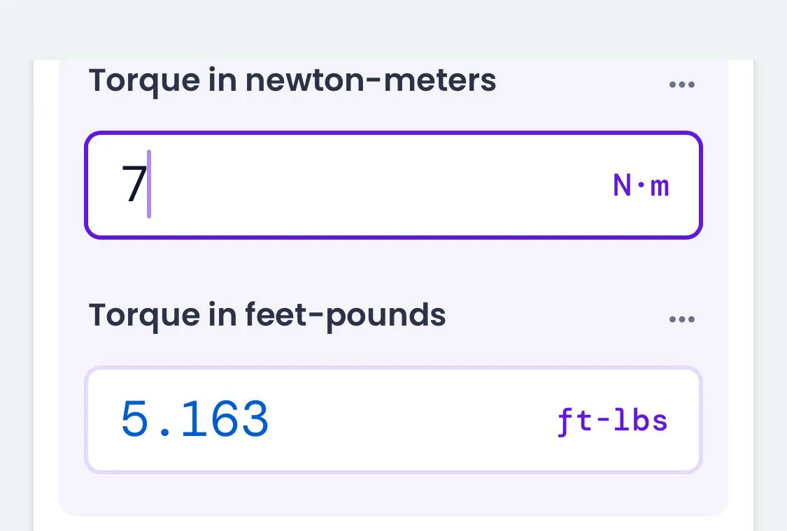

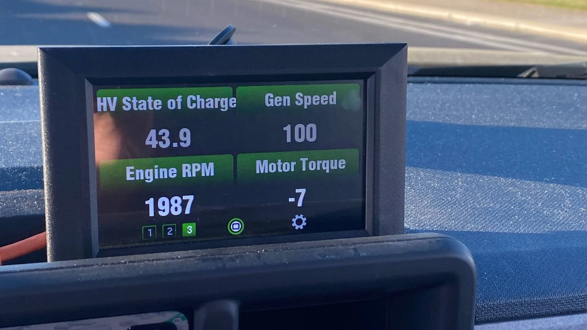

Jack, is -7 motor torque when it's in regen, like going down a hill, or something else?
Yes. Negative torque = regen
It is native in N-m so I have to do mental math to get lb-ft but still fun to have.

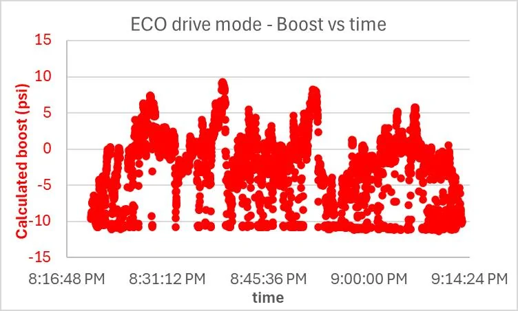

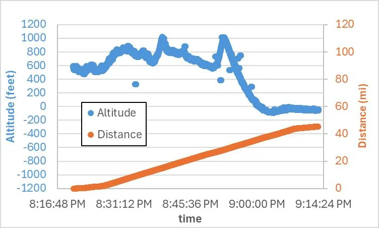

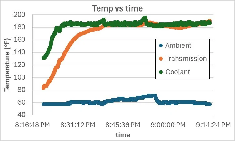

Hope this data helps.
After idling for 5 minutes, for the first few miles while driving home (ECO mode) last night from work at 51 F, my temp gauge was flickering back and forth between 3 and 4 bars and my CarScanner readings were:
  • 3 bars = 177.8 F
  • 4 bars = 179.6 F
