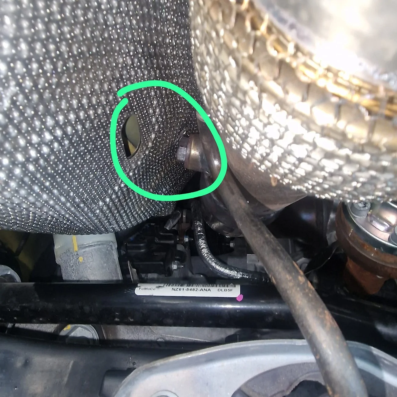

So here is the FM down pipe as installed...there is no room to install the o2 sensor. Panda say they can't tune it without the sensor.... Do you guys have any suggestions?
Probably not any you want to hear but you'll probably have to take it off and have someone weld another O2 sensor bung on it. I just finished switching out my Fast Mavericks catless downpipe for the CVF catted downpipe and it's O2 sensor is in the same spot but rotated down a little bit. I've got to get back under it later and I'll try and get a picture of where it's O2 sensor is.
