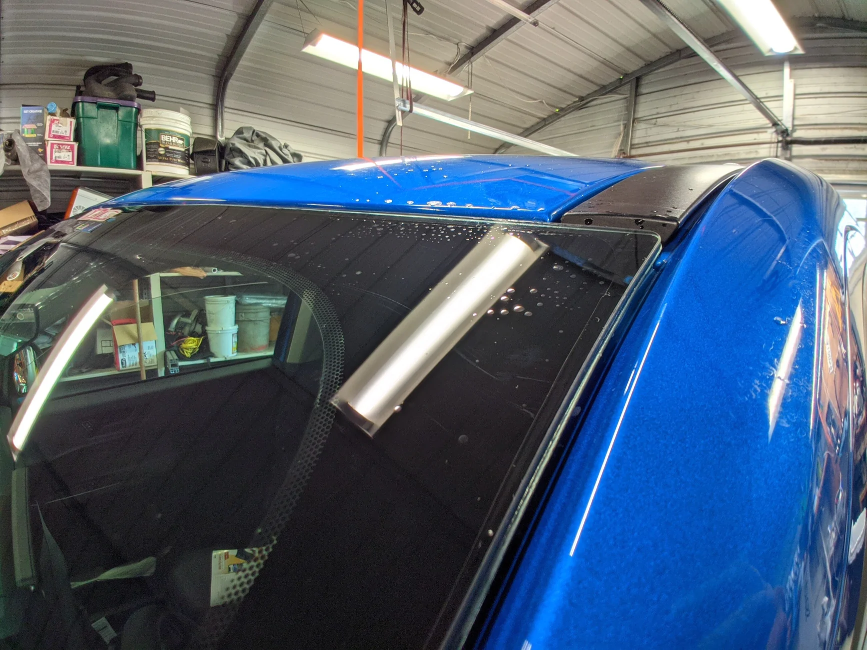

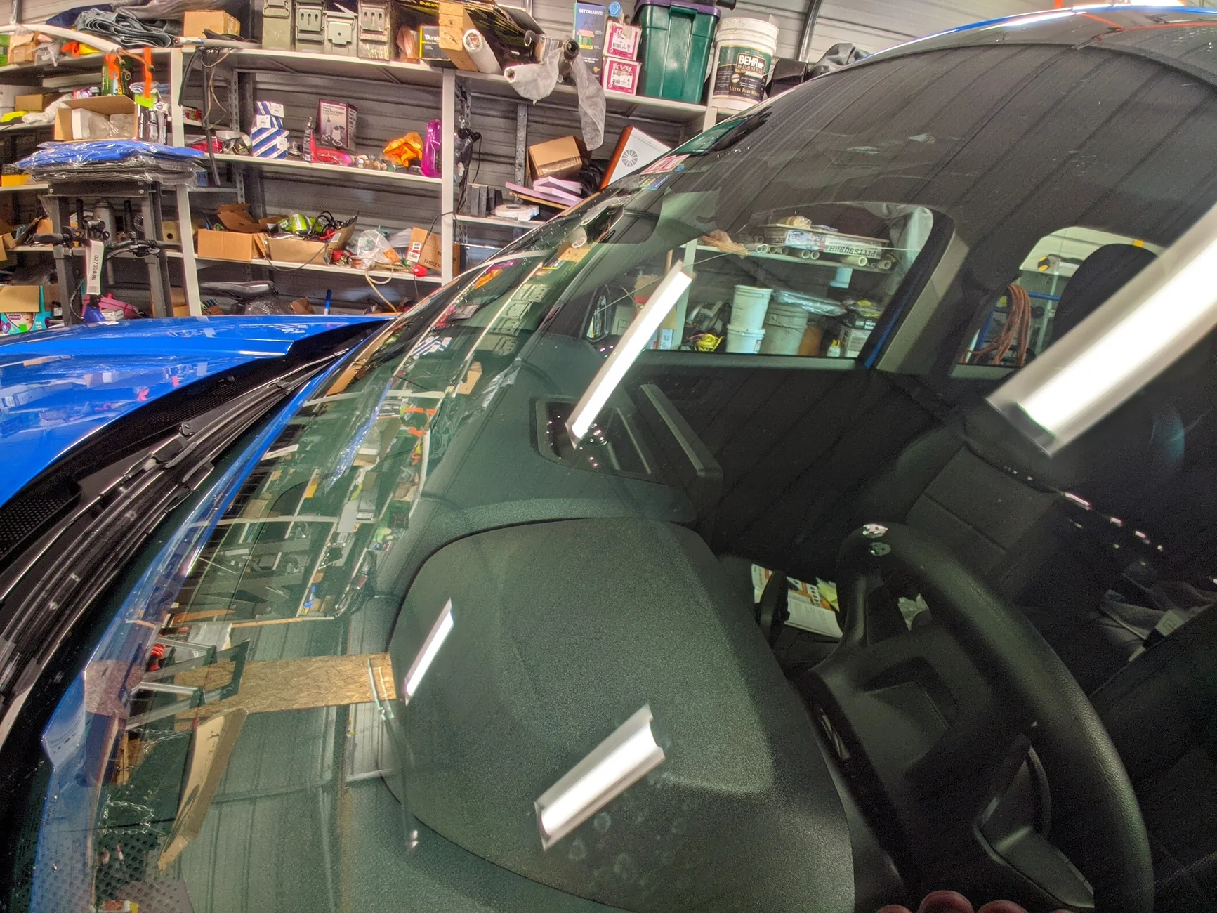

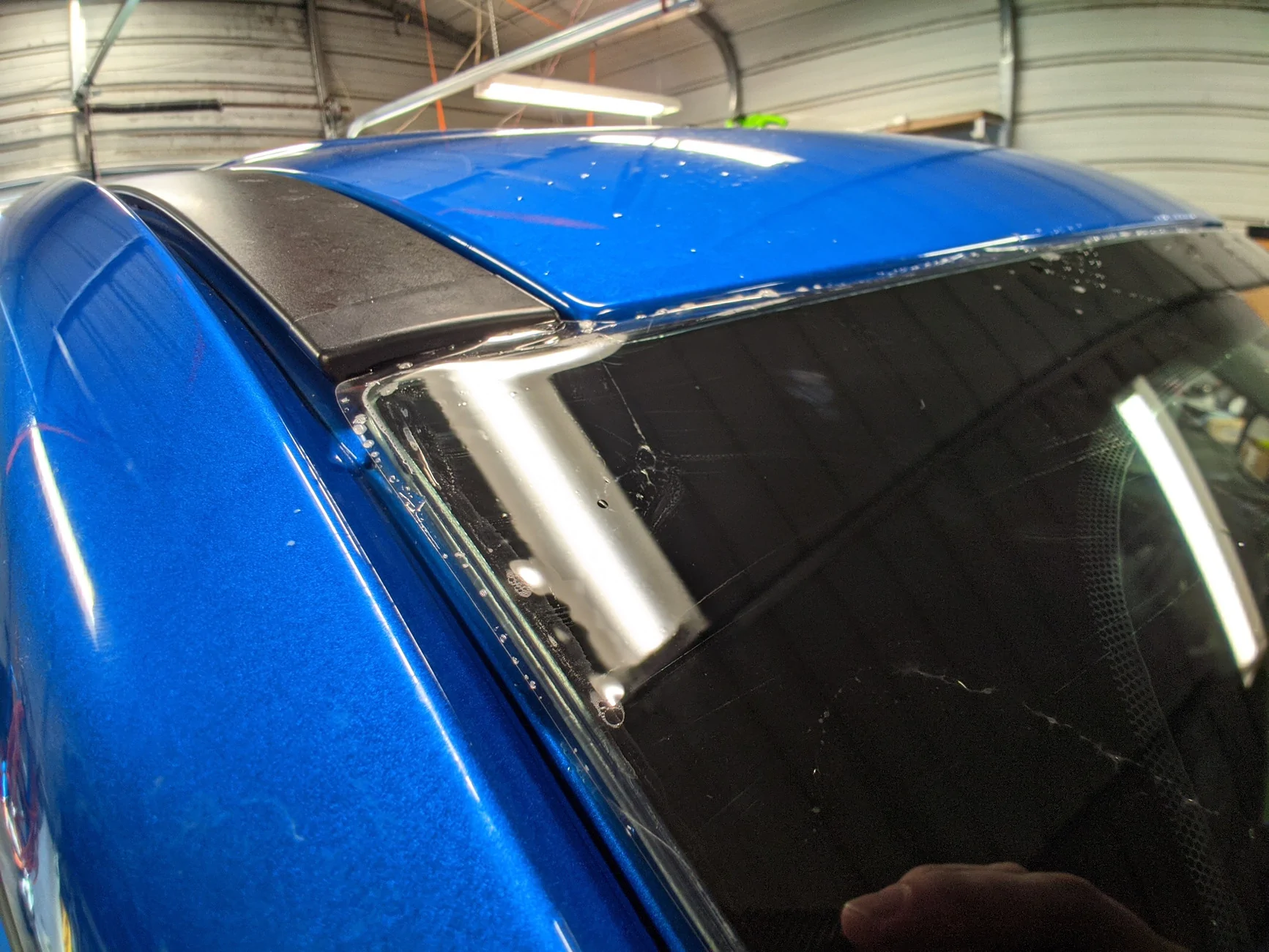

I definitely understand that, but I like learning new skills and being as hands on as possible with my vehicles. It took me about a half-dozen tries before I got really nice results applying my own window tint, but buying a whole roll of tint and doing it myself was still cheaper than going to a shop. And I still have half a roll left.
The big difference with this protective film is you only receive material for a single attempt, and it doesn't behave at all like tint.
As for cost, I saw some quotes online for ~$1400, which made this protector seem worthwhile. If the cost to replacement is actually lower then it definitely doesn't make sense.
An update post-install:
Pros:
  • Rain beads up really well. Starts sheeting off around 40mph.
  • The tears in the film from installation haven't opened back up, they are staying flat and together pretty well.
As for cons, the material is "clear" but not "flat" to look through. It creates a blurred texture and outline to anything you look at through it. Distracting, possibly dangerous. I tried capturing it with a cellphone camera, but the distortion is only really visible to the eye.

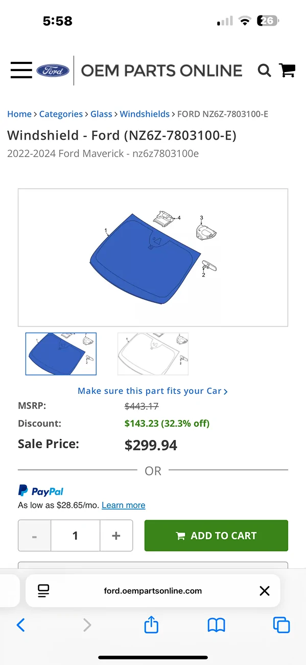

Theres 4 windshields, ending in part numbers E, F, G and H. A cheapXL windshield is $299.
Ford Maverick Cannot recommend Windshield Skin protectors for Mavericks IMG_3847
A lariat acoustic glass with wiper park and all the other bells and whistles is $386
Ford Maverick Cannot recommend Windshield Skin protectors for Mavericks IMG_3848
If you’re getting charged $1,000 for the 1.5 hour R&R time, you’re getting ripped off.
