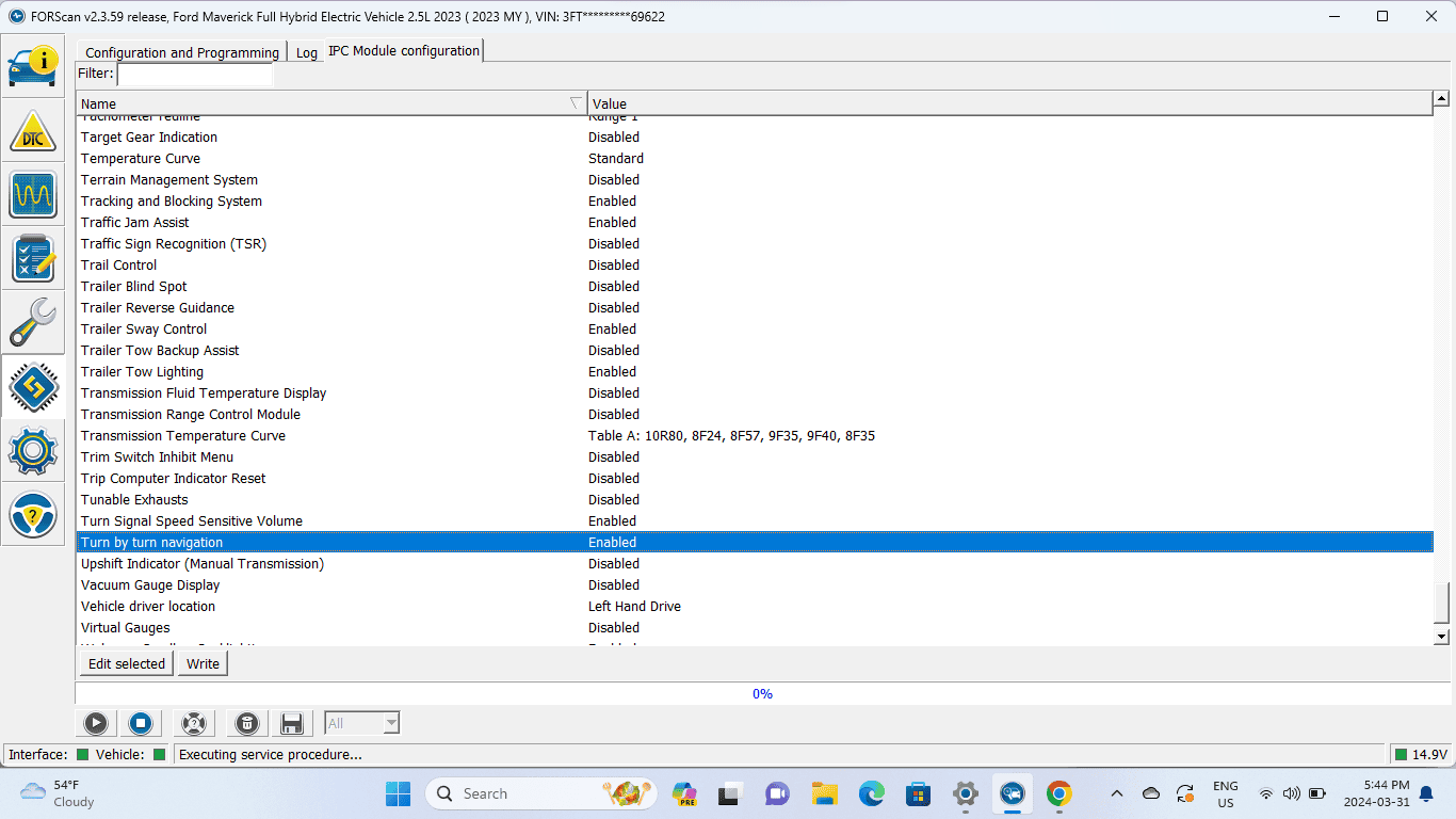

I am curious if you can enable turn by turn nav in your cluster. I was not able to but I thought maybe lariat owners could because the lariat has SYNC.
UPDATE CONFIRMED TO WORK by @TheShark @ryan2366 on 6.5 inch and 12 inch cluster (lariat only).

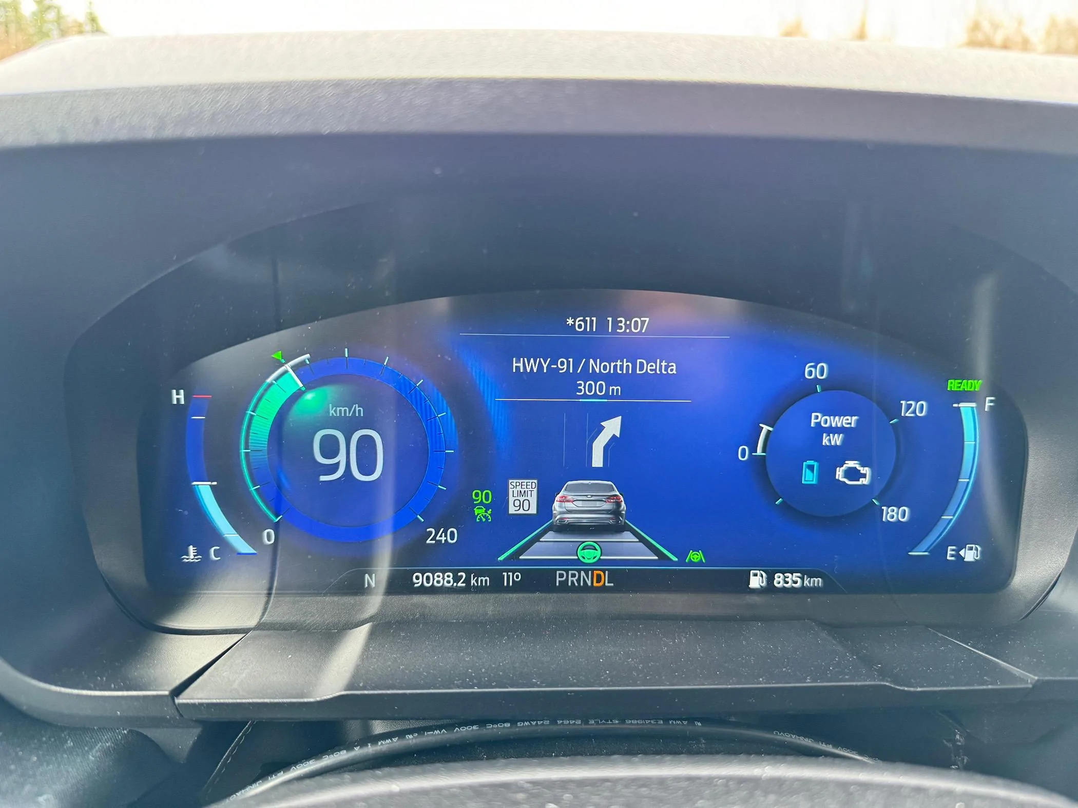

I have turn by turn nav in my cluster. I will have a look in this line.
Ford Maverick Can a Lariat owner test this coding? IMG_1988

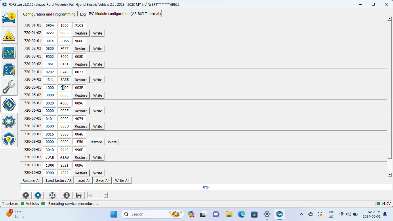

Confirmed although I think I added it through easy mode which changes it in the as built.
Ford Maverick Can a Lariat owner test this coding? Screenshot 2024-03-31 174436
Ford Maverick Can a Lariat owner test this coding? Screenshot 2024-03-31 174038

I have it it's in the upper left corner

Swapped with a salvaged 2020 Escape hybrid cluster (Several threads on how to do it).
I had this working on the stock Lariat cluster before I swapped it out.

Awesome thank you all for the info. great to know this is able to be done through easy mode too!
