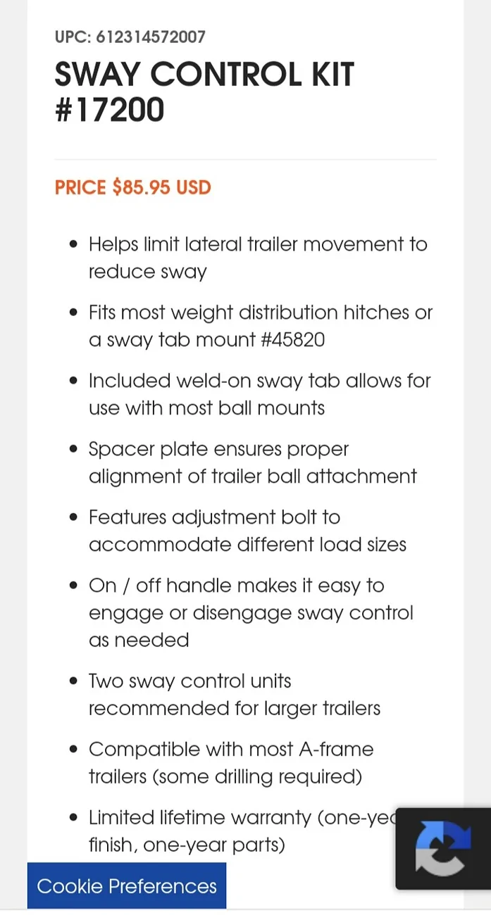

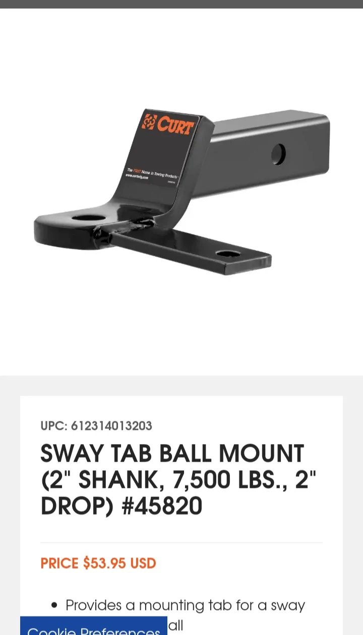

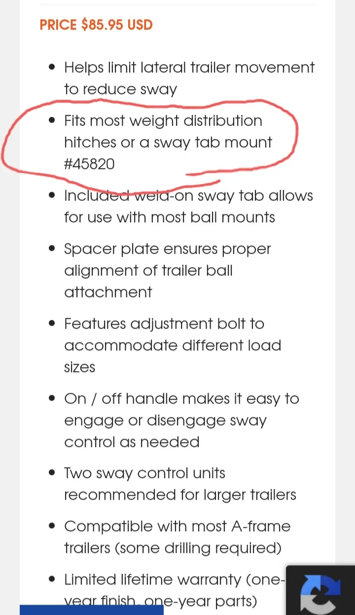

So you have to have a Weight Distribution Hitch in order to attach the curt "sway a way too"?
Can it be used as a standalone product. That can hook right up to your trailer's tongue, without a WDH?
I have a WDH but didn't want to open that can of worms here ... but as it says in the image above, you don't need one to use the sway control kit :
"... or a sway tab mount 45820"
https://www.curtmfg.com/part/45820

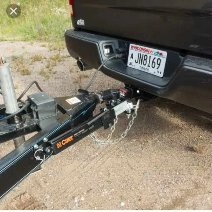

Keeping sway in check without a weight distribution hitch.
With a Curt anti-sway kit.
A Weight Distribution Hitch is Not needed.👍
Buy one of these.👇
Ford Maverick Camper Swaying Over 50mph 20260613_084223
Attach one of these 👇 to the tongue of your trailer.
Ford Maverick Camper Swaying Over 50mph 20260613_084614
Ford Maverick Camper Swaying Over 50mph 20260613_084701
